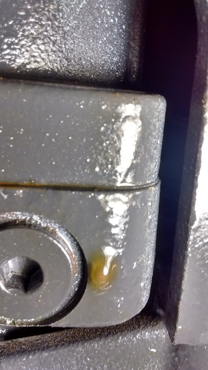

This thread is an attempt to aggregate issues with Kioti axle leaks after my experiences and after reading/hearing of others having issues as well.
In the Fall of 2016 I purchased my NX5510. Late summer of 2017, as I was doing the 200hr service, I noticed that the rear axle, right side, was leaking. The dealer resealed that side PLUS the left side: I'm still looking to get full documentation on their work (they verbally told me they resealed both sides but I don't really have it in writing). Here's the right side:
This past August, at around 300 hrs, I noticed that the left side rear axle was now showing signs of leaking. I notified the dealer right away so that I was on their radar: had work to do and I know that they're busy, so no hurry. Tractor is now there awaiting repairs (no word on how this is/will be approached- also having them look at the left cab door issues). Currently have roughly 326 hrs on the tractor.
Hard to say that if the left side hadn't been touched by the dealer if it wouldn't have developed a leak. I'm guessing that the factory recommended resealing both sides, in which case it would tend to suggest that they're aware of some problem here: I'd think that repairs such as this wouldn't be taken lightly.
As has been proffered elsewhere (am hoping that I get those folks posting here so that we get a more comprehensive picture of this potential issue), it may be a casting issue.

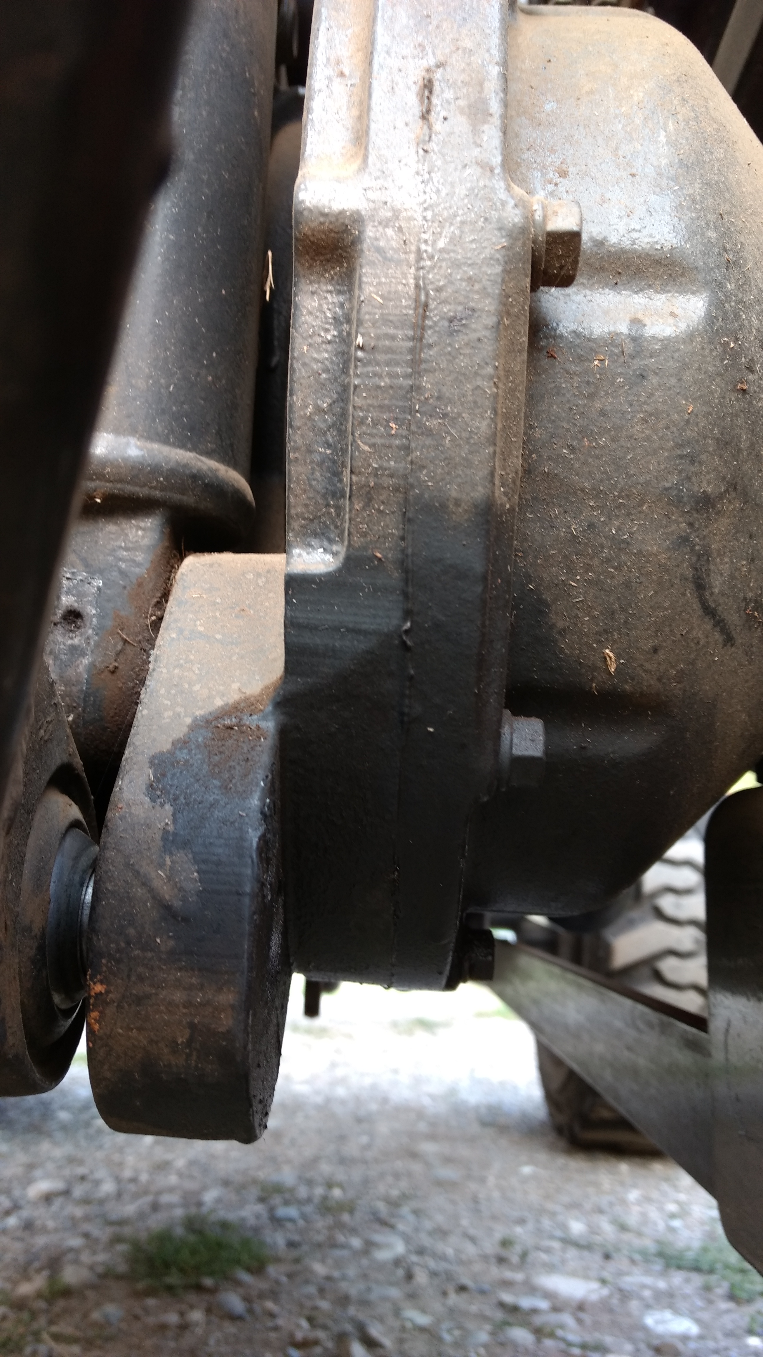

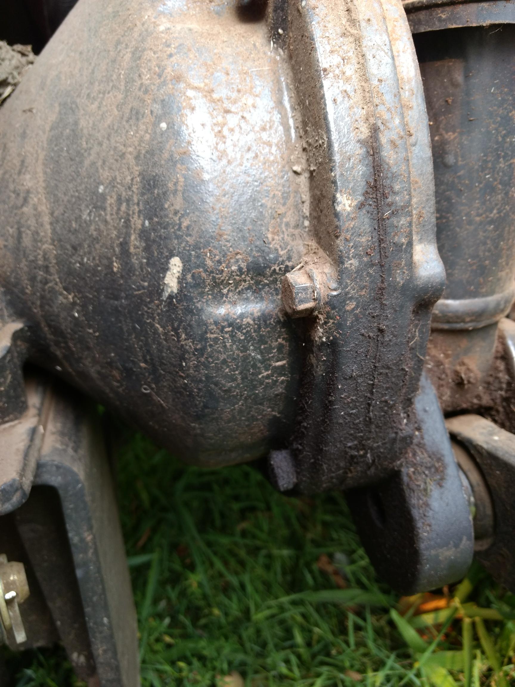

Re: Documenting axle leaks, 4X4 SHAFT CK2610HST 50 HRS
Dealer "said" he has not heard this was a common problem.
Attached is photo of leak after repair. Also pic of new leak that has developed.
Leaks on new equipment one pays so much $$ just drive me nuts!
I am hoping the seal was just installed incorrectly, or there is a burr on shaft, or similar.

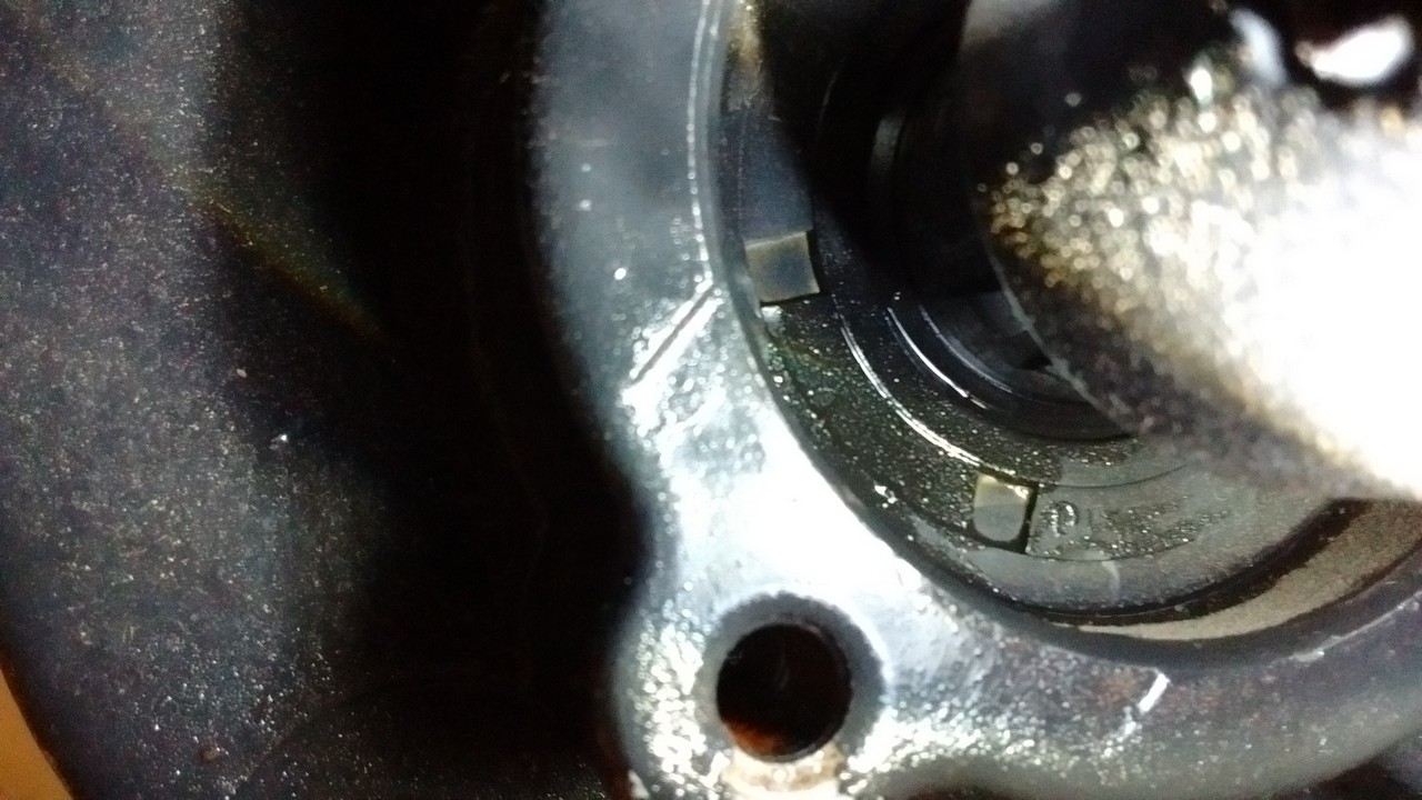

I have a small leak on the front left planetary and the spindle seal looks to be wet too on my 2610. I have 87ish hours on it. I need to contact my dealer to tell them. I will try to get some pictures soon.

UPDATE:
Got my tractor back a couple weeks ago. Dealer, after consultation with the factory/rep, replaced the housings. They monitored for a couple of days and said it was good to go. I've had it sitting for a while now (I busted a tilt cylinder rod- grr) and am going to monitor: just after parking the tractor due to the loader issue I wiped the lower areas of the rear axle housings and felt a little damp/oily- just hoping that it was residual from the dealer.
   / Documenting axle leaks #5
Mines getting fixed under warranty. Just waiting for the parts to come in. It's the hub seal that's leaking on mine.
   / Documenting axle leaks #6
I just got my NX6010 back from having the rear end housing replaced. On reassembly the tech found a bolt for the center section to the outer axle housing had stripped and started leaking. They replaced that bolt but the company is now looking into the hardware possibly being the culprit for many of these axle leaks they have been facing.
