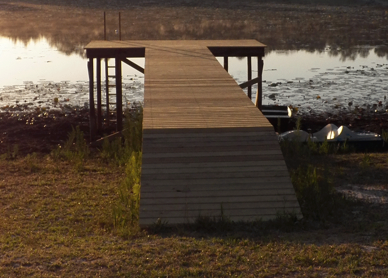

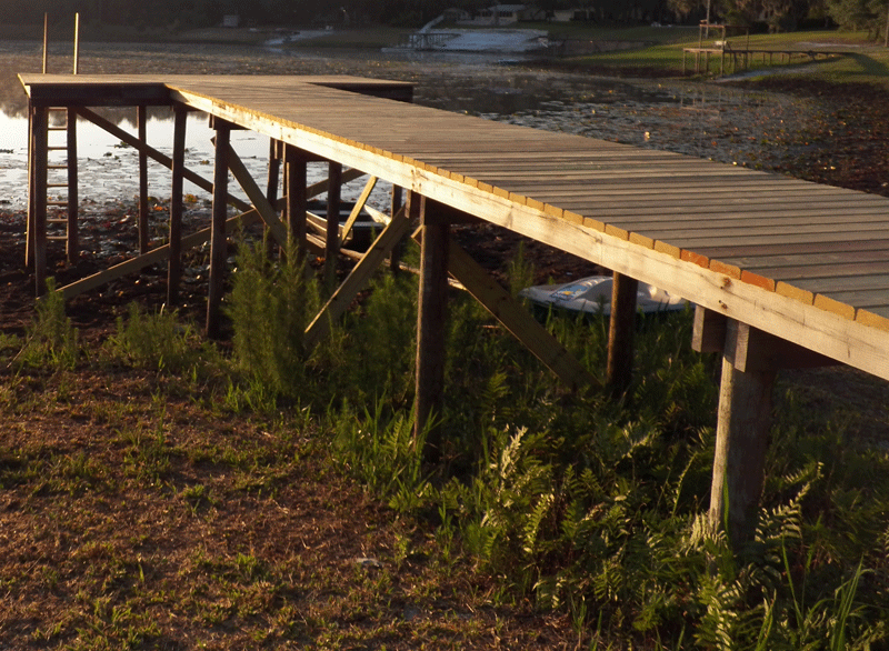

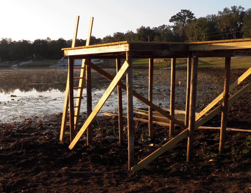

Sorry guys, I should of explained it better. The dock is for my 1 acre pond in my back 40. There is a wood dock now but I wanted to make a better bigger dock. I see lots of wood docks around here.
   / Docks #9
My dock sets on 6" x 6" posts. A friend was doing some work on my bank with an excavator. We cut points on the posts using a chainsaw then drove the posts with the excavator. I cut the tops off the posts after I put up the top band. I should note the water in my pond was really low that year which allowed me to get in the water wearing waders and hold the posts while he drove the posts. The dock has been there for six years and no problems with the posts.
   / Docks #10
I live on a pond / small lake as well (about 1 mi x .5 mi) and here everyone has wooden decking and metal posts. The soil is kind of a soft peat on top of boulders and clay, so you just bang the posts in until you get to something solid to support them, then build the deck on top of it.
