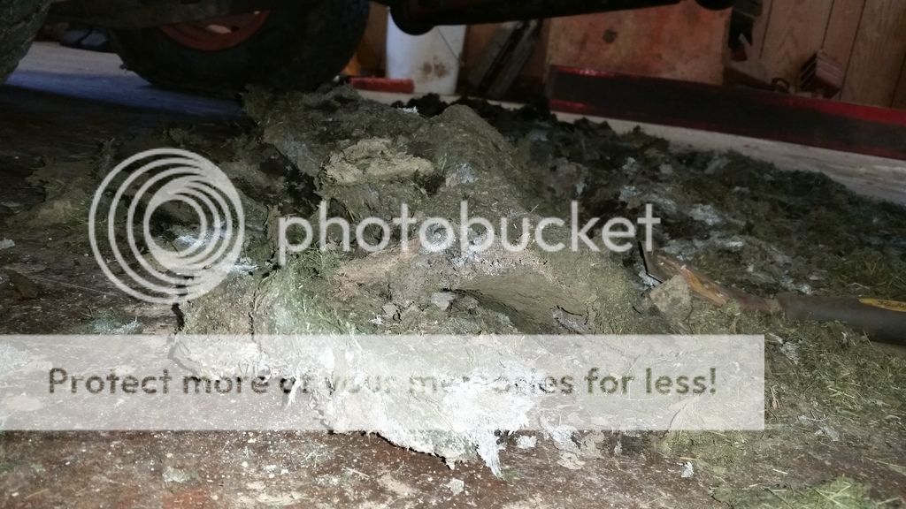

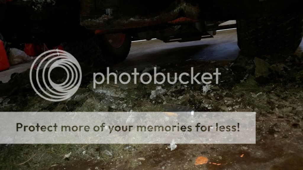

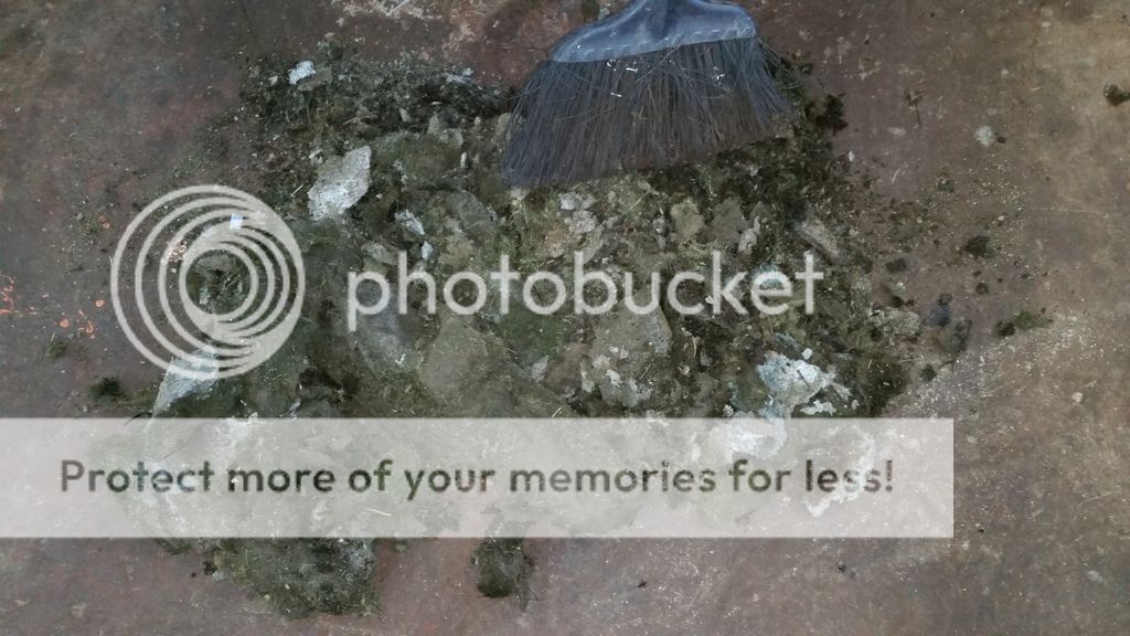

Cleaned the deck of the ZD today and got this pile of grass as a result. This is only since the first of the season (about 14h of use).
Performance is much improved after a cleaning and blade sharpening.
My advise, it sure wont hurt to check and clean the deck mid-season, your mower will thank you for it :D
