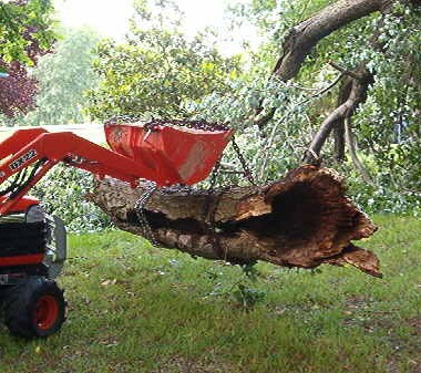

You may be able to see where my hooks are in this pic. I had the shop put mine on top of the bucket in-line with the arms. I think that should be the strongest place when using chains to lift. BTW when I moved that tree limb I had it almost dragging the ground, that height was for the pic which was way to high to go truckin around the yard.

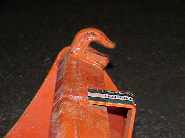

Yep, used some angle iron I had in the scrap (saw the idea here). I put mine just outside the level indicator and equal distance on the other side. I used 5/16 hooks (ordered online).
OOOOOOOOPs, went back and looked after posting this--they are 3/8" hooks, not 5/16s. Sorry. <font color="blue"> </font>

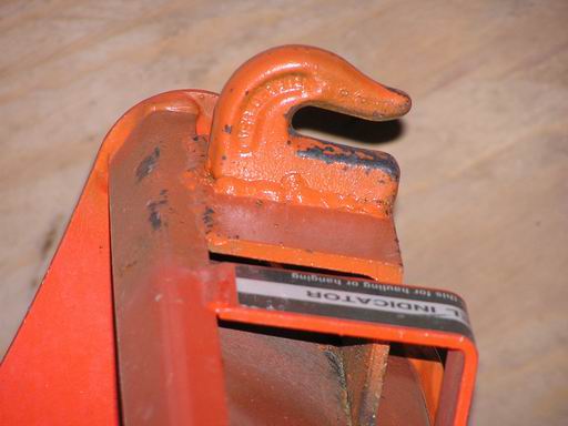

Although I've never had a BX, the loader on the L4310 had the same bucket. You know, the one with the crappiest level indicator I've ever seen on any bucket of any brand. Anyway, I ended up with a setup very similar to RonR. The only difference was that I welded a flat 3/16 flat plate against the back of the bucket after I pulled a pucker in it with just using the angle and the hook. I don't know, perhaps the BX series won't pull as much as the "L" series, but they seem pretty stout from what I've seen. I don't have the tractor anymore so I can't send a pic. However, I've yanked the #*$# out of it and never bent anything after using the flat 4" x 4" plate welded to the back of the bucket where the angle goes against the bucket.
I do have one question though. I've welded dozens of hooks on buckets. I've always run down to my local Rural King store and just bought the standard hooks and used my chop saw to make them flat on the bottom. Where did you guys get the hooks that you didn't have to "fabricate" to make work? They would save me about 1/2 hour per tractor. Besides, I bought one of those really cheap "Russian" made wheels for my DeWalt chop saw and it exploded on me when I was cutting the last hook I was modifying. It left a nice 2" gouge in my right chest when it came apart. Needless to say, I took off what was left and pitched it along with the other 4 "Russian" made wheels I had bought from Harbor Freight for something like "5 for $10". The gash in my plexiglass face cover I was wearing proves that safety equipment is definitely worth using!!

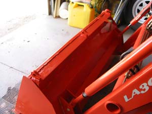

Not a BX, but a B7500 with LA302 loader. Looks like the same design of bucket.
Piece of 3" angle inserted just under top curl of bucket welded every few inches to curl and to bucket. Used full width to spread load over full width of bucket. Hooks are modified with pin loops cut off and bottom flattened. Welded with a 225 amp buzz box, didn't trust the MIG for adequate penetration on this heavy metal.
Hope this is some help.
