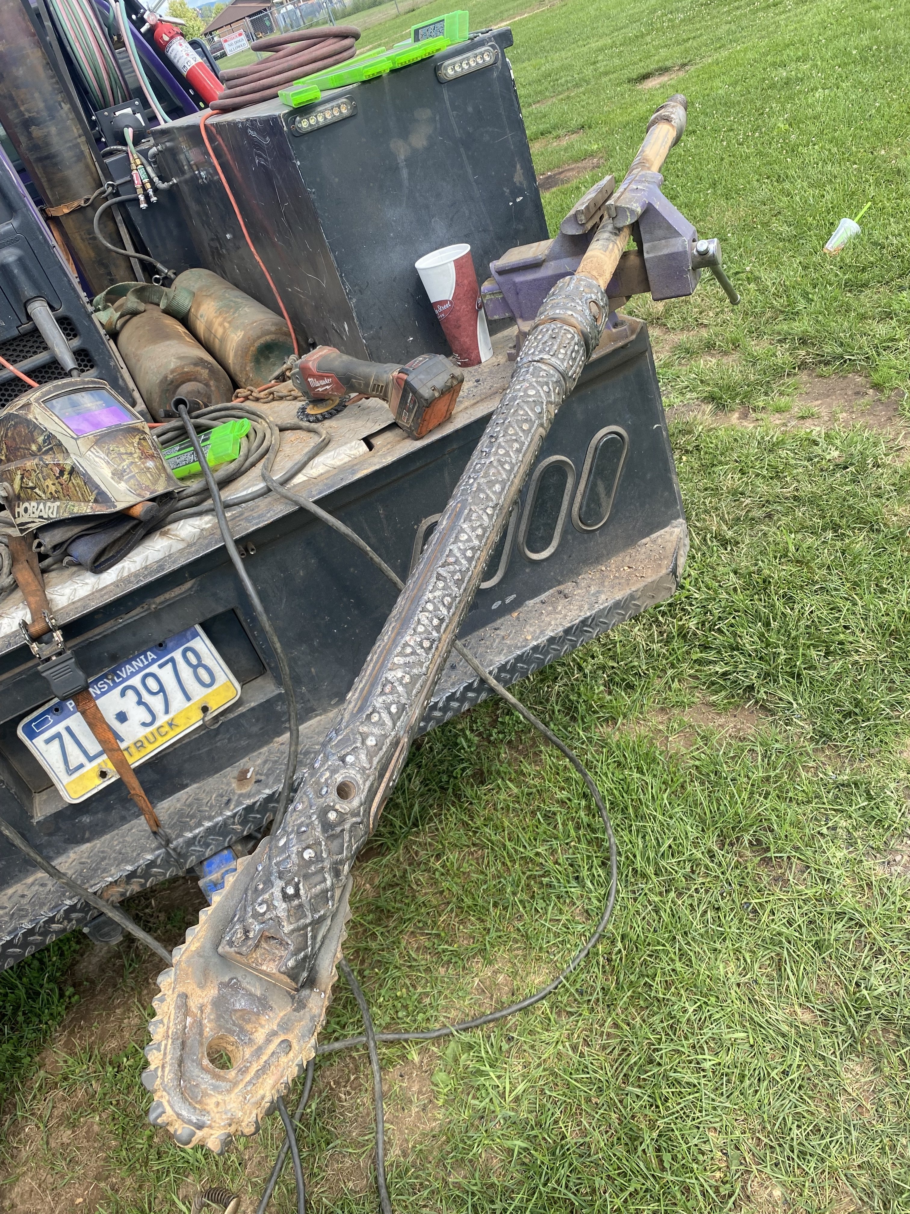

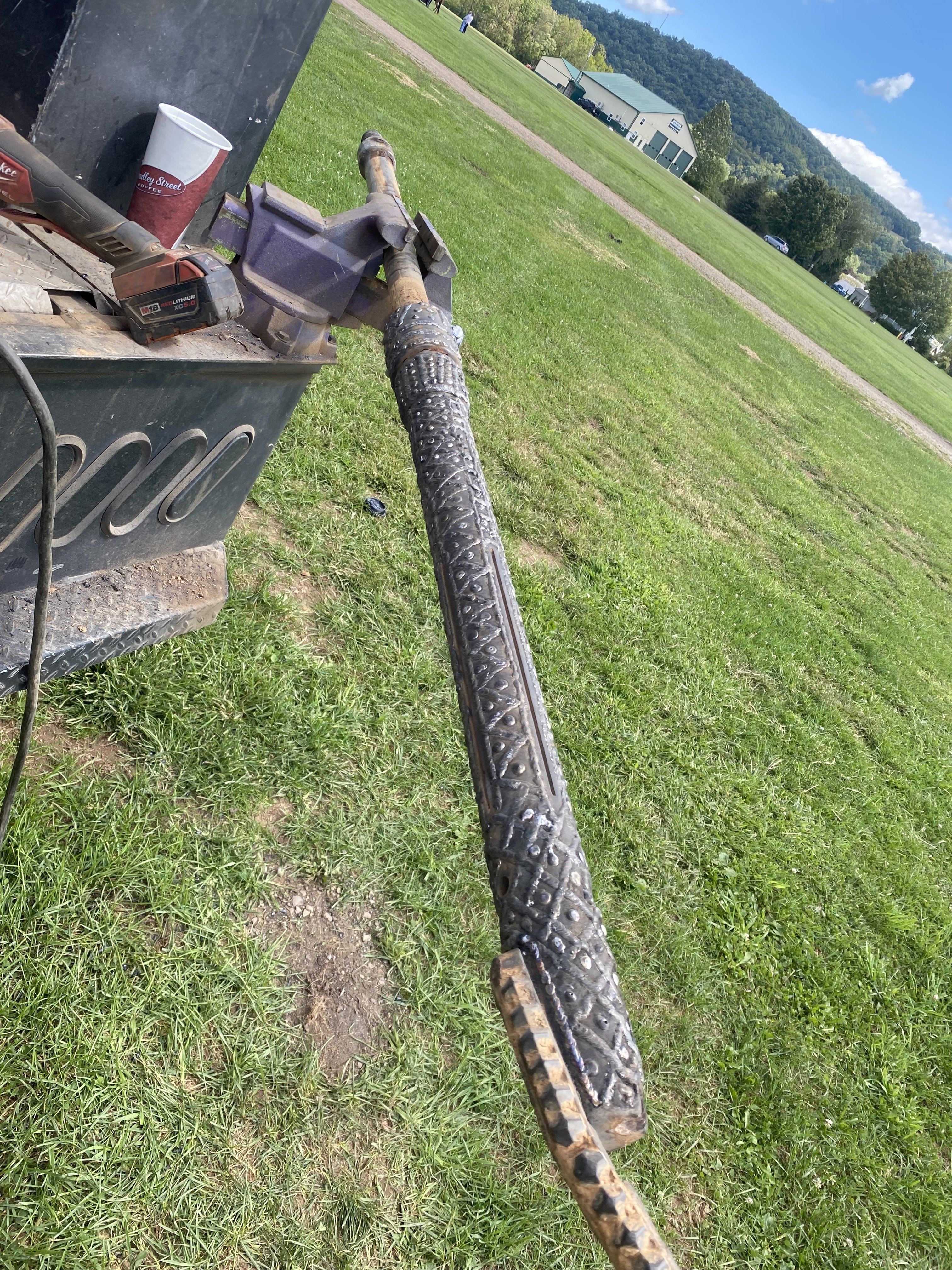

I do, always, Any implement I own, if it has ground contact shoes or skids, they get hardfaced, no exception and that includes my 'brush hog / slasher' as well as my discbine and the bottom feet on my stump grinder, any metal to ground contact gets hard faced. reason is, renewing worn skids today is an expensive ordeal, especially in the case of my discbine where each skid shoe (I have 10 on it), is expensive, like in the 200 dollar range. All 3 of my FEL buckets are also hard faced on the bottom and lower sides as well.
Because I farm on mostly sandy loam, skid wear is fast and hardfacing them slows down or stops that from happening, plus you can build up the hard facing when it gets worn down, for me it's just proactive, common sense.
I hard face in the shop using my high amperage MIG welder and solid core or flux cored hardfacing wire with inert shielding gas. Hardfacing wire isn't a cheap date but in the long run, less expensive than skid shoe replacement, especially on the disc mower. I have also hard faced the leading endes on my rototiller for the same reason as replacement tines are expensive and hard to replace.
I use Generic had facing wire but you can also hard face with rods in a SMAW machine as well but hard facing rods require a pre heat to around 350 degrees prior to use.

Far as hard rodding with wire or sticks, you won't burn through so long as you are a competnet welder and kiw how to properly run a weld bead and of course the thickness of the skid shoe itself. I'd not ever attempt to hard rod a severely worn skid as it will be too thin and heat waep anyway. I hard rod (hard surface) mine right awat when they are still virgin metal.

On cutting edges, there is a constant ongoing debate; does hard facing help, or hurt. Ive been told hardfacing, which almost never covers the whole cutting edge, destroys the heat treat in the rest of the edge. On hoe buckets, the back and sides, it is common. Part of it I'm sure is, a 6 ft cutting edge is "fairly" affordable; a Cat-330 bucket, not so much. On grader blades; you want even wear, so hard facing, kinda defeats that.
On skid shoes; honestly a piece of 3/16 mild steel, tacked on, as a sacrificial piece, will work for a lot less time/money then hard facing rods/wire.
