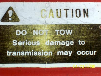

This is a sticker on my YM226. I guess it means don't pull it behind another vehicle :confused: ... Does your power shift tractor have this sticker??? If you put this tractor in Neutral (both places) wouldn't the transmission gears not turn???? I hope I never have to tow it, but if I am down the road and it "breaks",,,, what ya do??? I guess it would be alright for a short distance say;; one mile or less!!!!!
I'm sure dem Japanese didn't mean;; Don't tow somin behind tractor!!!! :D :D

I have a 2220D with "power shift." My manual [it has been wrong before] says.
"Be sure the hydraulic system is at the full mark on the dipstick. If tractor is to be towed with the front end raised, add 1 quart.
Make sure differential lock is dis-engaged.
Place the range lever and the gear lever in neutral.
Place the 4wd lever in 2wd [if equipped].
Place PTO lever in neutral.
It also states "Never tow tractor faster than it's maximum travel speed in the highest gear. Never tow above 16MPH. Check local laws on towing.
So I assume you can indeed "tow" it but before you do place everything in Neutral and don't go faster than 16 MPH. Oh, and don't forget to check those local laws.;)
