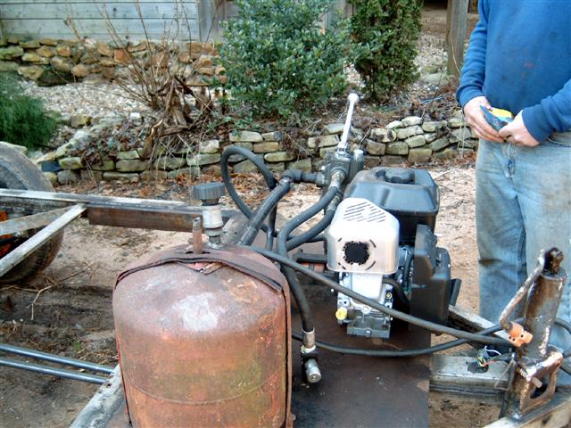

Hey Y'all!
I was going thru some pictures and found this. This guy built this dump utility trailer and I was so impressed that I took these two pictures in hopes of one day building one too. I do remember the guy saying it's a 5hp engine. I can't remember what the big tank is for. Is that the hydraulic resevoir? Reason I ask is becasue I'd like to build a smaller version and was wondering basically is that all one needs, an engine, a resevoir, the hydraulic arm, the control, and the hydraulic pump? I have 3 of the 5 items laying around. And is there anything else that can be used for a resevoir? At any rate though, I think this guy did a pretty decent job of doing it himself and it worked great.
Steve.....who is becoming more and more hydraulicly obsessed /forums/images/graemlins/grin.gif I want to hook up some hydraulics to our bed, hahaha! just kiddin /forums/images/graemlins/grin.gif

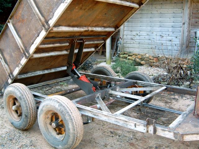

and the rest of it.

Yeah, it looks like he used an old freon tank for his hydraulic resevior. Neat set up except that have to start the engine every time you want to use the dump. Ithink that I woul have gone wit an electric/hydraulic unit.
