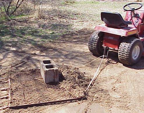

I'm trying not to reinvent the wheel here. I need a smoothing side and a rough side. Trying to rough up my yard, seed and smooth. I figure 4' by 4' will be plenty for my area. Found one I like shipped for $200 but I'm trying to save money. My initial thoughts are chain link with rebar ?teeth? on one side. Haven't figured out the weight part (with even dispersement) yet? Maybe instead of weight just make it longer?Any ideas or pics would be greatly appreciated.
Thanks in advance,
Jerred
   / Do it yourself drag harrow #2

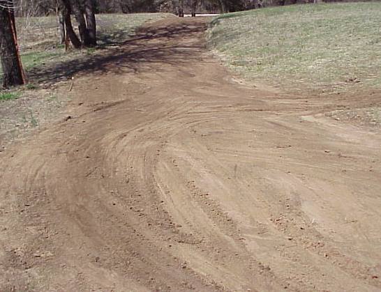

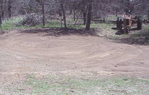

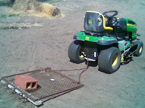

I made a couple of small ones for lawn tractors several years ago from frames I was given. IDK what they were originally but that's not important.
I use one as a harrow by driving big bridge spikes through a 2x4. Hitched close to the tractor the harrow is all that contacts the dirt. The number of spikes and weight is kind of by guess and by golly depending on type of soil and moisture. By pre -drilling under sized pilot holes the spike angle is easily determined. Different 2x4s with different spike angles could even be attached.
The spike harrow could be flipped over but I already had the smoothing rigged. Depending where I tie the chain knot determines the angle it is pulled, either square or on the bias of an infinite number of angles. Pulled on the bias the smoothing works decent for filling pot holes in the drive.
