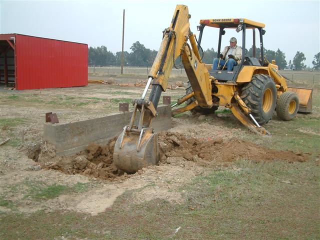

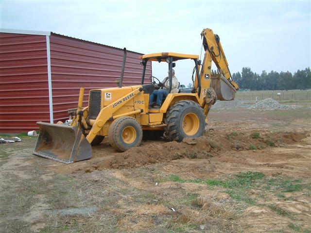

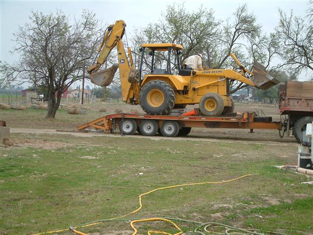

Sure--something like a John Deere 410 TLB

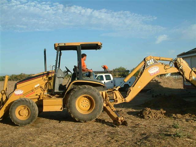

Or a Cat 4200
