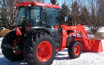

TractorsareGood:
I think that site name should be: KubotatractorsareGood!!
Anyway, I have a 5030HSTC. If you go to my profile and view my posts you can learn a great deal about what I do with the tractor and some of the problems I have had.
My last tractor was a Kubota L-3710. It didn't have quite enough suds for what I do, besides it didn't have a cab!! I (we) grow hay commercially on about 100 acres. The 5030 harvests all that hay with the exception of the kicker baler which goes on our Deere.
If you plan on tillage work, don't get a 5030. I am not saying it can't plow or cultivate, it's just that there are better suited Kubota's available. 40chicks has an M series, which is the ag series. He's pretty happy with his. The 5030 is really a crossover tractor between the L and M series. I'd have probably bought an M series, but the overall height of the cab precluded me from parking the tractor in my heated shop and I like to keep the 'Kubby warm in the winter.
I have:
5030HSTC
LA853 Loader with quick attach
Heavy duty round back bucket
R-4's (not loaded) I don't believe in loading tires on MFWD tractors
2 sets of remotes
I also got the am/fm cd weather radio, rear wiper, extra worklights (front and rear) rear defroster grid and extra tint on the glass (which I am glad I did)
I paid $32,130 for mine. I didn't haggle at all. I've dealt with my dealer for about 20 years and if I need something, he's there. I told him what I wanted, he got it and I kept it for a month before I even signed the papers! I probably paid too much, but you can't put a price on fun!!
I have the HST. The HST is ideal for haying as you can control the ground speed with getting a cramp in your left leg.
Our other tractors are all power or glide shift. The hydro is much easier to handle when haying.
If you do get a 5030 or another GrandL with an 853 loader, from my own wisdom and opinion, don't get a material bucket. Get the HD bucket. The 853 will destroy the light weight bucket if you try to dig with it. The material bucket is just that, for moving grain, gravel, sand, etc. It's not for excavation. If you put it in the ground, you will bend it.
