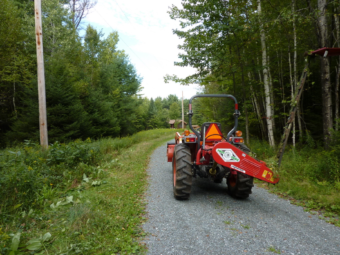

Maybe there is something I am not understanding about your question but I have a sicklebar mower and don't use the drawbar or need any chains on the drawbar. It is a Superior or First Choice mower. Sweet Farm carries them and is where mine came from.

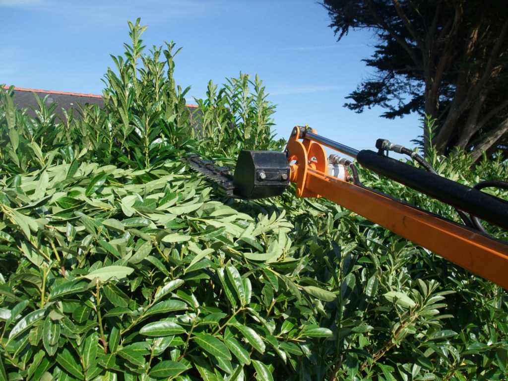

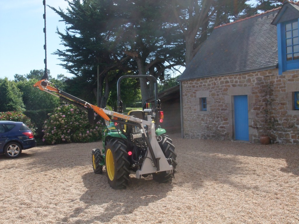

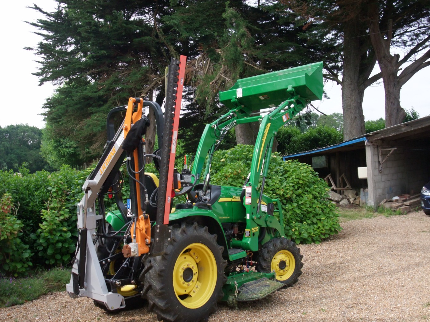

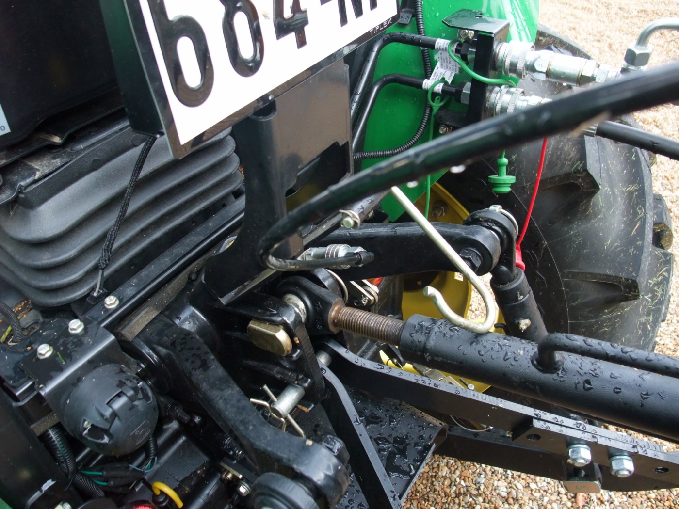

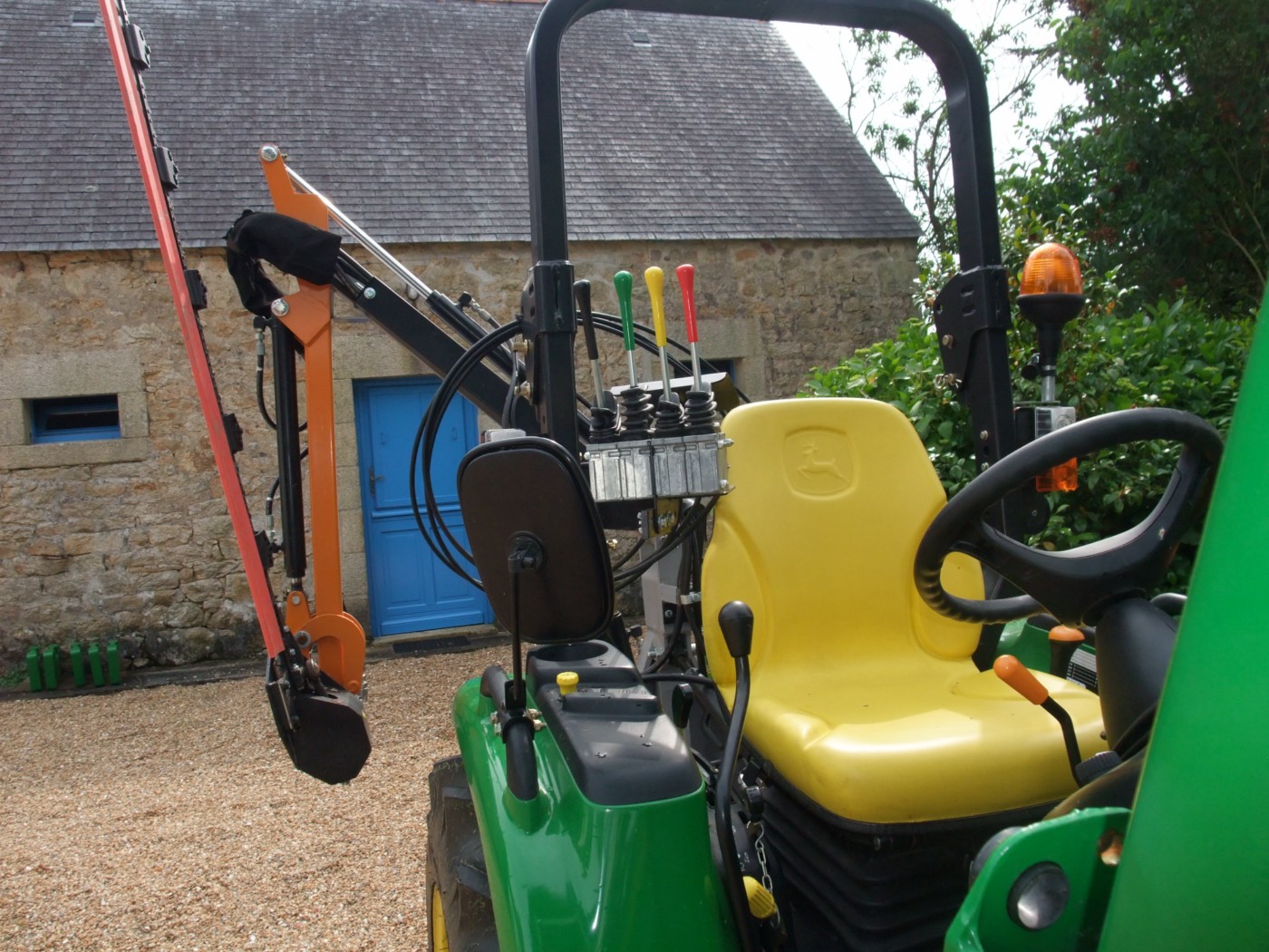

Some models may use the draw bar, but mine doesn't. It uses the usual 3 pt hitch plus two stabilizers hooked to the lower holes under the 3rd point. There is a safety device that frees the implement if it catches on something hard and there's no way it can make the tractor roll or capsize.
Now THAT is one heck of a sickle mower. Unfortunately, I'm pretty sure it's way out of my price range. I'm looking for a used one that is less than $2K.
