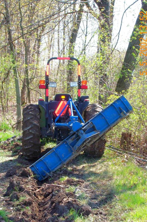

Here's a little "tilting" with my MD Ford 8' rear blade...
{see attachment}
