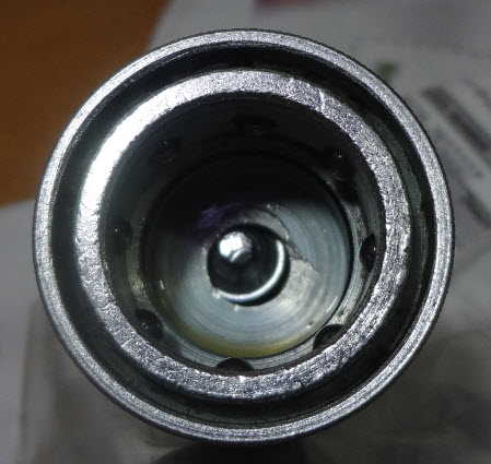

Same thing occurred on my MF DLT120 Loader. See image of female body poppet valve issue. Took some time to find a replacement; however, here is what I found along with cross reference part numbers. Prices range approximately $40 for the complete coupler or approximately $20 for each body or male tip.
Complete Coupler Body Male Tip Size Thread Manufacture
S40-3P S45-3P S41-3P 3/8 3/8-18 Safeway P=Poppet Valved Models
4200-3P 4250-3P 4010-3P 3/8 3/8-18 Parker / Pioneer
N/A G94121-0606 G94111-0606 3/8 3/8-18 Gates
Hope this helps; cheers!

Yes, I just went through the same thing. Your picture shows the tit not centered. You can center it with a screw driver and it might work for a little while, but it will fail again. If you replace the female you should replace the male, as the tit being off centered it could scar the male coupler. I just replaced all 8 of mine, female and male. My dealer says he thinks it happens from shocking the loader, bouncing it harshly. If it happens to me again I may try to find a better coupler, maybe flat face couplers?
