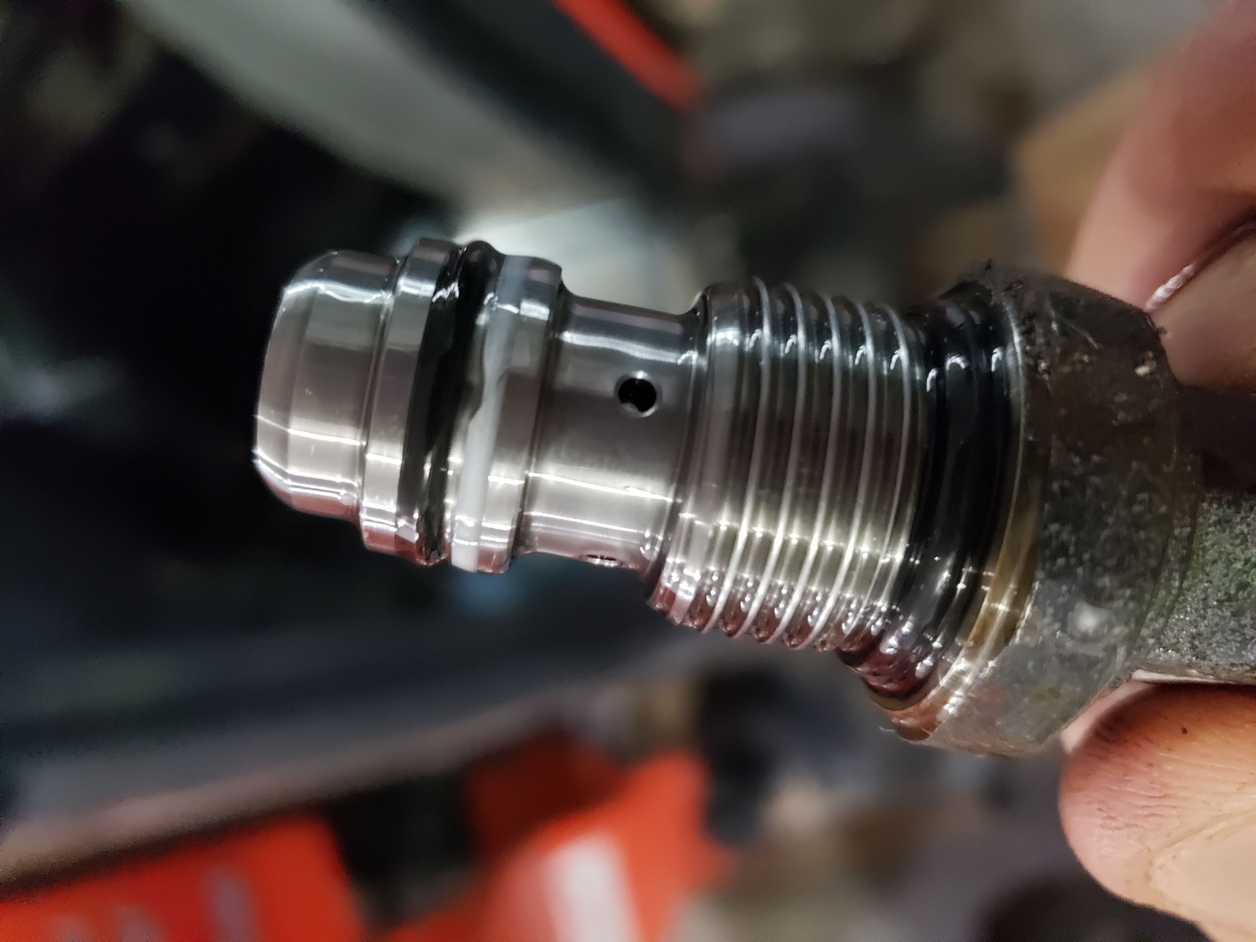

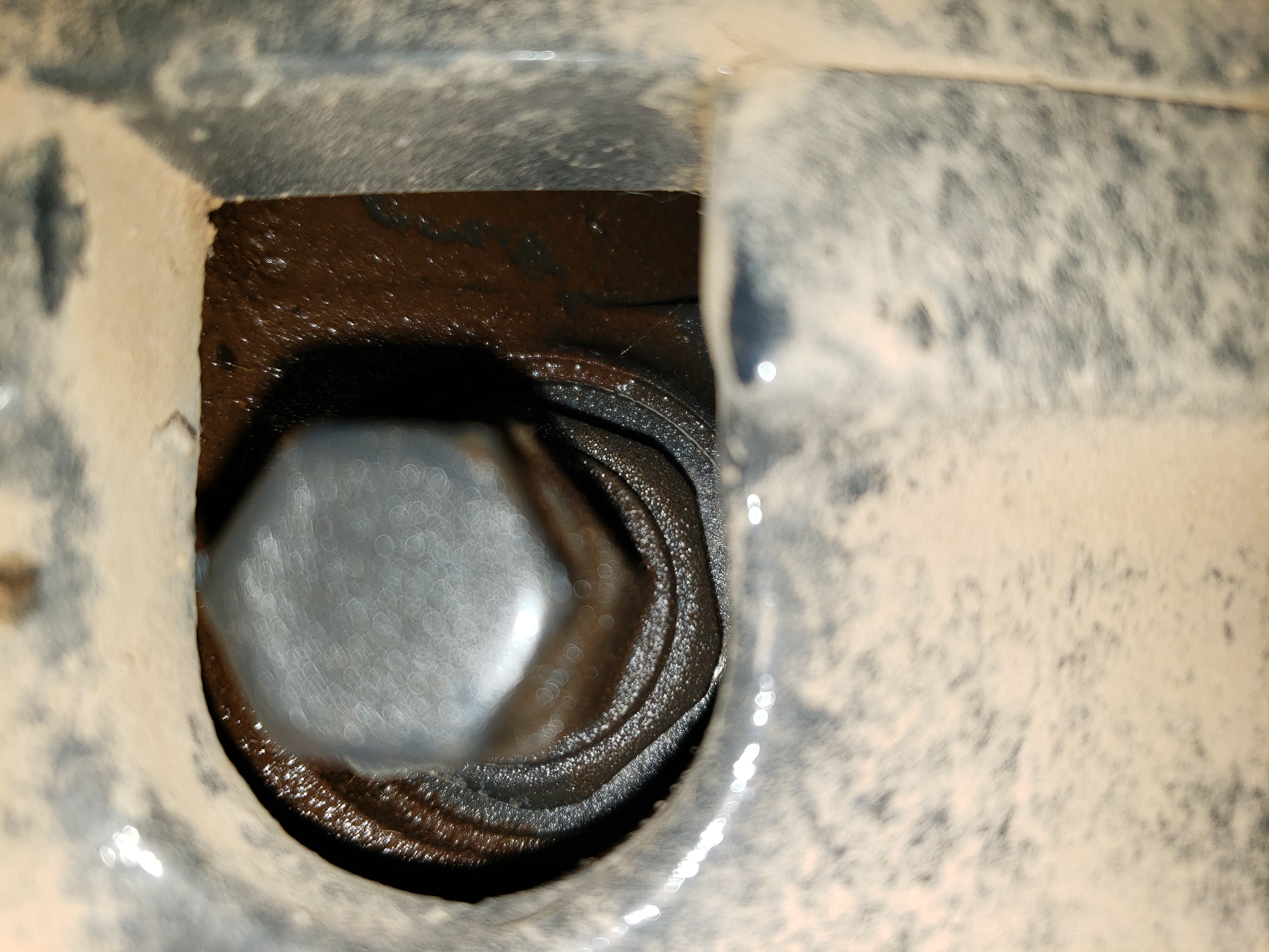

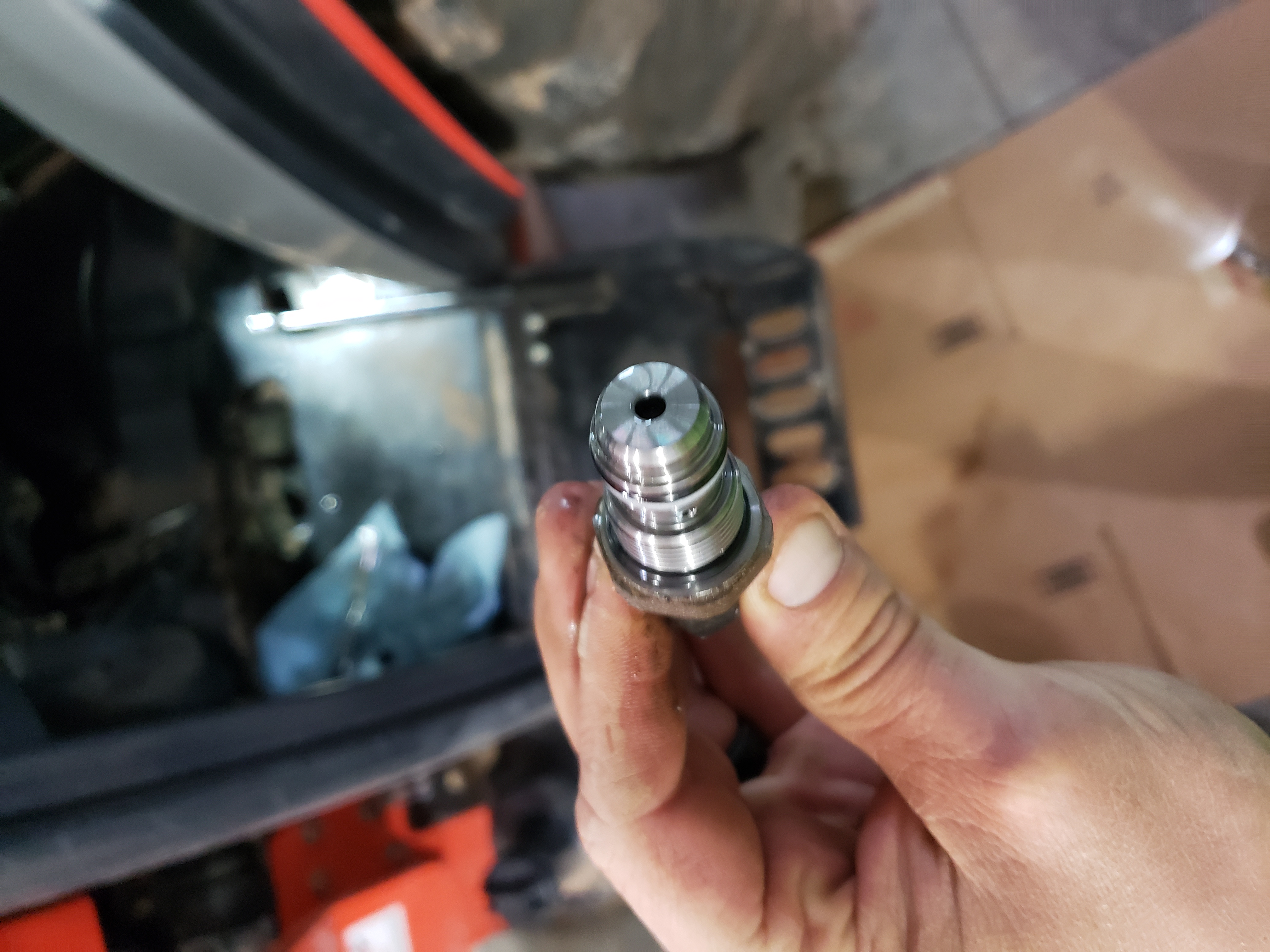

I'll be sure to include pics. I have a leak under my new dk53. A look under the transmission housing shows it coming from there but not from any of those internal parts. Fluid it coming from on top of case and running down the side.
I take it the floor mat and access the small door to the left of the wheel. There is a bolt/valve (being told the hst pressure switch from another group) that is very were looking. All the o rings seem to look good except the white one looks a little off. Could this be causing the leak? Is there anything else on top of the case that could be leaking (valve body, connection, breather) tractor is still under warranty being bought last sept brand new and has 66 hrs on it.
Dealer is 3 hrs away and trying to diagnose this before I take the trip to find out it's a $1 ring I can do myself.
I guess the next step would be lift the cab off it see for sure but it seems like there aren't to many good diagrams online unless some one can hook a brother up
Thanks in advance

   / Dk5310 hst leaking steady hydraulic fluid #7
Yes the white one has a nick on it, But the end one on the threads seals the whole thing from leaking out
