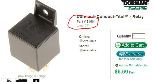

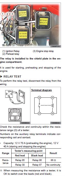

When you say "nothing", I assume you mean it won't crank. In other words, the starter does not pull in and rotate. The key switch does NOT directly control the starter solenoid. It cannot carry enough current to do this. There is a starter relay on your outside firewall . It is the first relay on the left as you look from the engine towards the cab. This is a likely culprit, BUT it is under control by several other things. The PTO must be off, and a ground must be thrown by the cruise module to the low side of coil of the start relay. Remember the contacts of the start relay energize the starter solenoid, but the coil of the start relay is energized by the key switch for the +12 volts and the low side is grounded by the module that determines that the PTO is off and that the range selector is in Neutral. Only then will the start relay pull up, and it in turn pulls up the starter solenoid.
The start relays are a common failure, and you can use generic ones from the autoparts store. But keep in mind there are many things that can keep that relay coil from pulling up. Cruise module, PTO control relay, PTO switch, the diode in the ground side of the start relay coil, etc. etc. But do the easy and most likely thing first, and change out the start relay.

If it isn't a start relay shelling, I found out in 2014 that if I leave my Kioti tractor parked with the parking brake on for a week or so in the summer, the brake safety switch screws up in high humidity. The switch needed to be exercised (i.e. on/off-on/off-on/off and so forth) in order to clean up the contacts and start working again. If you're parking your tractor in a heated garage making everything sweat, I bet you have a similar problem.
Very nice clear explanation, James.
Another way to check if the start relay is the problem is to switch it with the stop(fuel) relay. They are the identical small relays. The larger relay is the preheat relay. If all else is OK the tractor should crank, but it will not start because the faulty relay is now the fuel relay. At least if it turns over it will confirm the other components in the start circuit are working.

3. Power to dash lights and in Acc/run position, but tractor doesn't start, tap on the relay on the left of the three relays on the firewall, as viewed from the front of the tractor looking towards the rear.
a. Try swapping relays 1 and 3, they are the same part.
b. If you have a helper turn the key to the start position, if you put a finger or two on relay 1 you should feel it click on.
