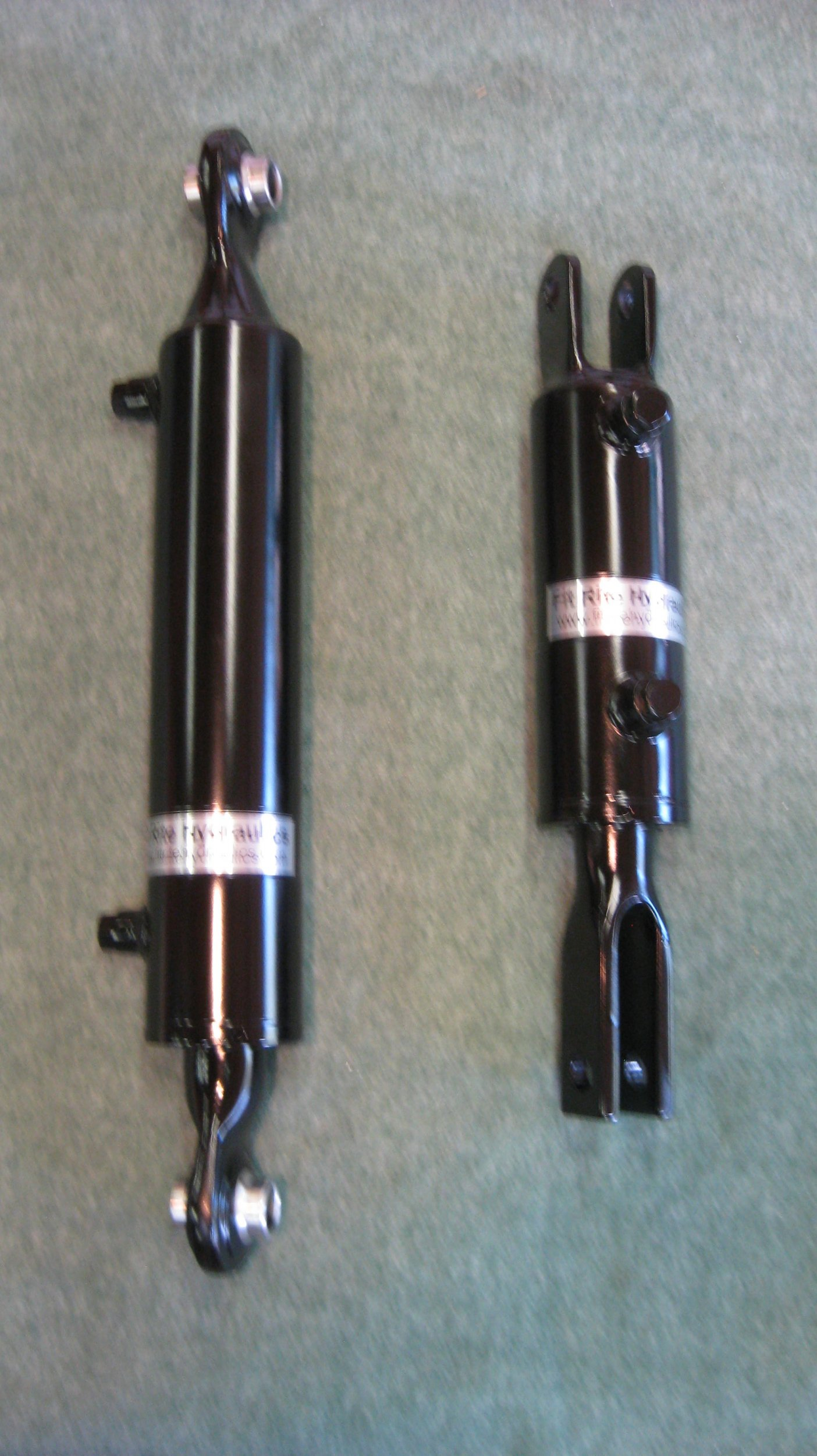

I normally provide a 2 1/2" dia cylinder with a 1 1/2" dia rod having a 19 1/4"- 27 1/4" working length for the customers that purchase them from me.

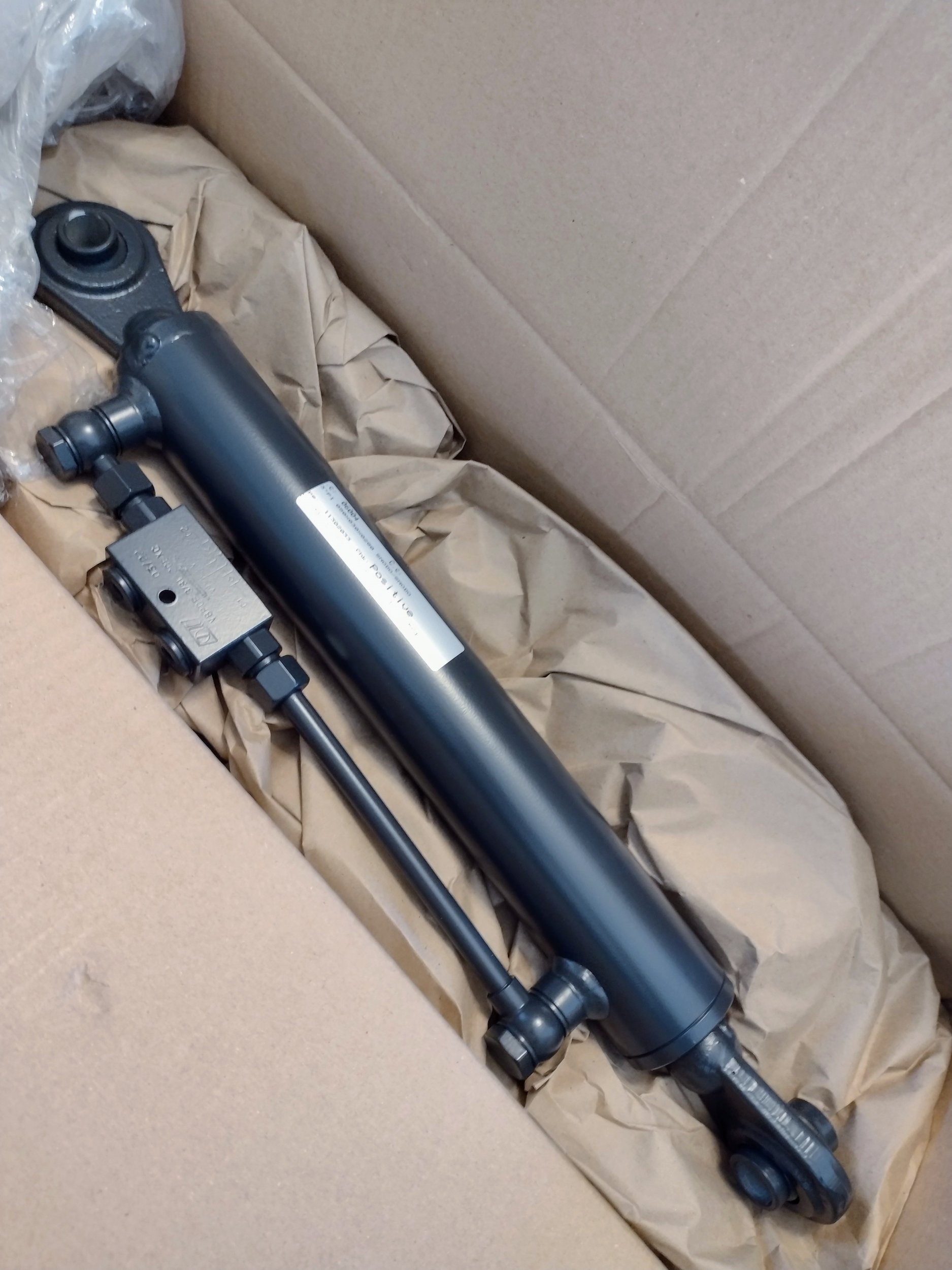

You want the last length you posted. My 4820 is the same. I purchased from AgriStore. Free ship. One day delivery. Built in Italy. I bought flow restrictors to make the unit more useable . The flow on the 4820 was much too fast.
