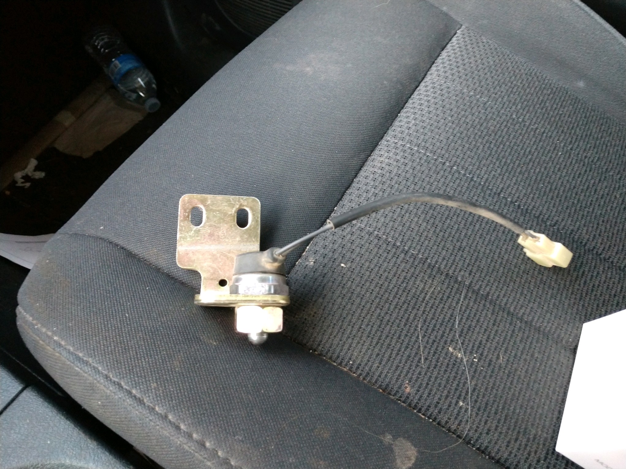

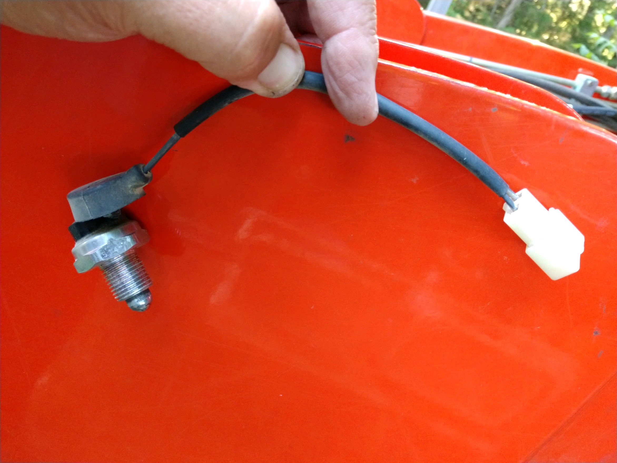

I have looked through old threads and haven't seen anything quite like this.
My DK45SE (2012) will not turn over. This happened two times before and I was able to fiddle with the forward neutral shifter on the dash and it started then. It will not now. To be safe and start ruling out the possible pieces I cleaned the battery terminals to no avail. This evening after work I took off the switch that tells it when it's in neutral. The switch appears to be a ball type spring that when all pressure is off the neutral light comes on. I thought ok I will take it out to releive any possible pressure. No change. The switch is a sealed unit (see attached photos), the second pic is when it is mounted on the bracket. I am not sure which direction to go. The local dealer is in between mechanics or I would have had him send someone over there as I live only a few miles from him.
Anyone got any suggestions or ideas how to prove what is wrong? At this point I am thinking of spending the $86 on the switch to see if that is it.

Why don't you test the switch?. It is out in your hand. Put your ohm meter on it and operate the switch. Or continuity tester if you don't have an ohm meter.

Don't you have a security switch on your clutch pedal ?may be that one

As KOua said = Easy check with a DMM ( Digital Multi Meter ) set on Buzz .

You of course start any troubleshooting procedure by checking the obvious things like battery condition (again with the multimeter) Battery terminals and cables and possible voltage drops (again with that pesky multimeter) Starter solenoid and starter relay, key switch bus voltage and any safety switches (shuttle position, PTO etc) with your trusty multimeter and your brain.
Typically you either start at one of the the chain and work forward or you can break the problem in half by starting in the middle and isolating each half and working toward isolation of the defective half. Since you took the time to pull out a suspected part (the safety switch) you can quickly test that part individually and either condemn it or exonerate it and move on along the likely circuit chain.

Be sure the PTO is off. The starter will not crank if the PTO is on.
