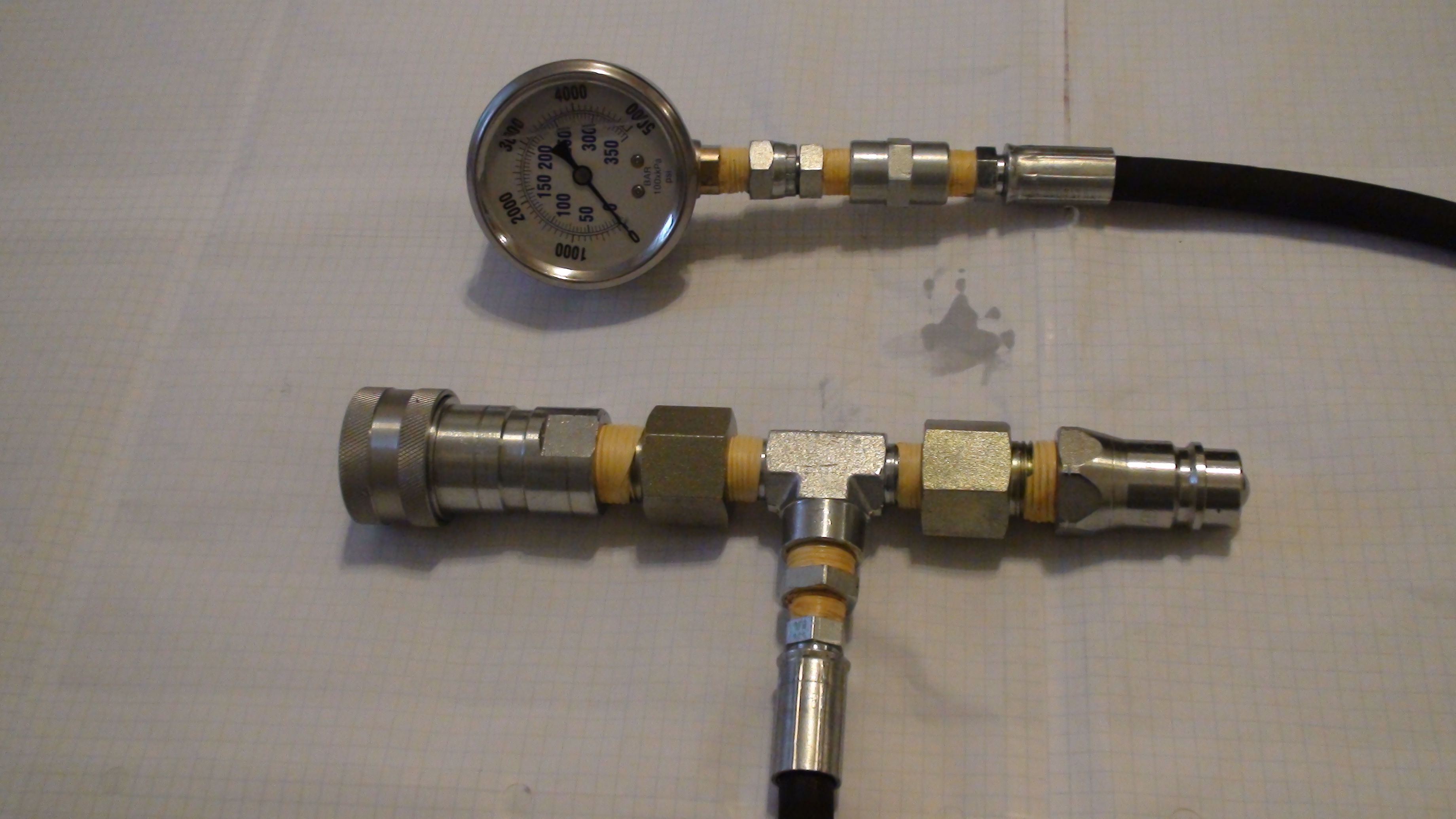

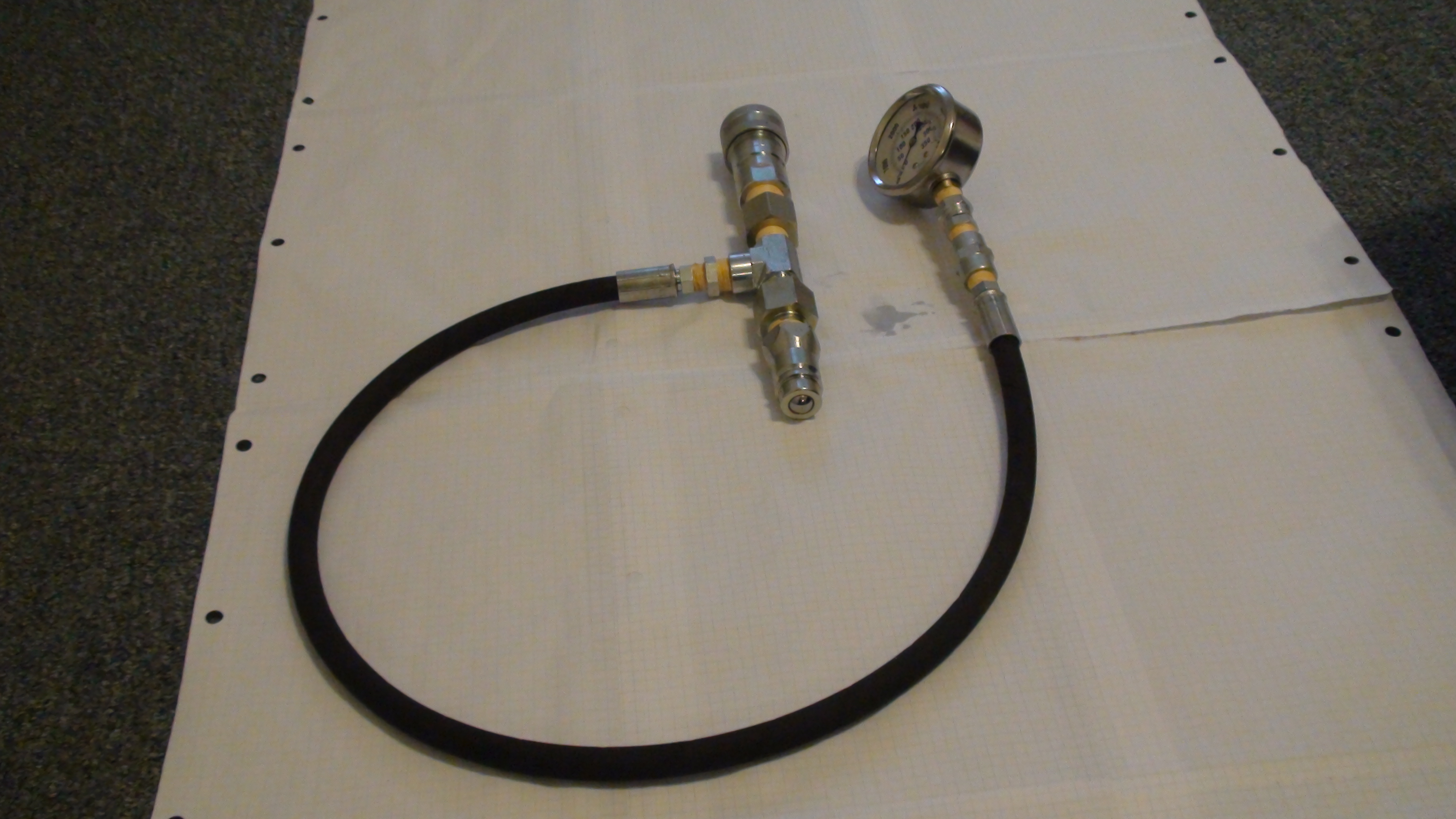

Can't help you with the HST issue. I test hydraulic pressure using the standard rear ports with this I made:

To the first poster - that looks like a great tester but I don't think the HST pressure can be read through the rear remotes.
