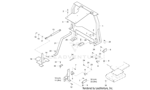

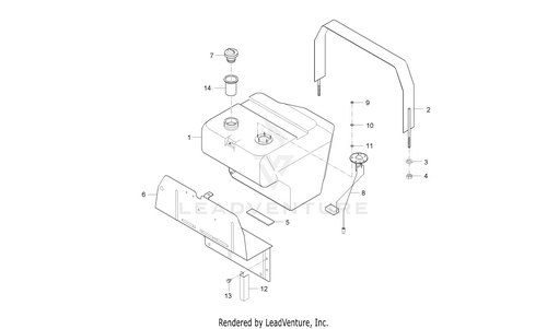

I replaced my tank due to the tank being kinked at the leak area, and even with repair would be structurely unstable with high chance of recracking. Also if you remove the fuel level sending unit from the tip chances are the studs around the edge have spider cracks in the plastic which will also leak.
Replacement tank not hard to find, but need to get it ordered by serial number since there are 3 different tanks depending on serial break. I did have to remove the loader and the hood mainly just to have access to what needed to be removed and for better control. I connected the hoist to the hood support bracket which is part of the fuel tank major frame assembly which has to come out to access the tank support strap.
This is the main conponents of the fuel tank setup at least for my tractor. But need to pay attention because later models are different

RandyT, If you would be so kind ..
(1) I think you are saying that I can't just disconnect the tank hold-down strap (#2 in top figure) but must remove the entire bonnet support bracket assembly (#1 in bottom figure) with the strapped-down tank attached. Is that so?
(2) Beyond disconnecting fuel lines and the fuel gage wires, what must be disconnected for that bonnet support to come out?
(3) Should the bonnet be removed by removing the hinge pin or should it be unbolted from the bonnet support bracket?
(4) With the bonnet support free is it just a matter of lifting while "jiggling" the tank/support assembly free?
(5) I have a convenient overhead tree branch and a 4-part block and tackle. Does that sound sufficient for the job?
Thanks for your advice.

Yes on (1)
(2) If I remember correctly has a couple bolts on the bottom corners on both sides, as well as maybe a couple of smaller bolts toward the top.
(3) you need to remove the bonnet from the hinge support because the hinge is a permanant part of the tank support bracket.
Yes on (4) The firewall can be pain because it doesn't like to just slip out and may need to come out with the tank assembly. I had to unbolt the muffler from the exhaust manifold as well as remove th bonnet support rod bracket from the top of the engine and the air cleaner assembly to get enough room to wiggle out the tank.
(5) should be fine. The tank/bracket assembly is not overly heavy just hard to manage because you have to lift at the same time as tilting forward out from under the dash and squeeze against the engine.
