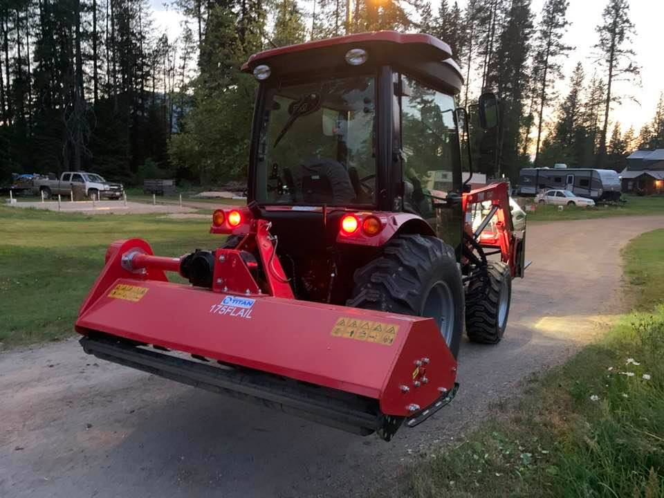

Yes, flail mowers to seem to require a little bit more ooomph........mine is rated as 30-60hp. My tractor only rated at 35.9hp at PTO (48.3Hp) and in extremely thick pasture grass it slowed down a lot. Mine is a Titan 175 (68'').
