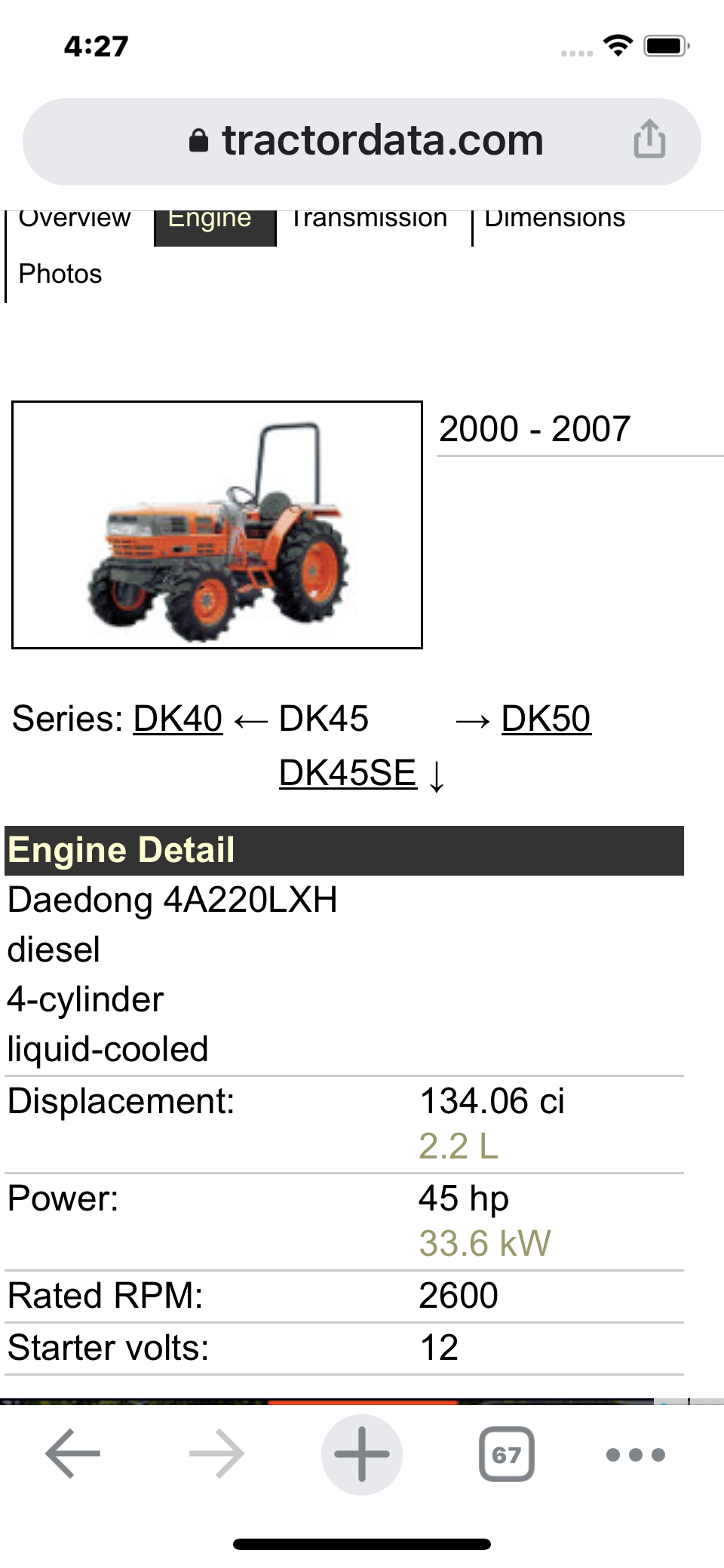

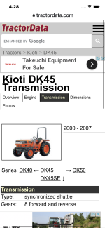

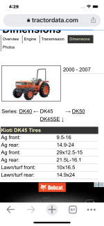

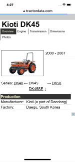

Kioti DK45 1999
Confuzzzzed, l have a Kioti DK45 serial number 956700071. The title indicates a 2006 year. It does have the forward/reverse on the left of the steering wheel that I believe was not added until 2005. Is it a 2006 or a 1999????? Please see attached and thanks for the help. The picture is the same as my tractor.
   / DK45 Kioti #2
In 2005 Kioti went from the DK45 to the DK45S the DK45 had the metal hood and fenders whereas the DK45S has the fiberglass hood and fenders.
   / DK45 Kioti #3
My 2005 DK45 S/N starts with the letter "D" and then the #5 which designates it as a 2005. Your S/N starts with a 9??? Also my S/N had 1 letter then 8 numbers in the string. I suspect your 9 is really a D. My tractor is less than 50 away from yours if my assumption is correct. I purchased mine in March of 2005.
   / DK45 Kioti #4
All years of the DK 45 had the forward/reverse shuttle lever beside the steering wheel.
