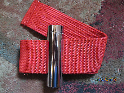

The hydro filter (pump, not the HST drive) was tight but nothing crazy like others have mentioned in similar threads. Thanks to reading earlier posts I took home from my work toolbox a snap on A91E strap wrench, a 36" 1/2" drive breaker bar and a 12" impact extension. This combo made very, very quick work of that stubborn filter. I can see how it would have been challenging without these tools.
