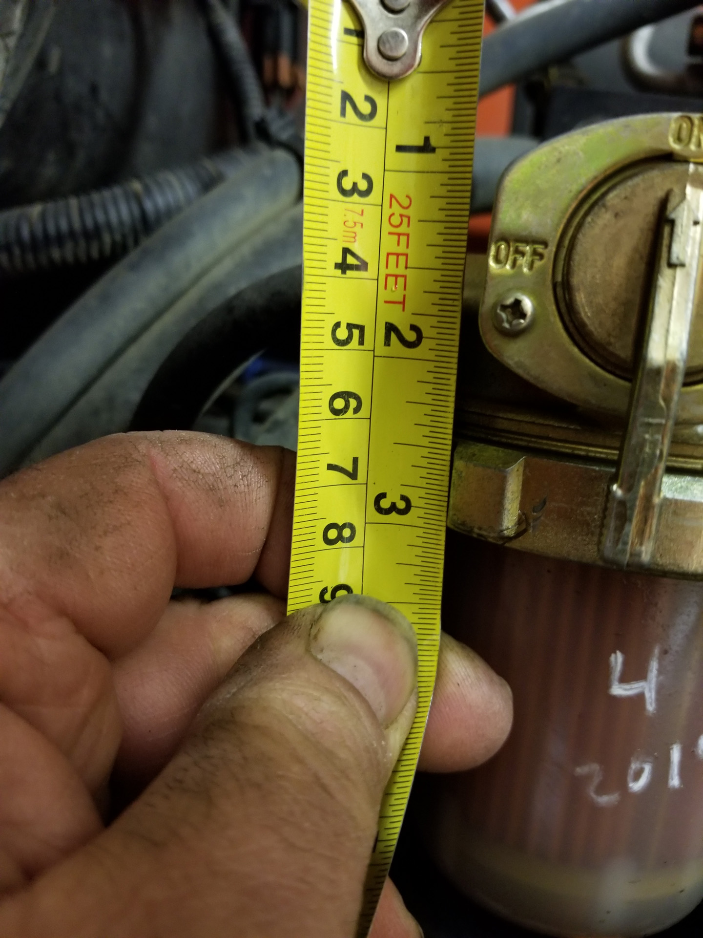

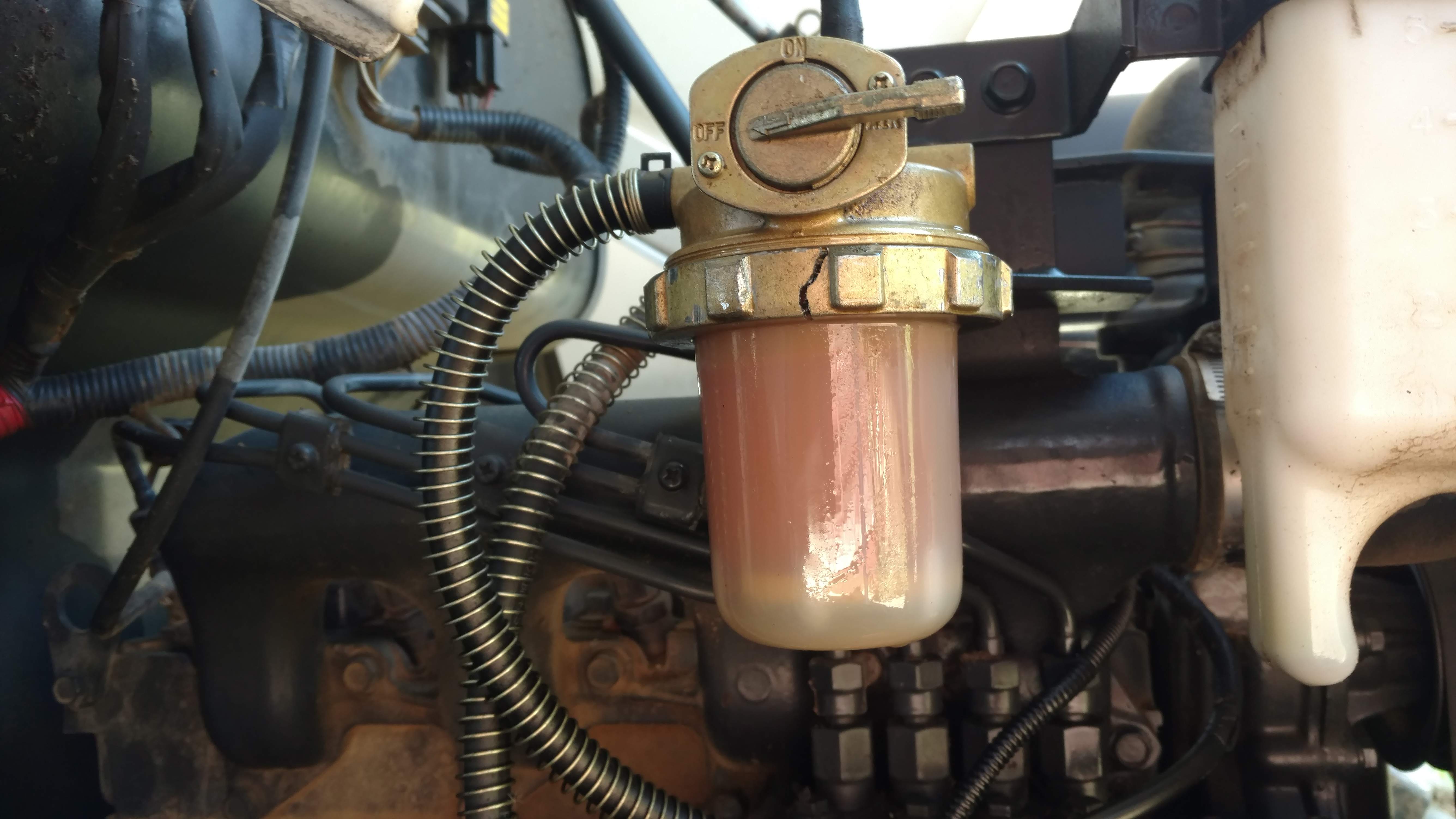

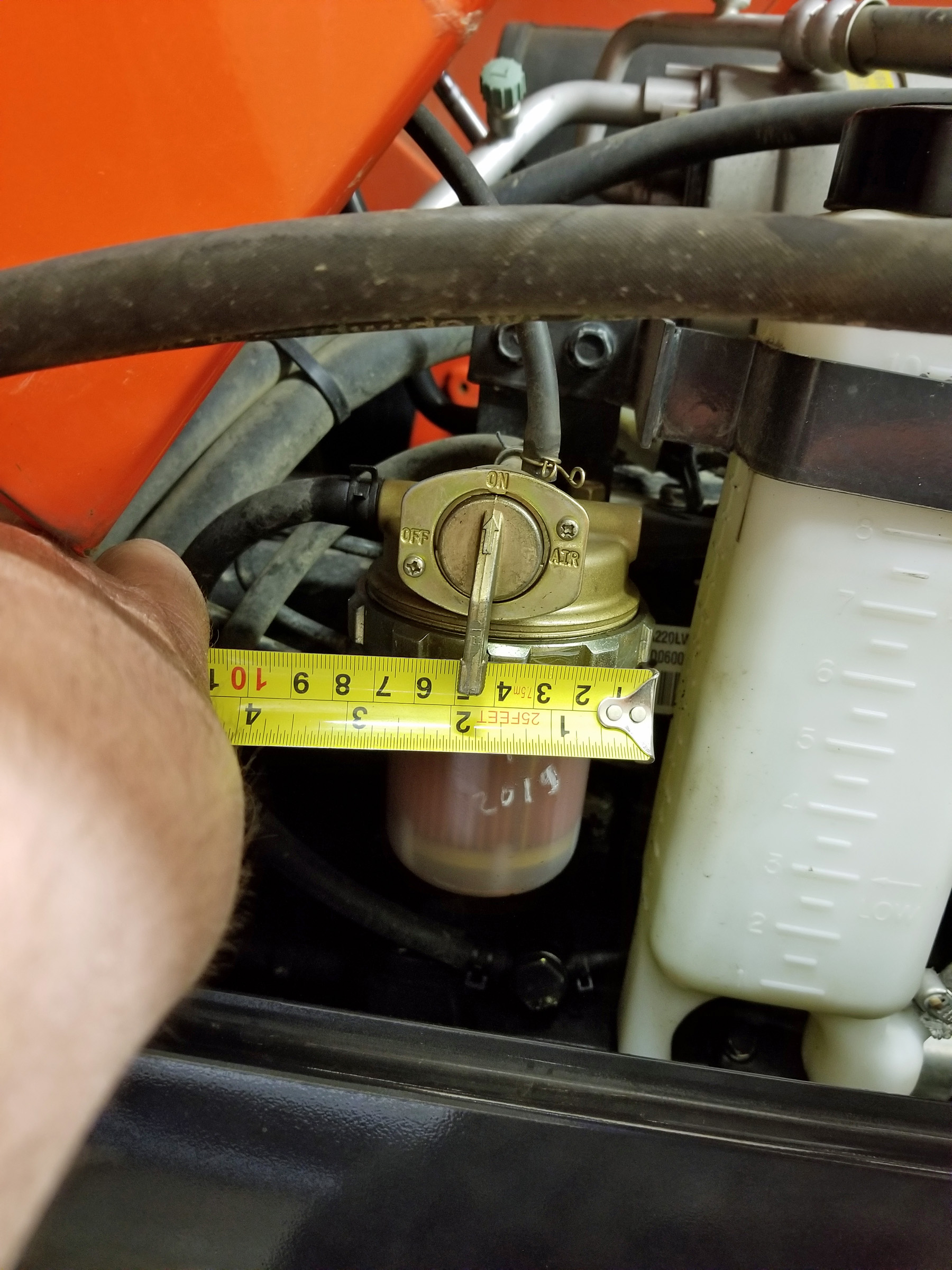

Could use some help finding "retainer" to fit,or a full new assembly.
I am wondering if this part is the same on the Kioti. I'm not certain as the Kioti diagrams I could find do not show the breakdown of the filter assembly nor a good pic. I can get a Bobcat part, but it will take a few days though and I am down, with good weather, now.
I am cross posting to the Bobcat forum. Moderators, my apology if that is a no no.
Bobcat CT450, SN:ABHM11193 - 50HP, 4cyl Daedong - Similar/same as Kioti DK45/DK50
I am looking for service parts for above named tractor.
I believe that item 15 is the compete Assembly, containing all of the other parts.
My actual need is Item 17, Retainer. Mine is cracked.
However, while in there I would like to put new seals, filter, spring, etc.
So, I either need item 15, or all of the other items.
Qty Item PN Desc Notes
1 15 7002188 FILTER, FUEL Complete Body+Internal Assy
1 16 6697045 HOUSING BODY FUEL FILTER Body Mount
1 17 6696486 RING RETAINER Bowl Ring/Nut
1 18 6696463 HOUSING FILTER Plastic Bowl
1 19 6696732 SPRING Filter Spring
1 20 6695912 FILTER FUEL ELEMENT Filter
1 21 6694162 SEAL O RING Large O-Ring
1 22 6694147 O-RING Small O-Ring
Picture of my filter assembly:
