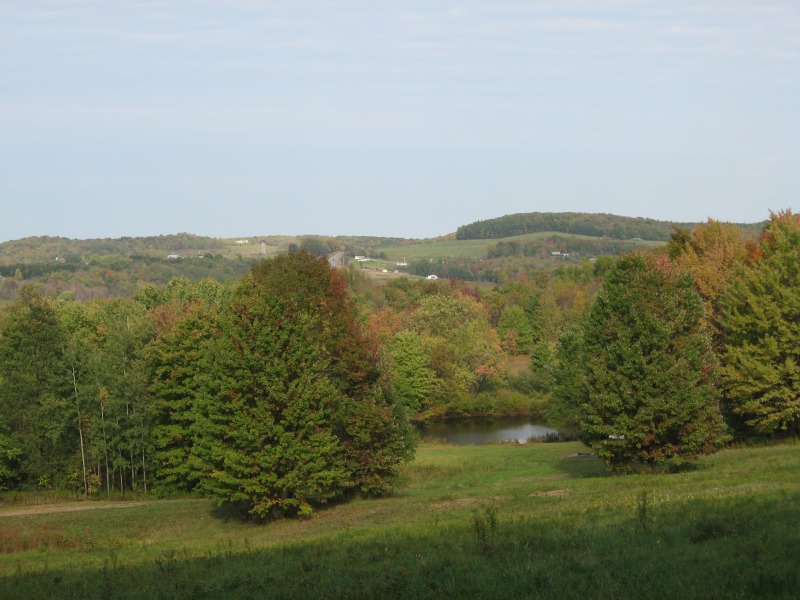

No experience with the DK40 but I have a DK35 that I use on very hilly country. and it works great. The attached is a shot from one of my higher firlds and shows the kind of hill country I'm in.
