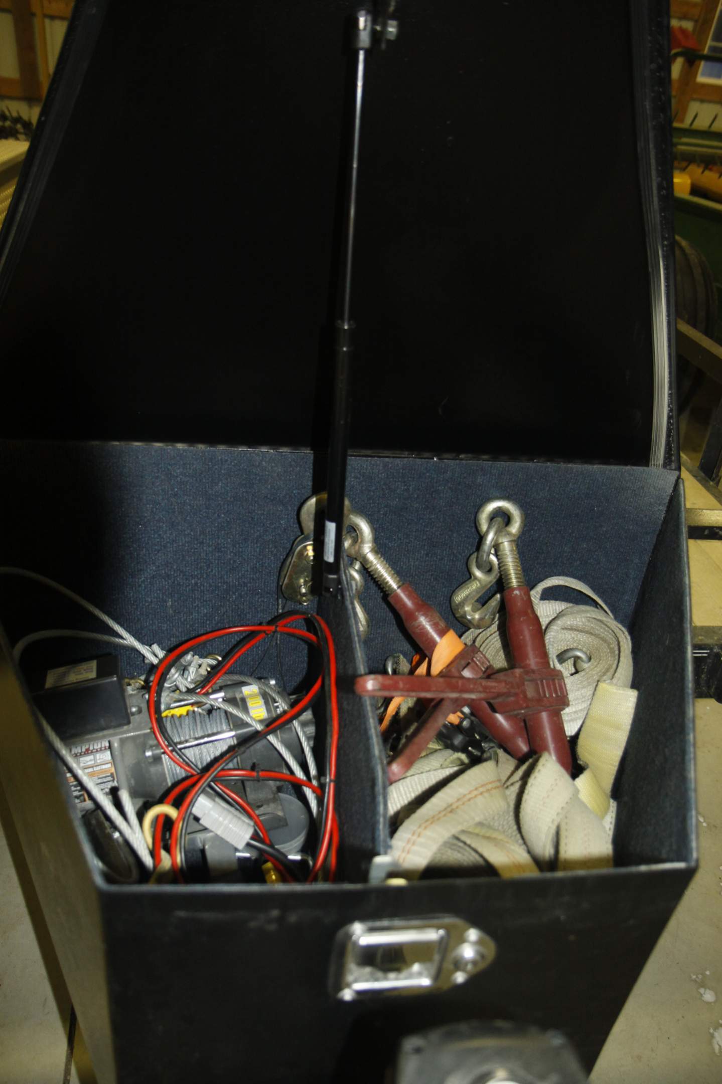

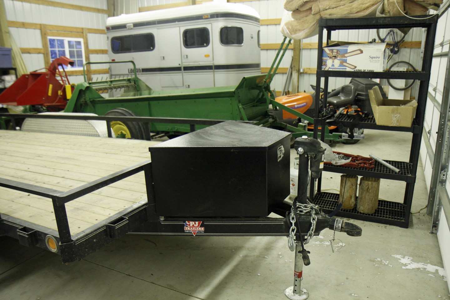

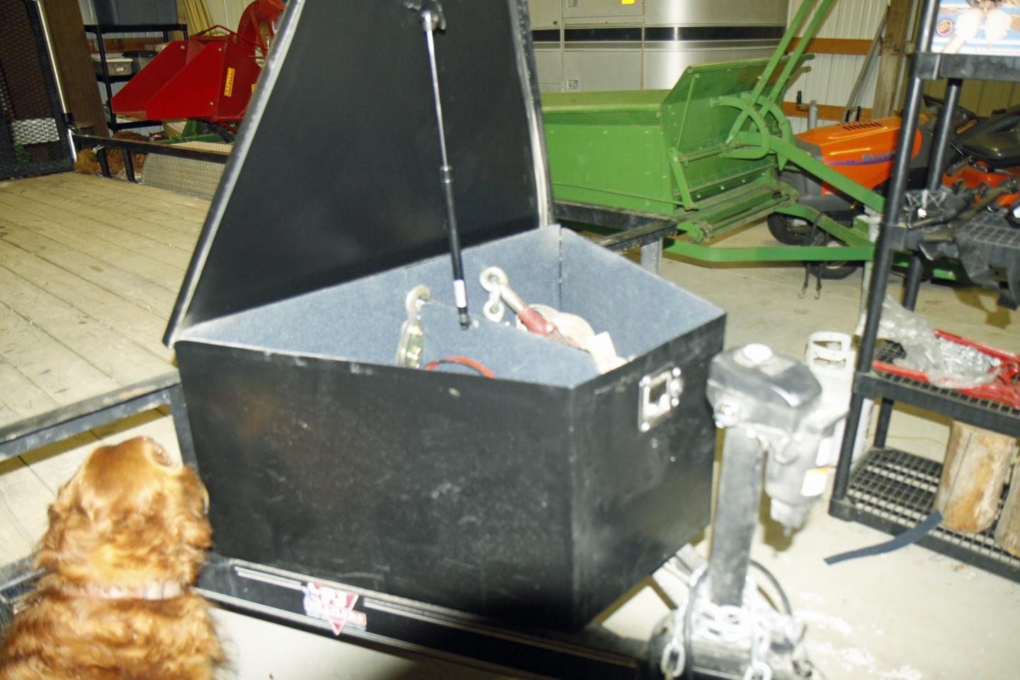

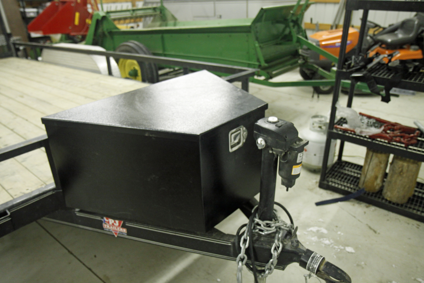

er..... most bumper pull hitches are only rated for 5,000#. some can handle 10,000 if a weight distributing hitch is used (they have to be marked as such).
personally, id go for a gooseneck trailer if you want the 10,000# rating.
My old PJ trailer is too small for my new tractor, so ill be in the market to upgrade to a 20' gooseneck in the near future. too bad too, cause i just got finished upgrading my old trailer with a new hitch storage box that i built and 2 rear swivel jacks to help with loading heavy tractor. also added a spare tire.
i sure hate to have to sell old PJ.

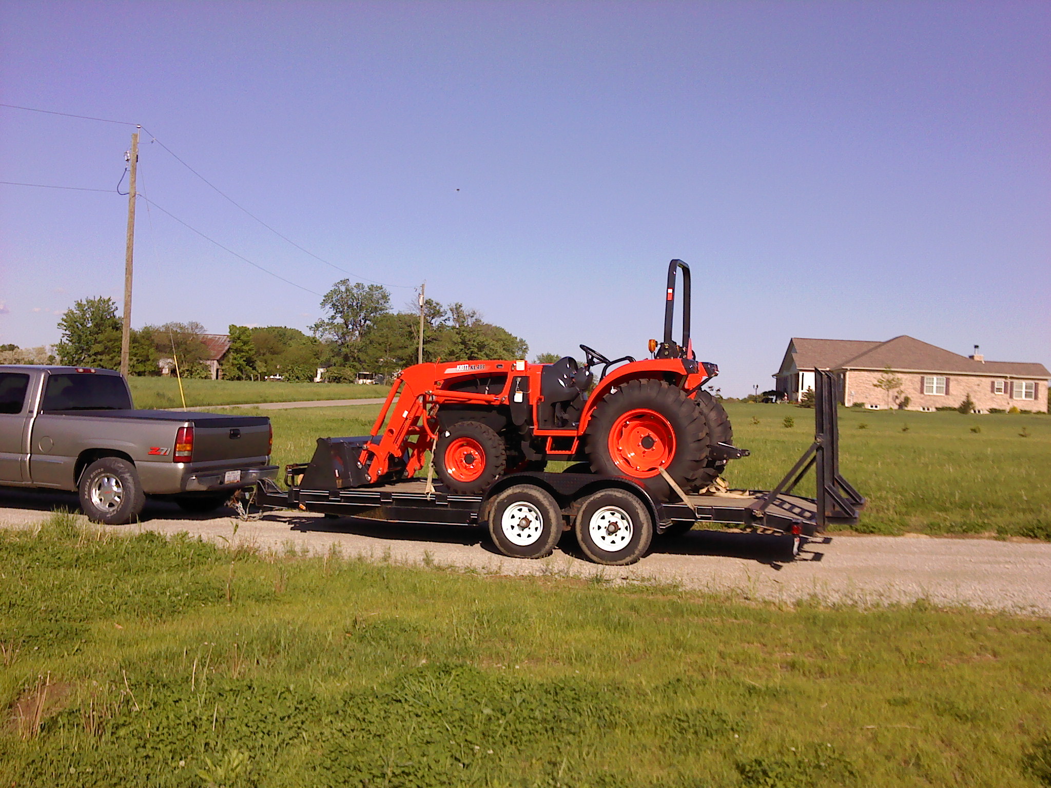

I have a 10,000 GVW rated, 18' trailer w/ a 2' dovetail. I pull it with a 1/2 ton pickup and believe it or not, the 1/2 ton does a fairly good job. I'd love to have a 3/4 ton to pull it with but that's not an option, at least for now. Just make sure you have a good braker controller and good brake pads (on your truck)!!!
I have a DK40SE HST w/ a K401 FEL. It fits on the trailer just fine but I wish I had longer trailer (bought the trailer 5 yrs B4 I got my tractor). The extra length would be nice when I have my 6ft Woods Brushbull on w/ the FEL. I have to put the bucket over the front rail of the trailer. I don't have pics of this but you can see below the DK & FEL looks like on my trailer by itself. If you plan to trailer alot then the length is something I'd take a serious look at to make sure your equipment is not hanging over/off the end of the trailer.

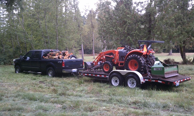

I own a 10k rated PJ trailer, 18' with 2' dovetail. It is a stout trailer that is built much much better than their standard 7000GVWR car haulers. The 10k model gets 6" channel and it is a very well made trailer.
Here is the key info that you didn't ask for but that you MUST know for your itnended use. The empty trailer weighs 2500# and is exactly 250 on the tongue with 2250 on the axles. Thus, you can calculate that your 6000# cargo weight is well within the limits of the trailer. Further, you can calculate that your poor half ton will be towing 8500# with more than 850lbs on the ball.
I towed the pictured load with my half ton chevy and it did really well. My trailer cargo was only about 4500# though and my engine was 350 cubes.
I now use a diesel F350 as shown in the photo. It is a nicer tow but that half ton chevy was actually pretty good. I would still have the half ton except I wanted a crew cab.
The only thing I would change about my PJ is that I would get a few more feet in length. At least 2 maybe, 4. The mower hangs off the back too much. The only time I wished for a tilt bed is when I am having to lift out and place the ramps. Ramps for a 10k trailer are pretty heavy after a long day.
On edit: Notice the WD hitch system. Anybody that has actually read their owner's manuals will use one. They work great even when you have a big huge burly diesel.
