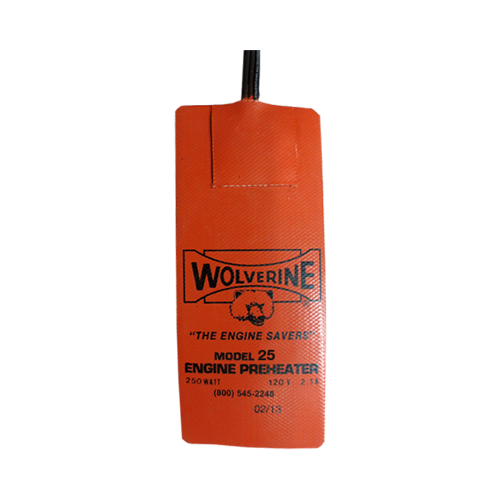

Anyone know what oil plug thread size is on a 2007 DK40SE HST?
Thinking of getting an oil heater that goes in the oil drain plug hole.
Anyone have any experience with heating the engine this way.
Have a magnet heater on the frame rail next to pan as the pan is non-ferrous and it isn't really cutting it in subzero temps. Figured the oil plug was the next best I could do.

I use stick on silicone heater. I didnt want to use any plug that could fall out. I use 2 small heaters as the drive shaft split my oil tank.
Been working great for 11 years now.

How well do these silicone pads adhere? Have yours remained attached over that time with OEM adhesive?
I have been thinking about adding some to my transmission case.
   / DK40SE HST oil plug thread size (for heater) #5
Mine have not moved since installed in 2010. When i installed it i put a bead of silicone around the entire outside edge as per instructions.
   / DK40SE HST oil plug thread size (for heater) #6
I put one of those pads on one side of my oil pan in conjunction with block heater. Works well, and don't think it will ever come off. The adhesive is strong, and you put a bead of 'silicone' around the edge that is supplied with the pad. I used the canadian polar pad. various sizes sold on amazon. canadianpolarpad.com

Thanks all -probably easier than changing the oil in sub-freezing temps.
Any of you actually install the pads in the cold weather? I will have to do 2 of them as well, similar split oil pan.

No, i installed mine in summer.
   / DK40SE HST oil plug thread size (for heater) #9
I put them on my tiny truck in late fall, after first snow, because it was really hard to get him running when seriously cold.. It was probably mid twenties when I put them on.
I have them on the engine oil pan, and the lowest flat spots on the transmission, and transfer case. The truck starts up, and the transmission is warm enough to shift after a bout a two minutes of running.
It was about 5 below last week, and the truck started right up at home where it is plugged in. Drove it to work, and had it parked outside all day, with a high of 3-F. When I went out after work the truck was a little difficult to start, and the transmission was hard to shift for about ten minutes. So, I know they are still working
The trick to getting a good install, is to clean off the spot you’re going to adhere it to with brake cleaner and get all the oils you can off of it. Then put the pad on a clean spot. I sealed the edges with some 3M ”Safety-Walk” Edge Sealing Compound 902, then kept the truck running for an hour to make sure it had enough time when it was warm enough to set the adhesive.
Been on six years, and still working well.

Thanks everyone. Installed a couple strips on the oil pan a few weeks ago and they're working nicely.
