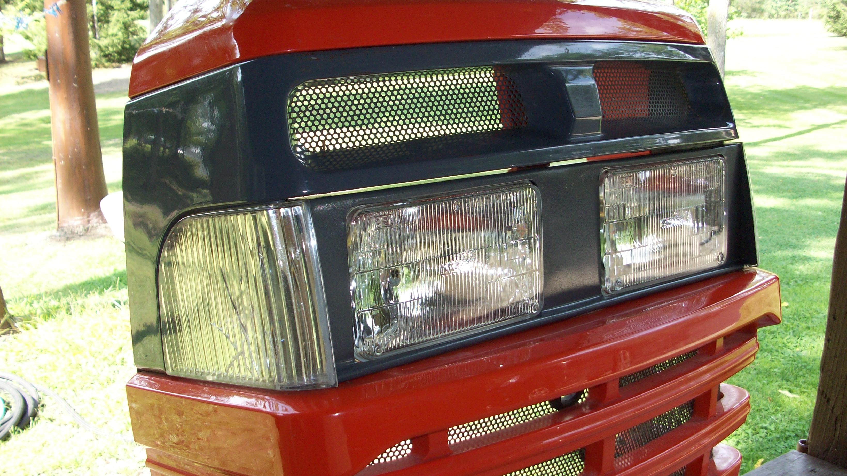

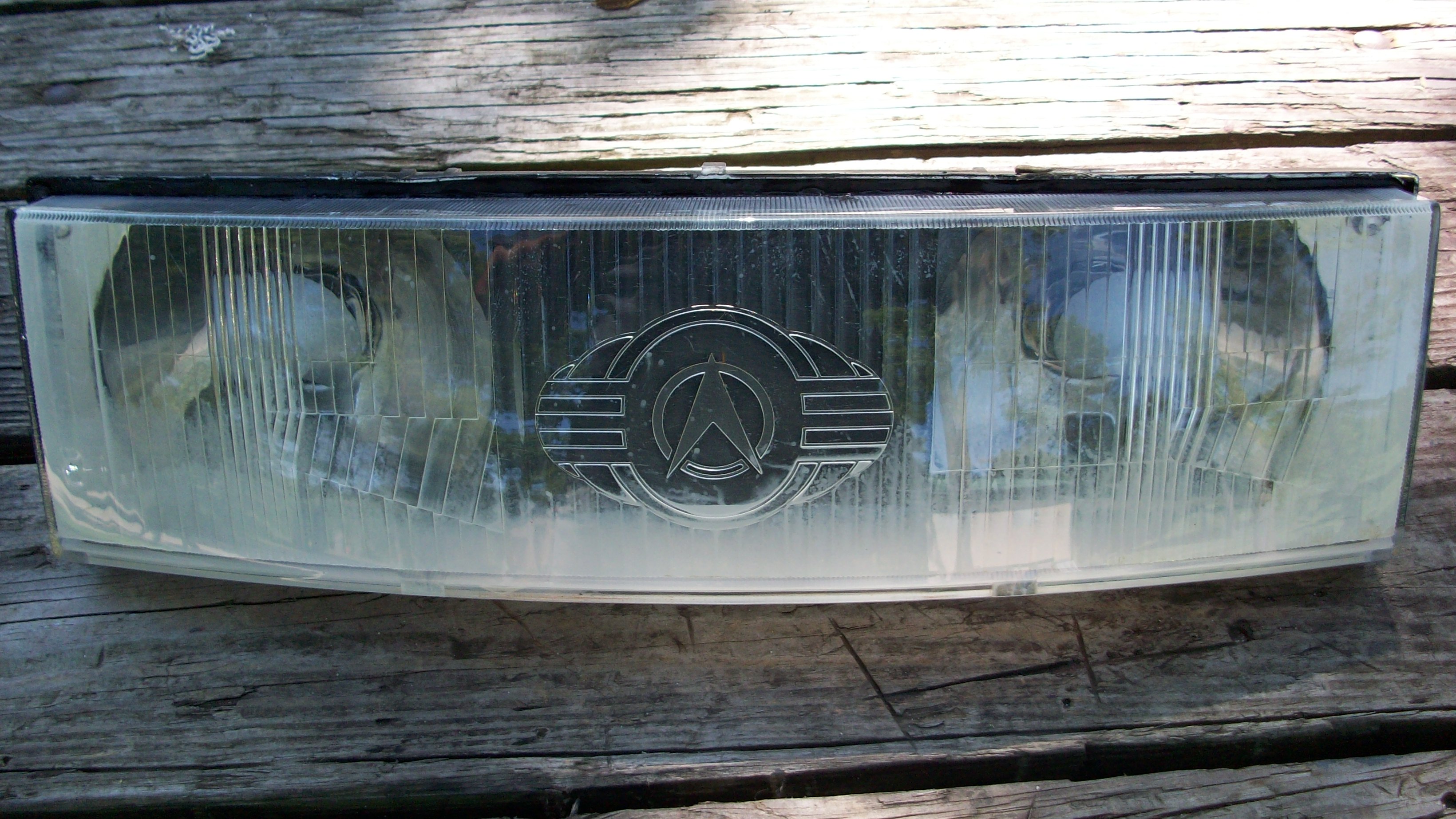

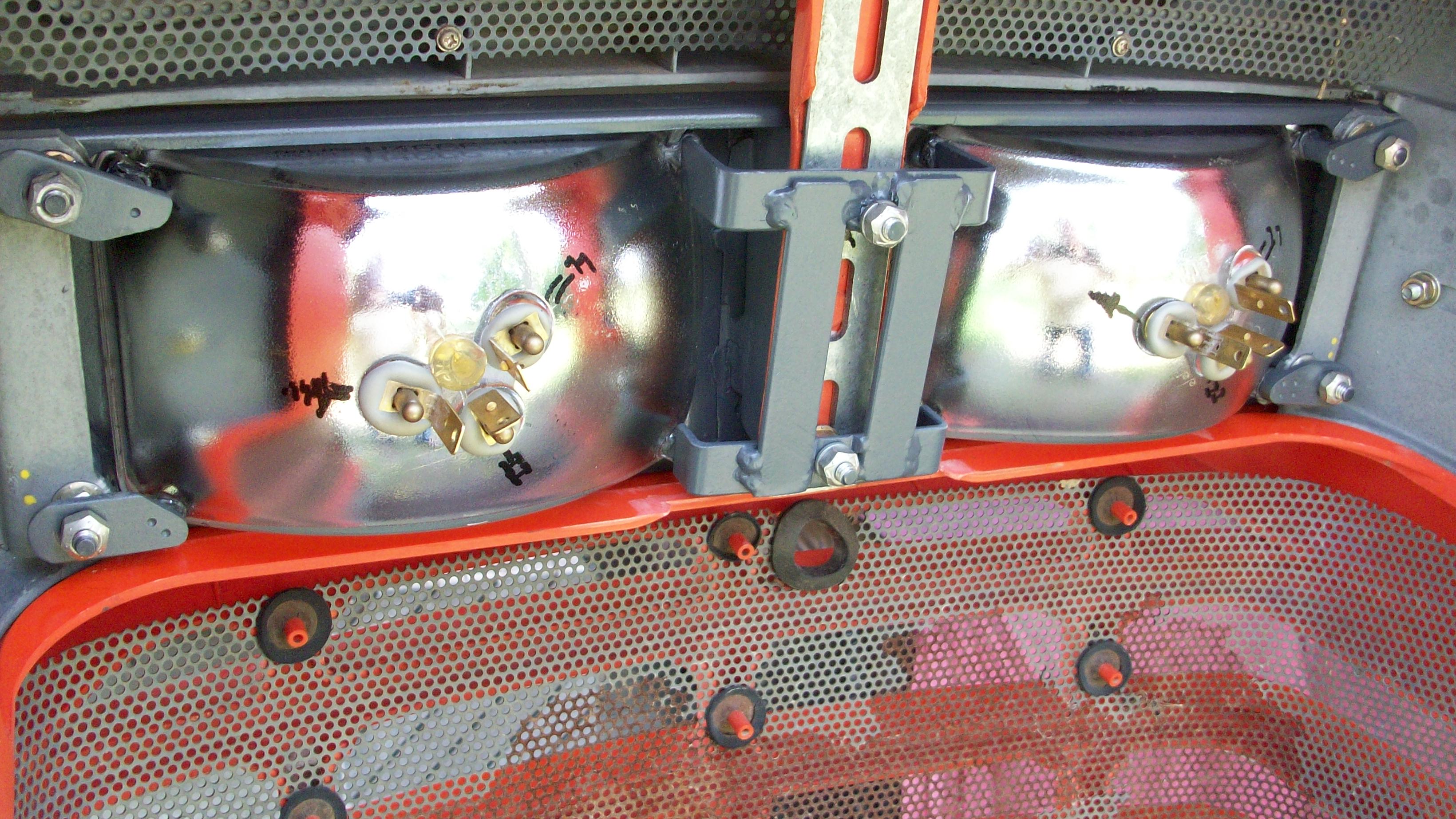

Plastic headlights have no place on a tractor IMHO. Mine had gone from condensation to a permanent haze so I thought that I would convert to sealed beam glass units that have no way for moisture to enter. H4666 & H4668 lights are the perfect size and have HI/LO filaments. I chose to fab up a mount with metal pieces that I had lying around but, I'm sure there are many other ways since they can be installed fixed at a slight down angle with no need for adjustment.
