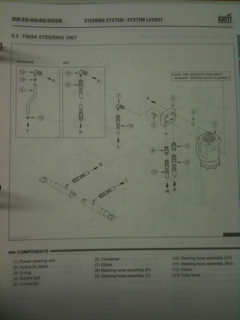

Steering system is tied in to the main tractor hydraulics. I cannot find reference to a bleeder screw/valve in any of the fairly detailed exploded diagrams.
   / DK35SE steering problem....any ideas? #6
Not sure if this iPhone photo is useful. Let me know if there is a specific diagram that would help.

Thanks for the suggestions but no luck so far. I took the cover off of the steering column and have traced the lines from the valve block assembly to the steering cylinder. Definitely no leaks or apparent damage anywhere. If I lift the front of the tractor off the ground with the loader, the wheels will turn. When they're on the ground the they will intermittently turn.
Am I remembering correctly that when the wheel is turned to full lock there should be a hard stop and you can't turn the wheel any farther? I can spin the wheel indefinitely in either direction.
Anyone know anything about tearing down and / or repairing the steering valve assembly?
