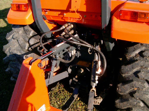

No on the mid PTO, yes on the remotes. You want 2 pairs so a total of 4 plugs on the rear. This will allow top and tilt. I wish I had the remotes, never missed the midpto which will reduce ground clearance in the rear.
   / DK35: Options: Why would I need them? #8
I have the mid PTO on my DK 35 and have never used it in 6 years of ownership.
I use my DK for mowing, but run a 3 point rear finish mower and never needed the mid PTO.
I have the 2 sets of rear remotes.These are used often with my hydraulic top link and tilt cylinders. ( Once you use a hydraulic top link you will never want to be without one again)
