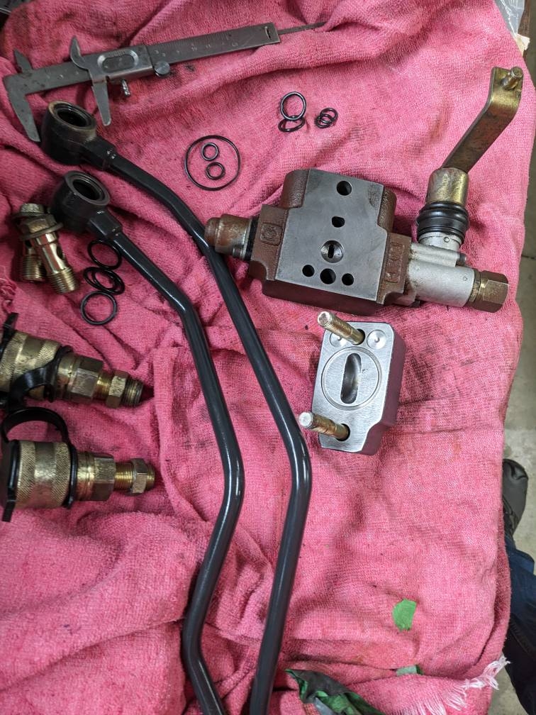

I had no experience working on hydraulics but I decided to try to repair it on my own. I decided to describe the process here in case someone else is interested.
From what I read, I would likely have to remove the fender and maybe the rear tire. I did not have to do either. I did have to remove the seat and plate it is bolted to in order to access the valve. The rear remote valve is sandwiched between the tractor block and a cover and held in place with two bolts. If you have two remotes it would be cover - valve - valve - block and longer bolts. Very straightforward.
Based on wise advice from PTSG above, I removed the tubes between the valve and the rear connectors and the R-pin holding the control handle linkage on. I removed the two bolts and both pieces came out easily. I found that the large o-rings on the cover was pinched, likely because it was not the right size - dealer error seven years ago.
I lightly sanded the four mating surfaces with 400 grit and then polished with 600 grit as there was some rust between them. I replaced the o-rings with new ones from my local transmission shop and bolted it all back together. I could not find torque specifications so I tightened it with a 14mm wrench as hard as I could with its short length.
No drips so it appears to be problem solved! I wonder if I should spray paint everything as it was at the factory in order to seal the seams and keep moisture out????
Peter

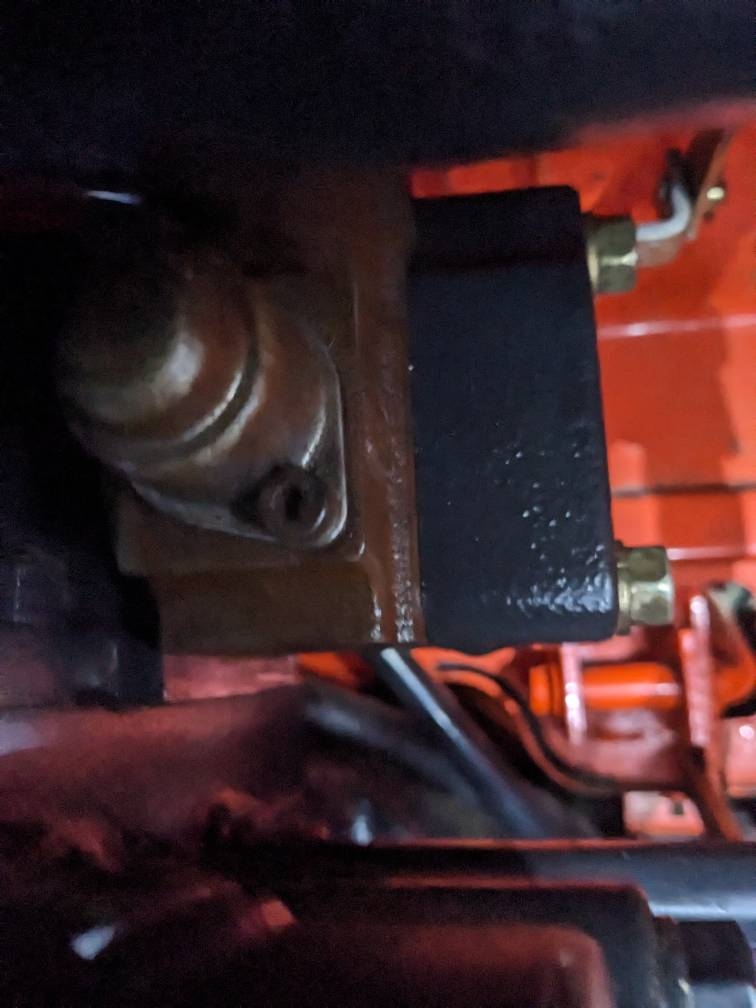

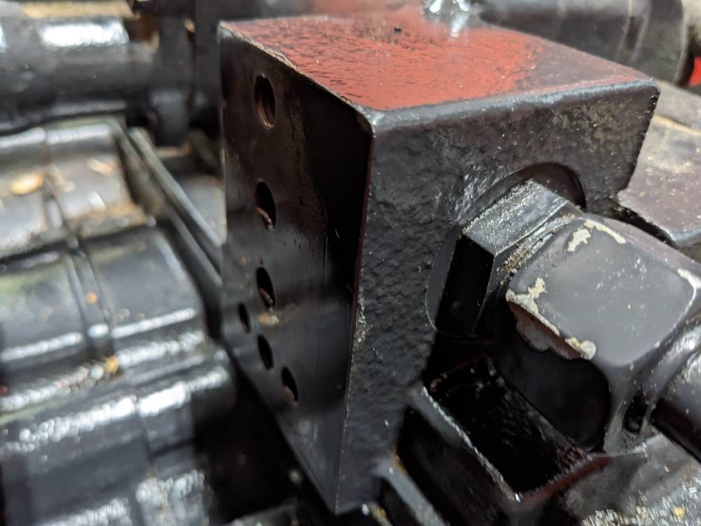

View attachment 825607View attachment 825608View attachment 825609
   / DK Rear remote leak #6
Thanks for the update. I'm glad you it solved and it was a cheap fix, just required a little bit of labor. Looks like the pictures didn't load properly, unfortunatly.
I like your old school vernier calipers. I have one just like that somewhere.
Old school calipers? Humph! I resemble that remark. Not sure what happened to the other photos so here is one of what I called the block.
