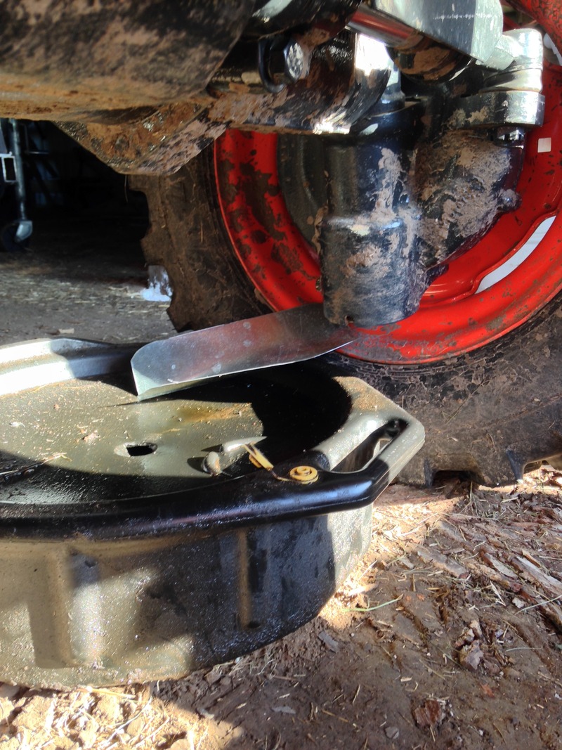

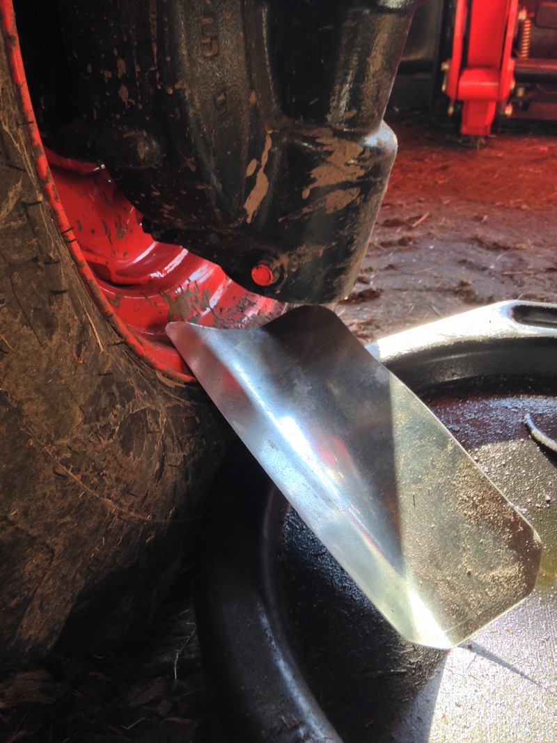

Spot on above. No need to take your wheels off, I fashioned a little catch / diverter out of a piece of metal flashing in about two minutes. It lays on my drain pan and catches the fluid, no mess, no spills ezpz.

Yes, I forgot about that one. Below is the simple little thing I fashioned to catch the fluid. Works perfect ( the fluid doesn't rush out, just drops straight down). I need to clean my tractor.
