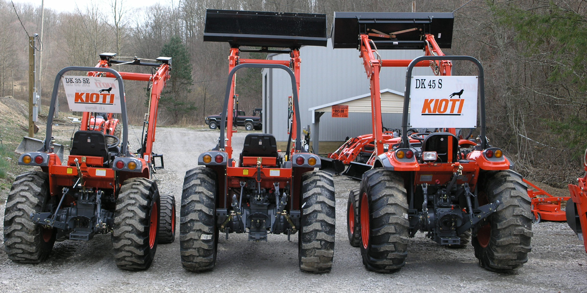

   / DK-40 HST OR DK-45 HST #7
The 40SE and 45SE are the same machine.
I just double-checked and the rear axle, rear axle case and trans case are the same part #'s
These parts would determine the width.
Engine size is the only real difference.
They also use the same size tires.
I think they have a typo.
The DK40SE uses the same loader as the DK45SE.
The pic below is a DK35SE-DK45SE and a DK45S
Sorry they are a bit dirty, we put down 75 tons of 304's and everything is "grey" now.
I need to put the 35-40 and 45SE's side by side now.
Like what others have said though....lot's of things come into play.
If you think you'll need the extra HP better get the 45SE
BTI
BTI, Thanks for the pics. I don't think i need a 45 horse i used to have a farmtrac 360 dtc that had 36 so i would like to stay around the 40 horse range. If it's only $1,400 more for the 45 horsepower I think i will go that route. If it was 2 or 3 more i would just stick with the 40. Thanks for the info
