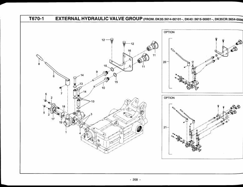

Got Spring Fever today and fired up the DK 35. Engine started like a champ after sitting all winter (TN). Much to my dismay found a lot of hydraulic fluid leaking right above the filter. It is leaking so badly that fluid is coming in thru the opening for the differential lock and puddling on the floor. Any hints/suggestions would be greatly appreciated.

Found the leak to be related to the remote hydraulic control. When in neutral there is just a small drip. If leaver is moved either to the A or B position the fluid shoots out under a lot of pressure and volume. Something must have let go in the control valve box. Filter was changed and that was not the problem. Doudius Transpirus (S,,,,Happens) Thanks for all the input.

Great. That will proably be an easy fix. Most likely just a loose connector or an O ring that got tightened too far. I think that connection has an O ring, can't remember.

Likely an O ring or fitting leaking.
Here is a parts/breakdown of the remotes for a DK 35
