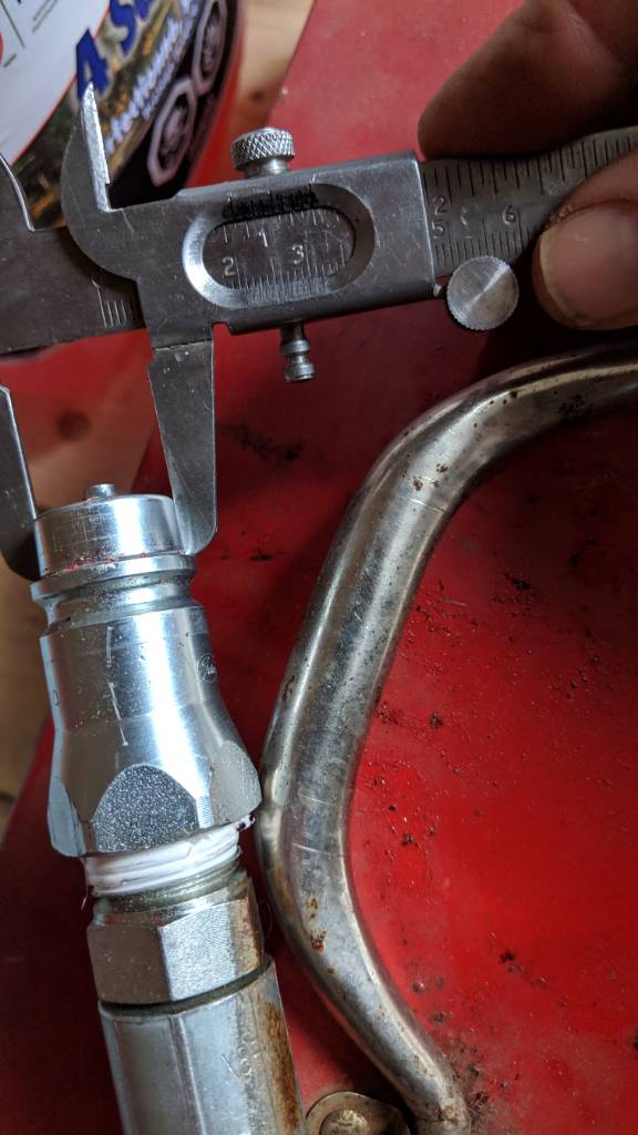

Hi,
I'm away and wanted to buy some hoses and fittings for the rear remotes on my DK4210SE Cab(New Model) with 16GPM flow, does anyone know right off the top of their head what size these fittings are (ex:NPT thread coupling fitting size?) not sure it's the same as the CK model as the DK has a much higher Hydraulic flow, thanks!

No one has answered so I can share what my 2016 DK5010 (older model) uses. Attached is a photo of one of my implement hoses. Silly me, I measured the very end at 13/16". I should have measured the wider flange but I estimate it is a 1" connector - I am not near the tractor. This does not exactly provide confidence but it is a start. IMG_20190427_125302.jpg
   / DK 10SE rear remote size #3
I could be wrong especially WRT the newer models, but I believe all Kioti rear remotes are 1/2 inch Pioneer-style agricultural quick couplers. Mine are.

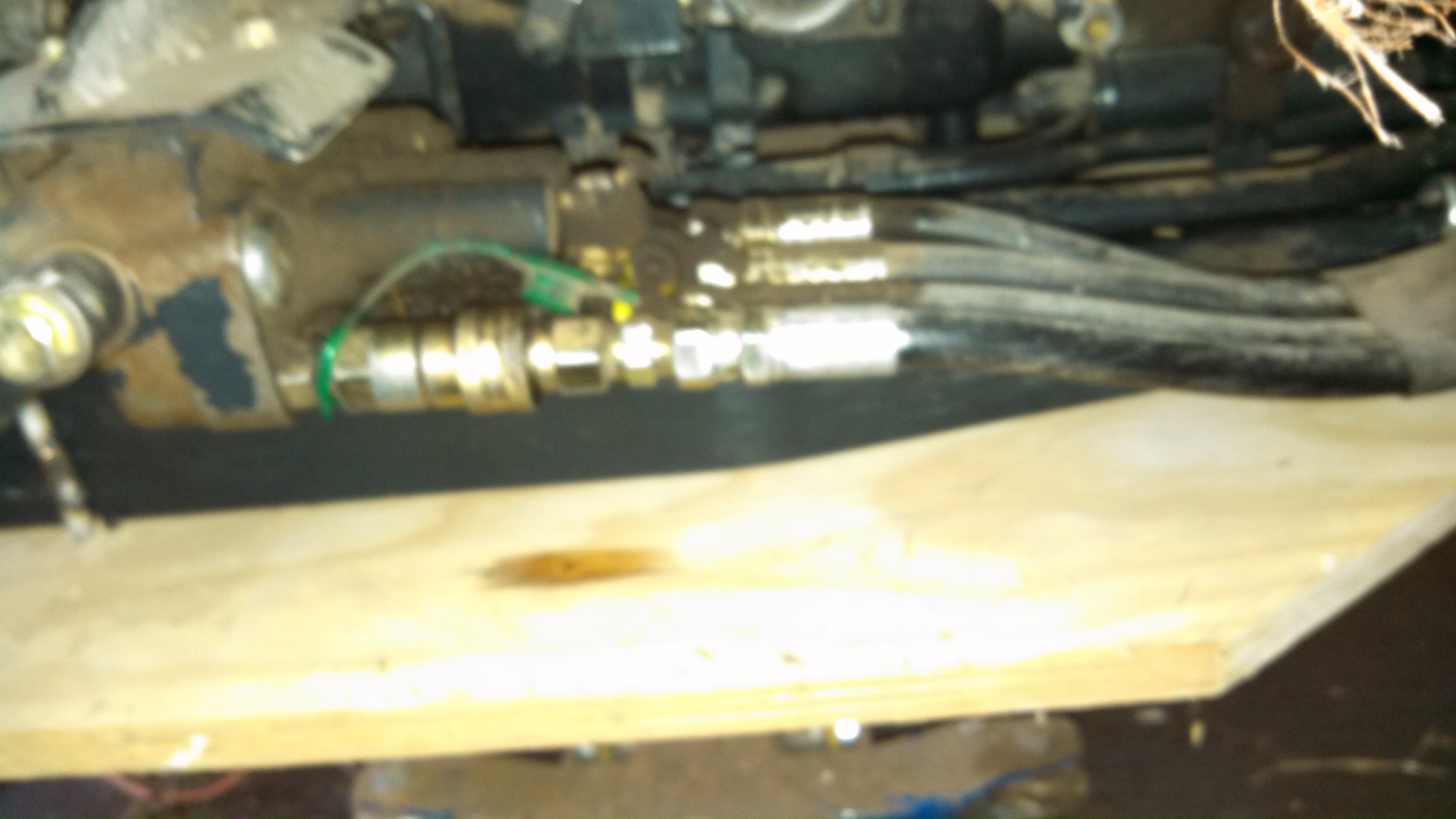

On my DK45se the rear are 1/2 inch pioneer type and the front loader are 3/8 inIMG_20160319_165017_776.jpg
