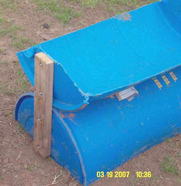

I have been intending to build some more feed troughs out of plastic 55 gal drums but couldn't decide on a design. The last ones were too labor and materials intensive.
Today I did.
I split a drum in half, lengthwise longways with a skill saw. It cuts easily so I did it to a second drum. I then split another drum in thirds lengthwise. I measured the circumference and marked the 1/3 points. There is a visible seam to use for a starting point. Next I cut some scrap pressure treat 2x4 into 20 inch lengths. It takes 2 pieces of wood per feeder. It takes 4 bolts to fasten each piece of wood.
The drum half is a base. The drum 1/3 is a trough. The base is concave downward and the trough, of course, is concave upward. The 2x4 goes at each end with two bolts into each piece of drum. You don't want the board to touch the ground as it will wick water and promote deterioration. I used fender washers against the plastic and regular washers against the 2x4. I used 1/4 inch bolts.
I pay $6 per 55 gal drum. They are about 1/4 inch thick plastic and very UV resistant. You could use drum halves for troughs but the capacity is excessive. If you prefer you can use steel at the ends in place of the pressure treat. I had the scrap pressure treat and reserve steel for other uses.
Considering the bolts, nuts, washers boards, drums, wear on the saw blade, electricity, and on and on I still can't imagine the cost per feeder running much over $10 each. I built three in about an hour or so, rinsed them out and put them to use. The heifers liked then just fine.
OH, I trimmed the "pointy" ends of the troughs nearly flush with the 2x4 so no one would "poke an eye out."
Anyway here is a couple pix of the super cheap troughs and a picture of customer satisfaction.

Nice job, Pat. That really is using your head to come up with that design. I especially like the full support the half-barrels give to the top trough barrel third. You may find that as the cows push down on the middle of the trough, the bottom barrels may bulge in the middle. a treated 2x4 on the inside with lag screws from the outside will eliminate any bulge. I bet your troughs will still be around when many more expensive ones have gone away. That idea is a "keeper."

do you drill holes in the bottom to keep them from collecting rain water? or do the cows drink it up/doesnt matter?
   / DIY troughs
Thanks for the comments, guys. I know about fire (heat) polishing cut edges but didn't think the fashion police come this far out and the cattle sure don't care.
Holes in the bottom large enough to not clog with debris from the feed will let pelletized corn gluten and soy hulls fall through onto the ground. Rain water does collect but the troughs only have feed in them for a few minutes so if you empty the troughs (real easy) and then put the feed in it is eaten before draining is an issue.
In winter they fill with some ice and snow but you can put the feed on top of that and it doesn't matter. If they get too full of ice, just roll them over and the ice falls out since the plastic is super smooth.
The largest members of the herd (and most of the rest) have stepped in the troughs and it just doesn't matter. When I made them I tried to get maximum contact between the 1/3 and 1/2 pieces. Unless I get some stock that does an Irish traditional dance routine in a trough I don't think any reinforcement will ever be required. Some have been in service for a few months some less. None show wear or distortion.
I don't think a chainsaw could be used to safely cut the drums any faster than I can do it with a skill saw. I don't like to single hand a chainsaw to cut something I am holding in the other hand and I use one hand to hold the drum. Anyway it takes me less than a minute to cut a drum in half and not much more to cut in thirds so the hassle and risk of a chainsaw to try to shave a couple seconds off my build time is not too attractive of a proposition.
So far the only down side is high wind can blow them over and scatter them a bit. I could connect them in groups by running a long bolt through the boards at the ends of pairs to hook them together. I could turn them upside down and attach some heavy wire mesh inside the 1/2 drums to act as reinforcement for about 5 gallons of concrete or run a rod through the 1/2 drum which would skewer a couple cinder blocks. That would stop the wind from tipping them over or blowing them around. Also keep the animals from over turning them which might happen but not witnessed so far. These troughs are only used when feeding supplementally and in a few weeks the herd will be on all grass with some mineral supplement and salt blocks.
Pat
