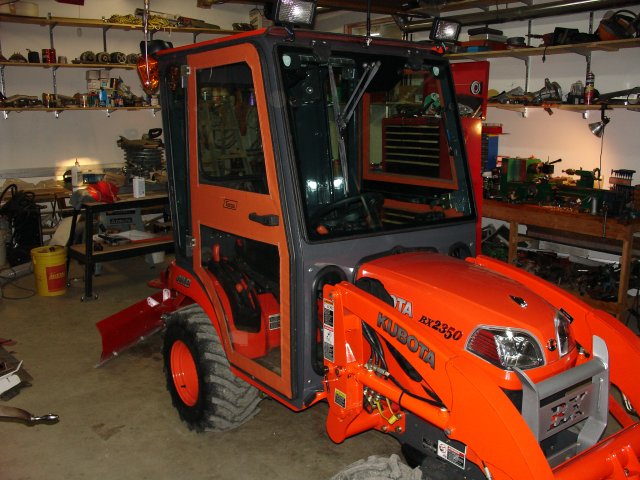

   / DIY Tractor Cab - Best materials and practices #6
You can also use a old soft cab and modify it like I have done with a Curtis.
Good luck with your project and have fun ;) .
Dam Skippy that looks nice! :cool:
