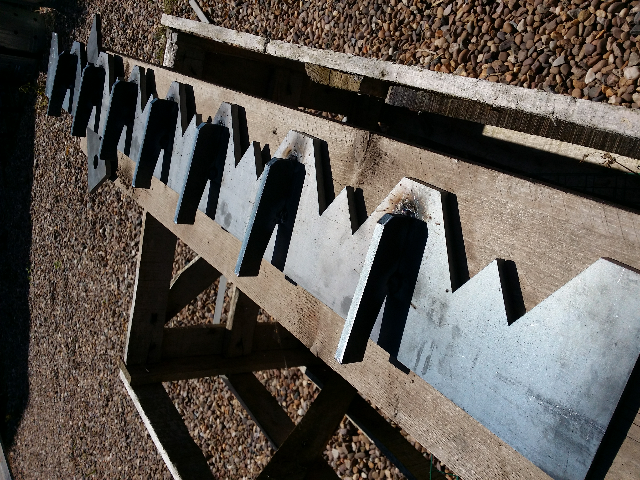

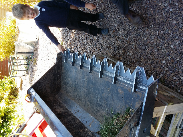

Hello,

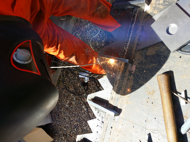

I have made a tooth bar using steel. I had it laser cut for ease and then welded it up on the bucket to ensure it fitted.
Nothing difficult and it is rough and ready but it will do the job.
Welded some hooks onto the front at the same time.
I'm sure you've seen the same design before and it's just a variation on the theme.
Does the job.
Thanks.

How much was it for the laser cutting?
   / DIY Toothbar Yanmar 1610d
It was 」60 for the steel and laser cutting of one large toothbar, 2 side brackets, 2 spacer pieces and 9 wedge brackets that are along the bucket lip.
That is for 10mm steel.
Once welded up it was ground down to a sharper edge on the teeth and now it just needs a paint and a test.
The soil is very hard clay here so my little tractor needs a bit of help breaking it up.
Thanks.
