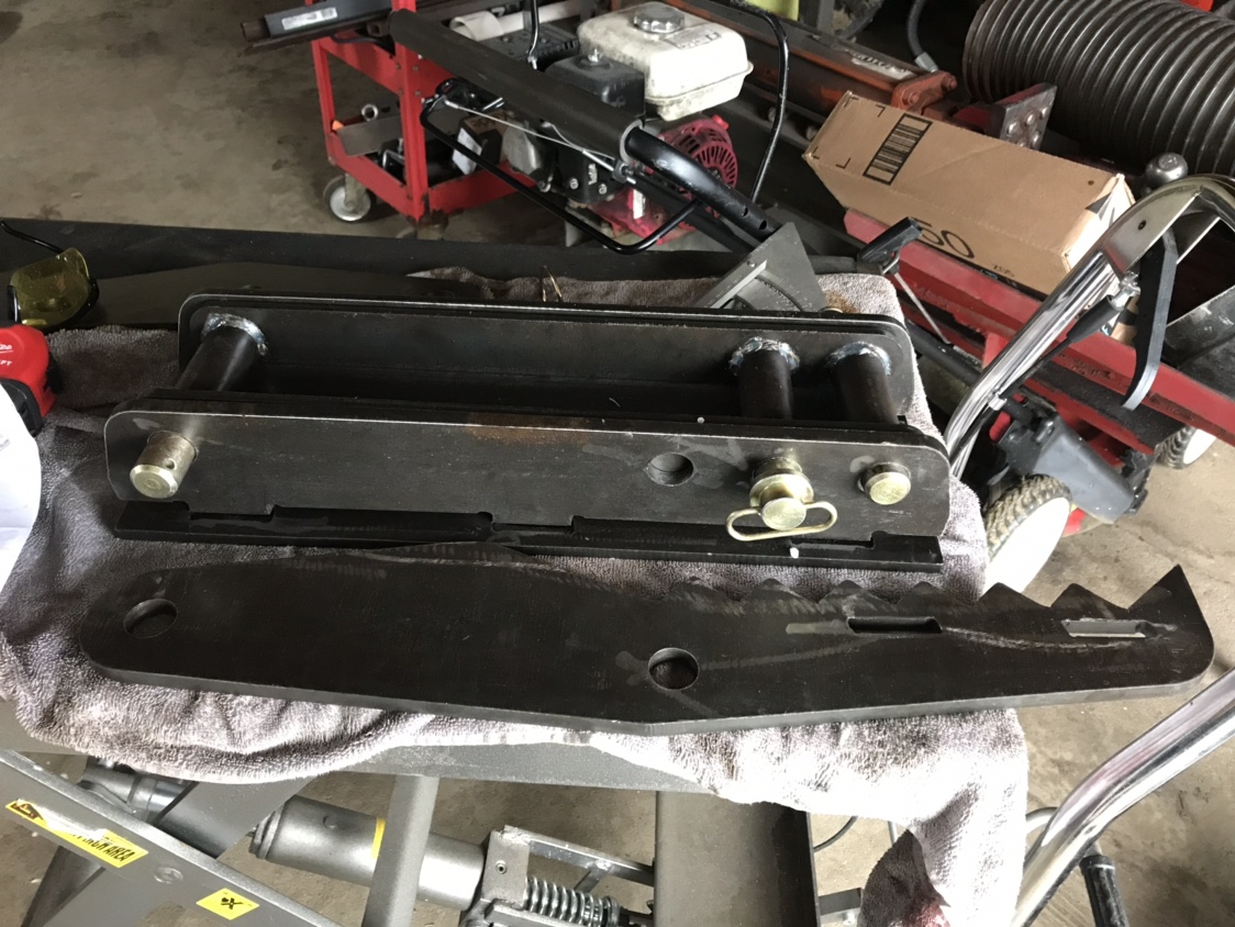

After starting to make a thumb for my Woods 7500, I noticed that Titan had a weld it kit for a 24” pin type. For 140 bucks. Hard to buy the metal for much less.
DIY 24" Weld On Backhoe Thumb Hoe Clamp .5" Steel Plate Assembly CNC Plasma Cut
It came in a sturdy well wrapped package. That was heavy at 60 lbs.
1/4” steel throughout and the holes were close enough with a little grinding to be done to mate everything up properly. Chinese tolerances you know.
Then I noticed that no matter which way I Tried to do it, it wouldn’t fold down to the boom.
The geometry appears wrong in the hole placements.
In the above picture, the backbone is laying down on its back, the brace is inside and one jaw close toward camera.
The three holes are aligned in the backbone and brace have pins in them. The one hole toward the middle does not have a corresponding hole in the brace inside the backbone.

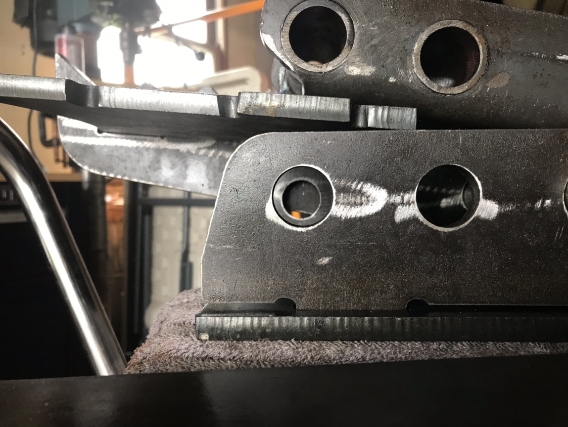

The two holes line up in the jaw and backbone but not the brace.
Trying to fold it together the way you would think leaves two end holes blocked by the jaws not allowing a pin to be inserted for storage.
This shows the jaw on the far side blocking the two holes in the backbone. With the brace ready to fold down inside.
The easiest way to get something that will fold up to me is to drill two holes in the brace to mate with the middle set holes in the jaws and backbone I think.IMG_0464.jpg

I got one of the Titan thumbs too.
You’re right. The holes don’t line up so that it can be folded up. Its a stupid design. I don’t know what the second hole in the support arm is even for.
This is what I did to solve the “storage” problem.
Since this thumb is actually too heavy for a tractor backhoe, I am planning on welding up a separate storage location on the backhoe to pin the thumb pieces onto to take the weight off the dipper when I want to dig a trench or something.

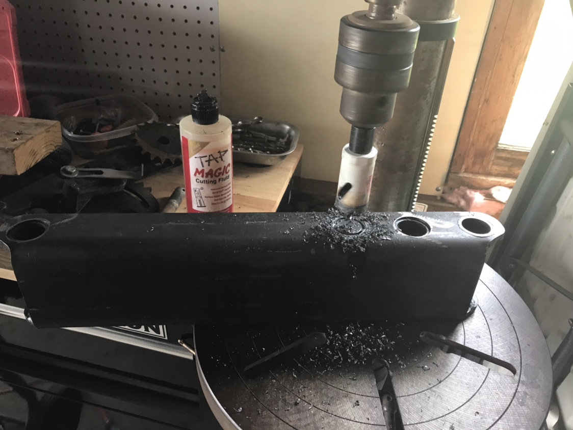

I did go ahead and drill that third hole. In retrospect I should have moved it over more and had the brace offset from the hinge so the thumb didn’t have to be detached to get the brace off the same pin.
Oh well. It should only be moved occasionally for me as a homeowner not working commercially.

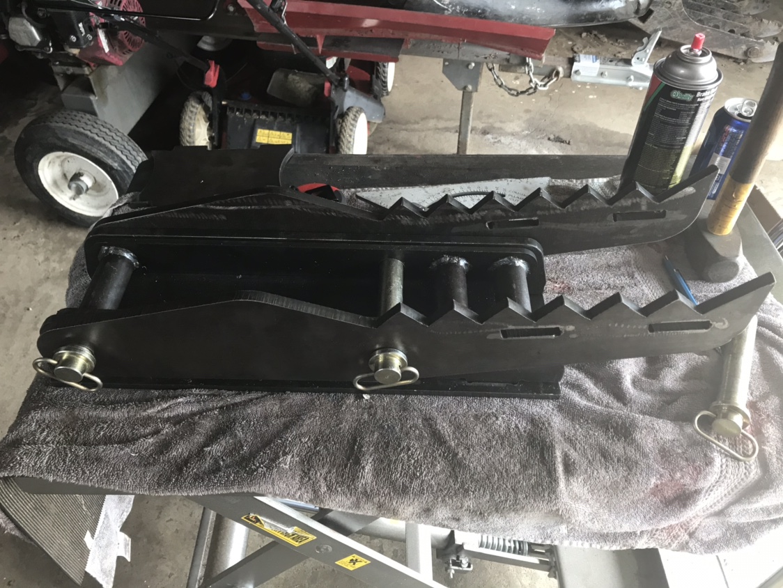

Here’s where I am tonight. Going to sleep on it before welding it all together.
   / DIY thumb for backhoe #6
Well, it looks very substantial. A thumb is a must-have, IMO.
