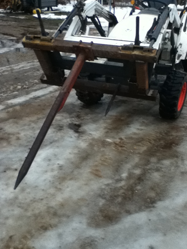

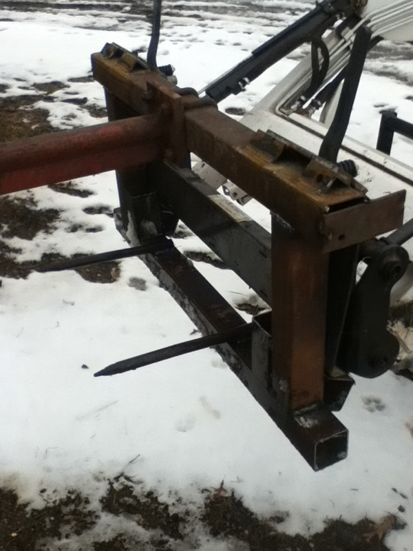

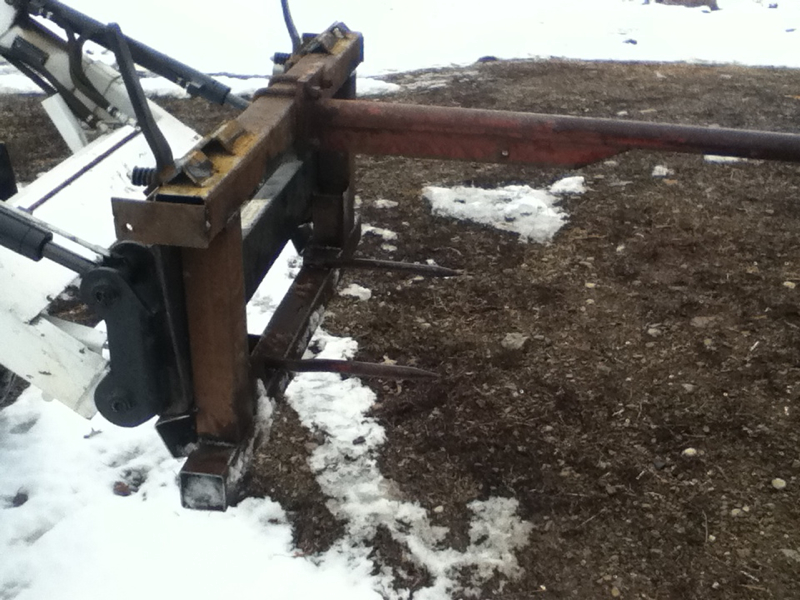

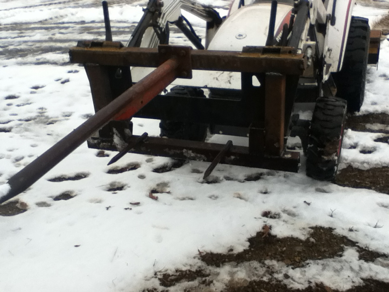

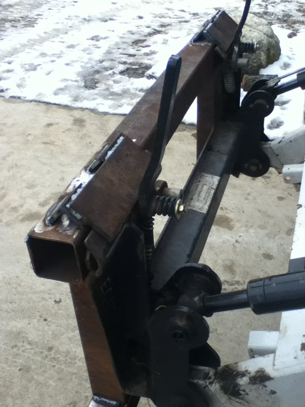

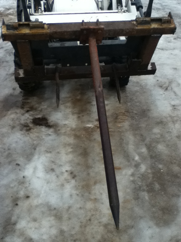

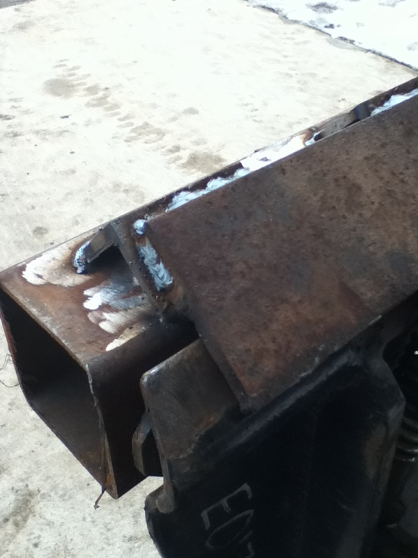

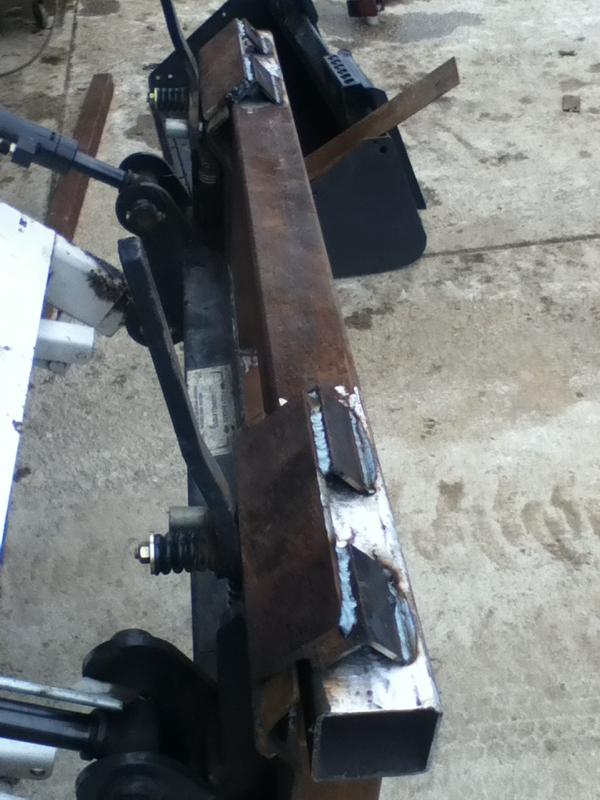

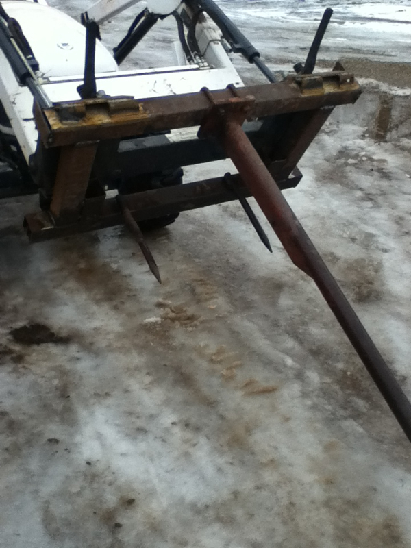

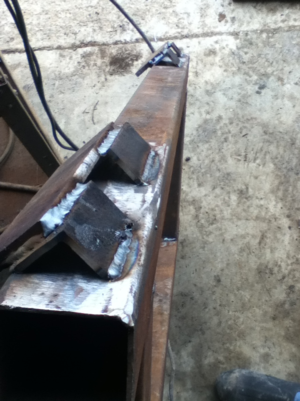

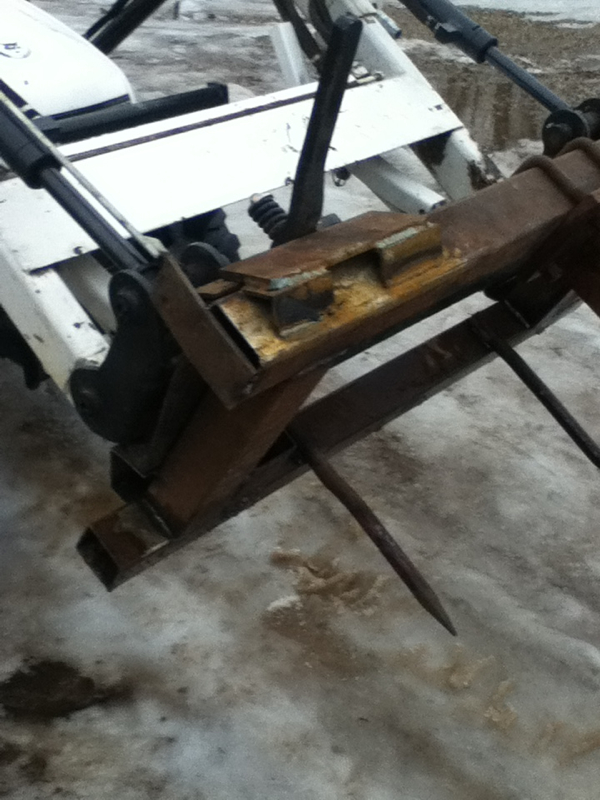

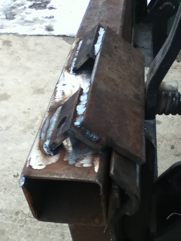

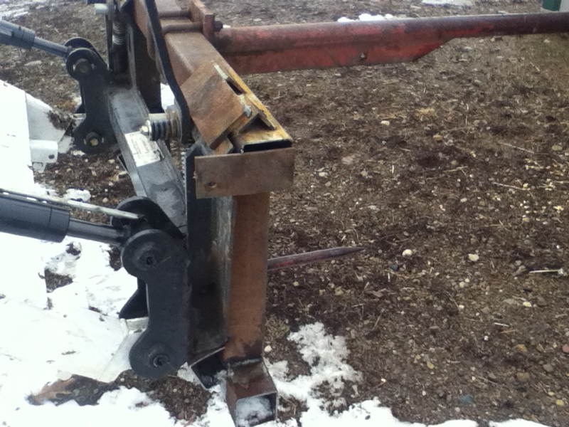

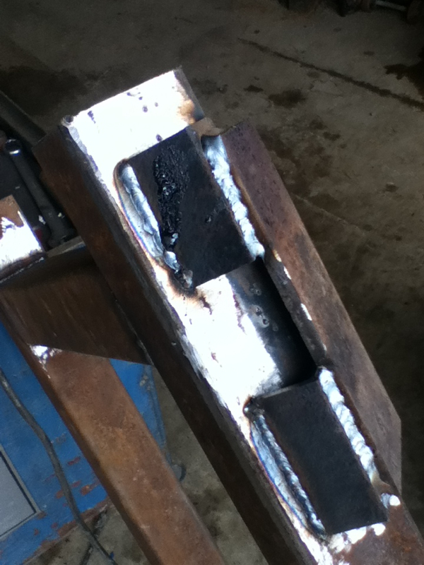

Coming spring time i got a few new attachments to build for some jobs, so I thought I would build my own SSQA plates, I started my first with 3in square tubing as I have abundance of. This is just kind of a test one. I decided to make a bale spear so It would be a good test for strength. Here's some pictures, all I used to build it was 4 1/2 grinder with cut off wheel, chop saw, and wire welder. the next attachment will be a hydraulic post puller, scraper, and a Converted blade.
I quickly added some side plates so its easy to grab and center it.
Also going to add a 3rd center upright.
