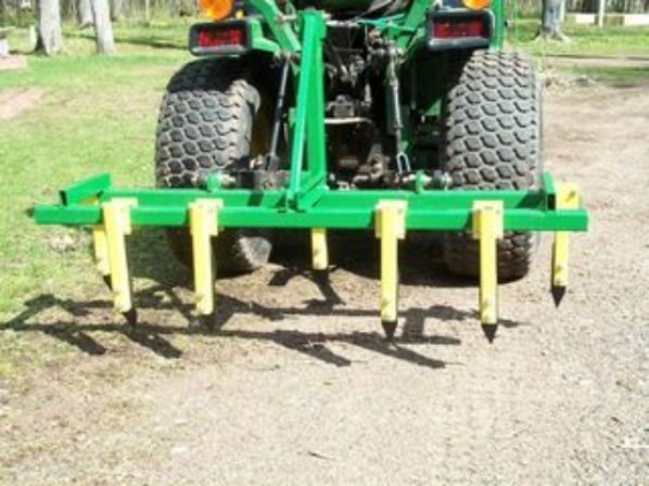

If I can get the picture to attach... Here is the homemade 3pt, cat 1 size, 5' wide tool bar I built...
I have loaded it with as many as 21 chisel toot diggers, spaced it to cultivate row crops, one or two row hillers, up to 4 bottom disk plow, two to five pasture renovator type ripper shanks, or a 5' wide de-thatching type rake..
I have used it for a lot of things.. Tilling for wildlife food plots, leveling ground, maintaining gravel roads, cultivating row crops, garden work, and other tasks..
Good luck..

awesome,Wyobuckaroo!already getting ideas.if i may ask,is the 3pt mount sturdy enough to handle 3 chisel root diggers that go 2ft into the soil?
