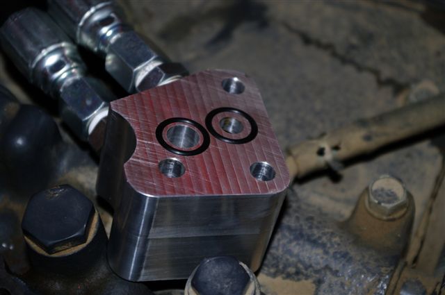

I am hoping that someone out there can help me out. I have a Kubota L3430. Last year on this forum I found a terrific description of how to build your own adaptor plate that installs in the location where Kubota uses for the optional rear remotes.
I have been looking for this description for the past couple of days now without success. (I gave the printout to my first machinist who moved, and now found another who is willing to build the plate for me.)
From what I remember, the description involved tig welding a couple of nipples into the metal block and running an in- and an out- hose to the rear of the tractor where they connected together with quick connects to form a loop. When you needed to run your implement (in my case a cement mixer dump cylinder), you simply split the loop and ran hoses to your implement.
This simple solution would work the best for my situation and I am hoping that someone remembers the post that I am talking about and can send it to me or attach it here. Thanks, Bob

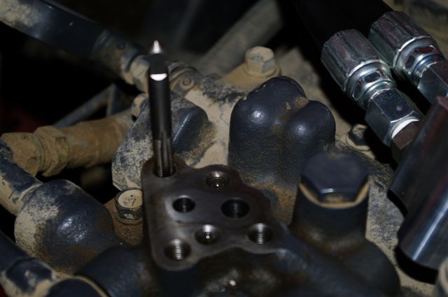

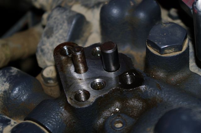

Thanks Kennyd, I thought maybe I was going more crazy. Lets see....I know that the adapter plate that he made was out of aluminum, and so he tig welded the nipples in. I think the nipples were NPT threads? He had to engrave o-ring channels around the two (inlet, outlet) ports on the adapter plate. And the two hydraulic hoses stuck out the rear of the tractor where you would normally have the remotes, except he used a male and female quick connect to hook them together when no implement was being used (to keep the fluid "loop" flowing). Plus, I think he might have had a couple pictures attached to the post...because I remember seeing a pic of the outlet hose, elbow, female QC, male QC, elbow, and then the inlet hose disappearing back under the seat. Oh...and he did this on a Kubota.
