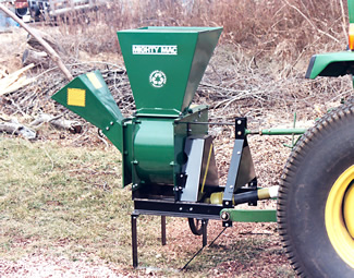

I've seen 2 or 3 gas powered wood chippers in the 8hp range or better converted with the motor removed and a PTO interface added on youtube. Howbeit, those were done in eastern Europe where things are like a wild bizarre type of a zombie looking machine. Then there was the guy in NC who did his own clean welding, clean painted making it looked very professional.
With all that said, anyone ever take a wood chipper, drop out the wimpy or dead motor and make it powered by a PTO from a CUT type tractor? Got some images to post too?
It seems that I can pick up an 8hp wood chipper off of Craigslist for under $300 any day of the week and make a conversion. PTO driven types usually cost big bucks. One thing I do notice about self powered chippers vs. PTO, the self powered usually have 2 cutting blades and the PTO types have 3 mounted on the flying wheel. That's really not hard to do.

I've only had a TroyBilt Tomahawk (8 hp), MacKissic for the Gravely (no chipper, only hammers) and now a PTO MacKissic the last 14 years. The Tomahawk is basically the same machine as the MacKissic and is actually heavier construction than the TPH-122 PTO unit but has very whimpy spacers between the hammers. I you replaced the Tomahawk spacers with MacKissic ones, it would be a good unit to convert to PTO but the TPH-122 just wins hands down in being very easy to maintain. If you really want a PTO unit cheap, I'd look for a used TPH-122. It would be very easy to fix any problems on it.
