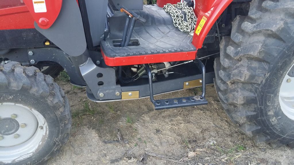

I bought a barely used Massefy Ferguson 1529 tractor earlier this year, with just 90 hours on it, from the local dealer. As I wanted to use it for firewood gathering here in northern Minnesota, I quickly discovered that a lot of vulnerable components and linkages are accessible from the underside of the tractor. I don't think I was but 10' out into the woods when I discovered the 1st piece of unwanted wood jammed up next to the brake linkage. Not good at all.
Having rock crawled my Jeep TJ over much of the desert southwest, I opted to make a skid plate for the 1529 using 6061 aluminum alloy. A complete write-up can be found on my web site.
Here is a pic of the completed skid plate installed on my MF 1529.

Not a 1529 owner but I have a massey. Very nice work. I need to make something similar.
have you bashed anything into it to see how it holds up?

Nice, that loader sub frame was just so handy it looks like it was intended or designed for that. Welcome to TBN Stu!

The reason I picked the 1/4" thick 6061 alloy is because of my previous experience using it as an auto tranny skid plate and also the gas tank skid plate on my Jeep Wrangler. I've had the entire weight of my Jeep, 4K+ pounds, sitting on those 6061 skid plates and they only had scratches on them. I've no doubt the skid on my Massey will keep brush and the occasional stump away from the vitals on my tractor. LOL!

Once I got under the tractor and scoped out the project, that was extactly the way I saw that sub frame.....it was like it was made for it, just waiting to have a skid plate bolted to it. ;)
