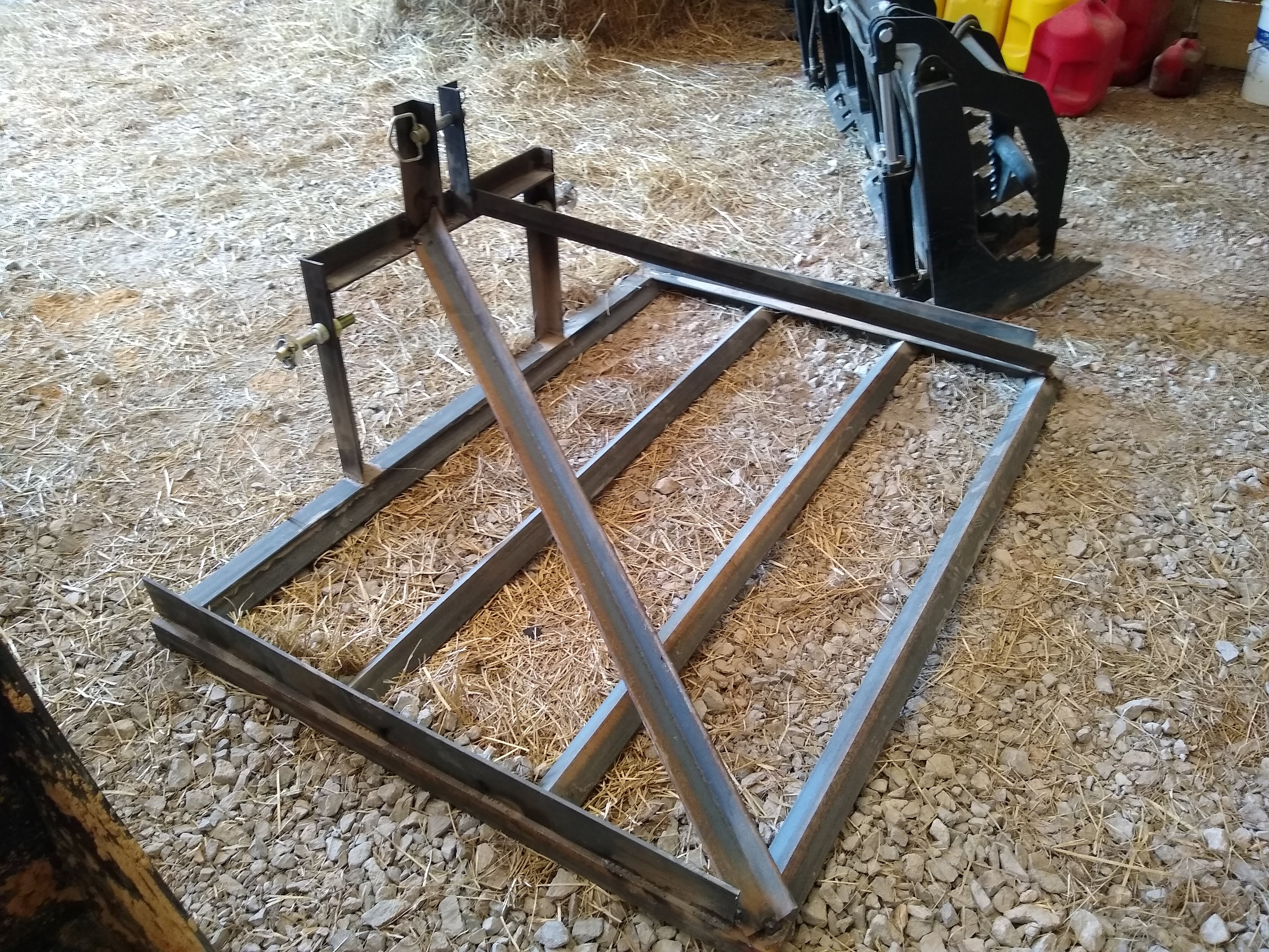

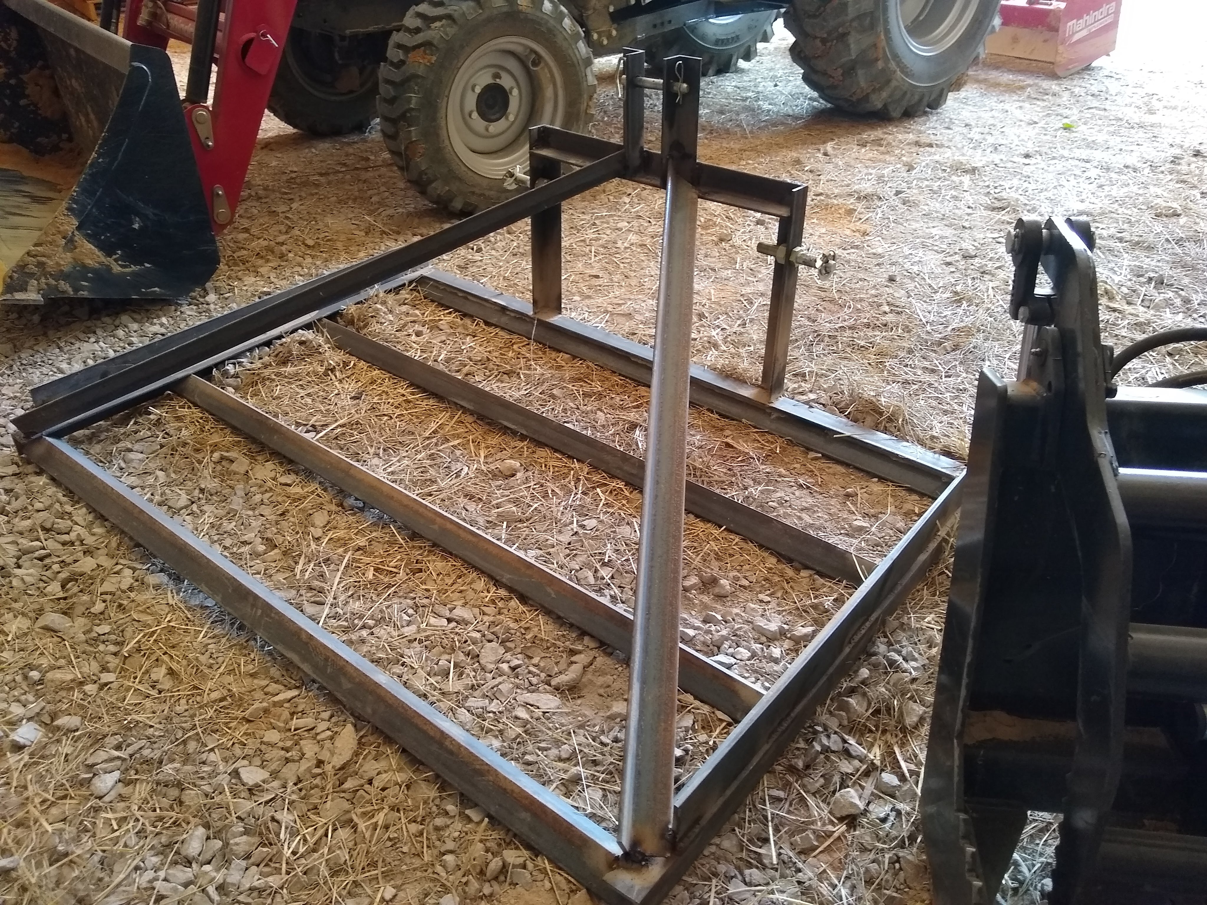

I decided to jump Full on into metal fabrication, I've always worked with wood but that just doesn't cut it with tractor attachments.
This is my first attempt at welding, It works well so far. We'll see how it holds up over time.
I may add an adapter to use with the front quick attach for better control.

Nice work but most land planes I have seen the cross bars are set at a slight angle to help move dirt but it should work anyways. let us know how well when you get it dirty.
   / DIY land leveler / land plane
This one is more like the skid steer style that mainly levels, it isn't meant to dig or scar the ground.
   / DIY land leveler / land plane #4
Looks good, the main thing I can see that might need some more reinforcement is the 3 point mounts, the angle for the top link may fold one way or the other over time if there is any elevation change, and I'm pretty sure the lower link pins are going to twist the angle iron judging by the equipment I have that has been acquired used and home made...

Being that 3pt has no down pressure, you may want to add pockets for concrete blocks or other weight.

Looks like it should a decent job of leveling. I壇 suggest putting a radius on or at least grind the corners off the 90 degree angle cuts to get rid of the sharp corners. Those pointy corners tend to catch things and can cause nasty cuts if someone falls on them.
