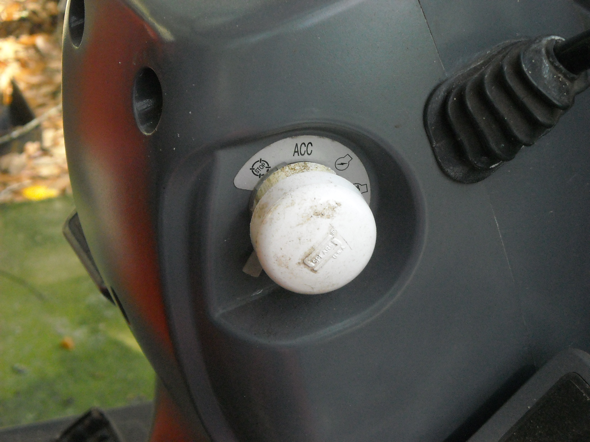

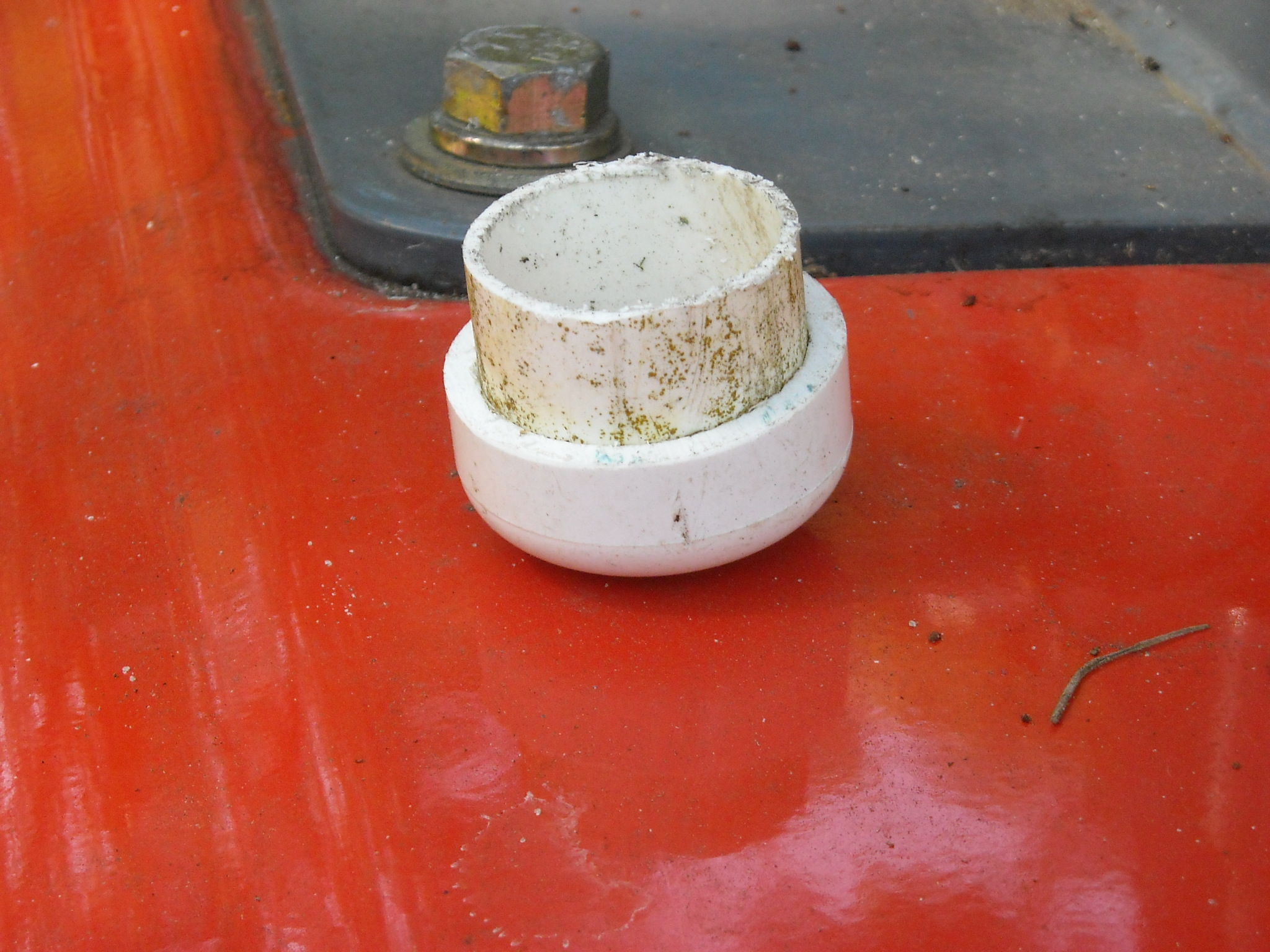

001.JPG002.JPG I have read alot of posts concerning water getting into ignition switch, I have come up with a simple solution to keep the rain water out if yours stays outside. It consists of a 1" pvc pressure cap and a short piece of 1" Thin Wall Pipe.
This fits snugly on my 2008 DK35, hope it works for you as well.

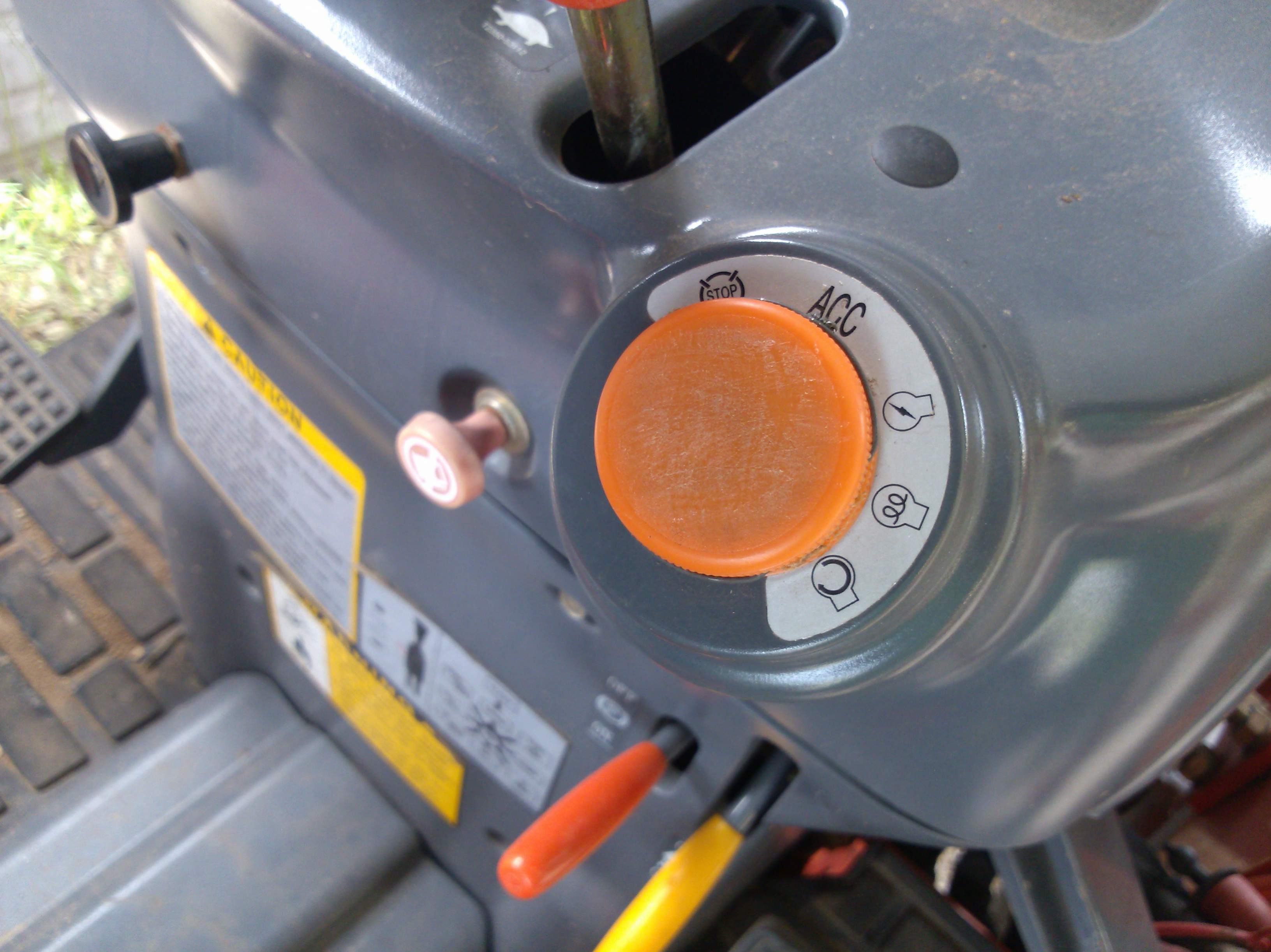

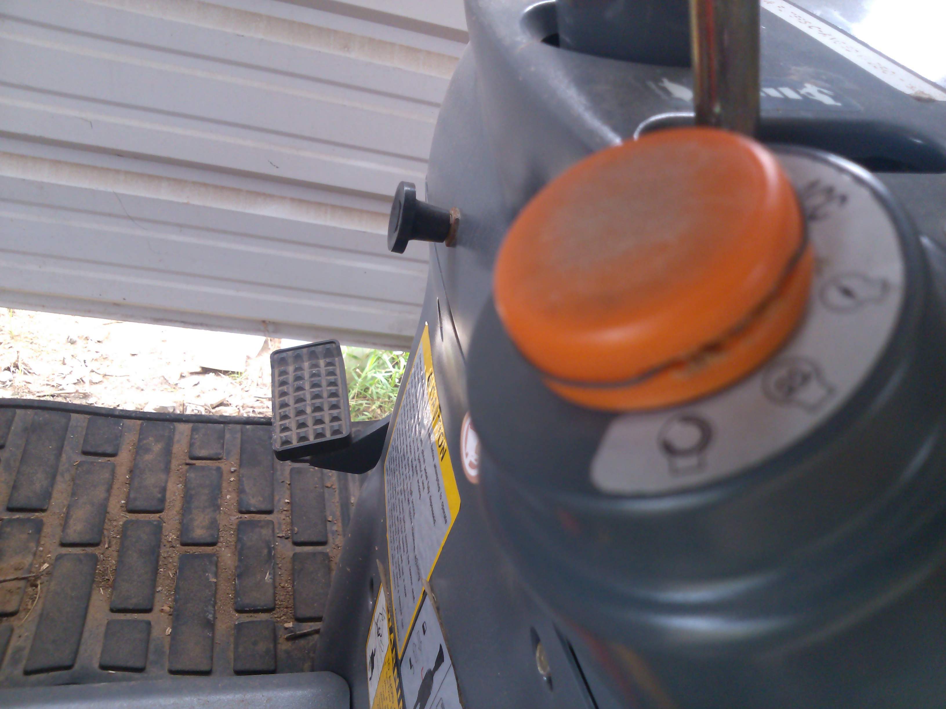

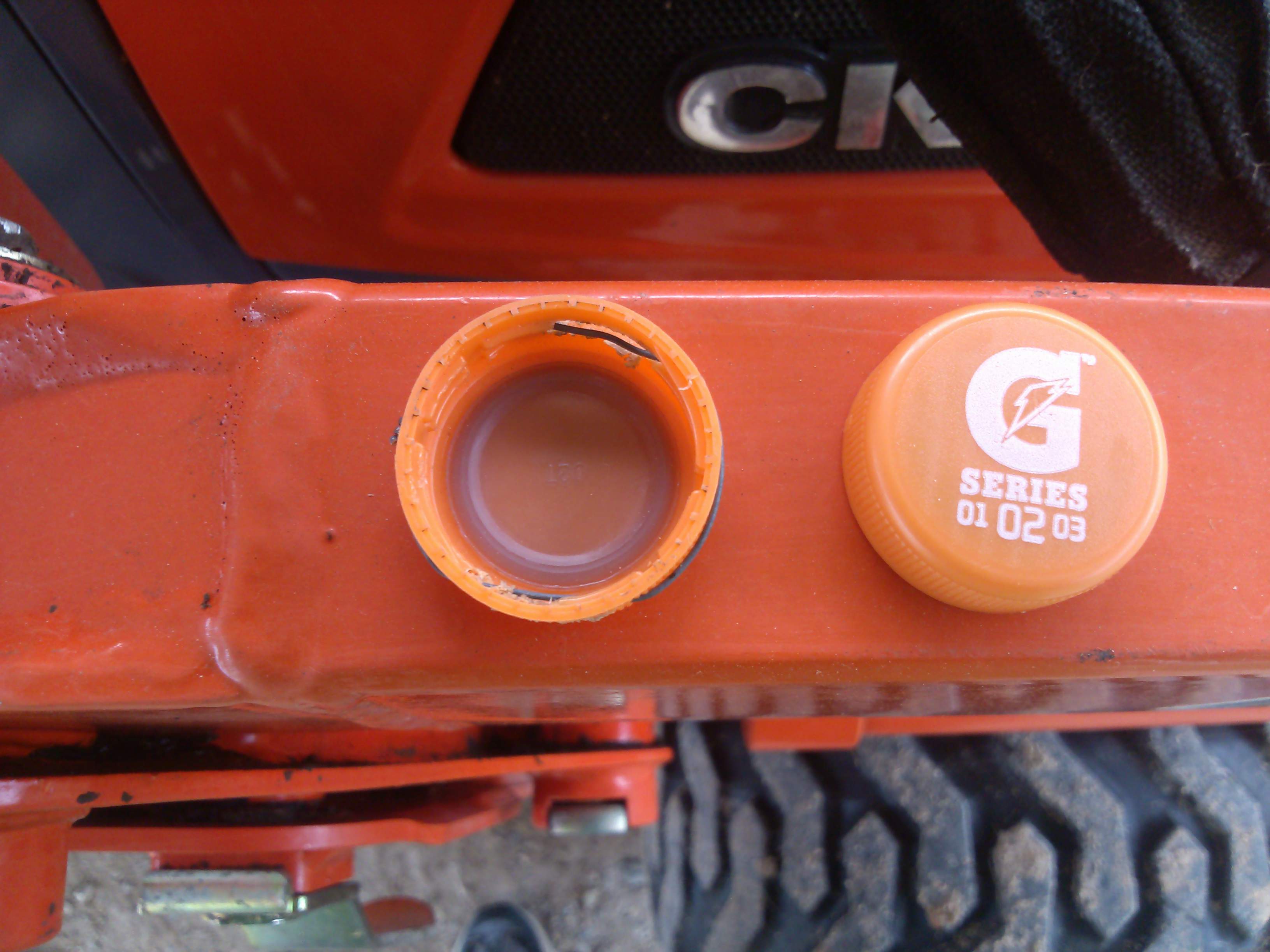

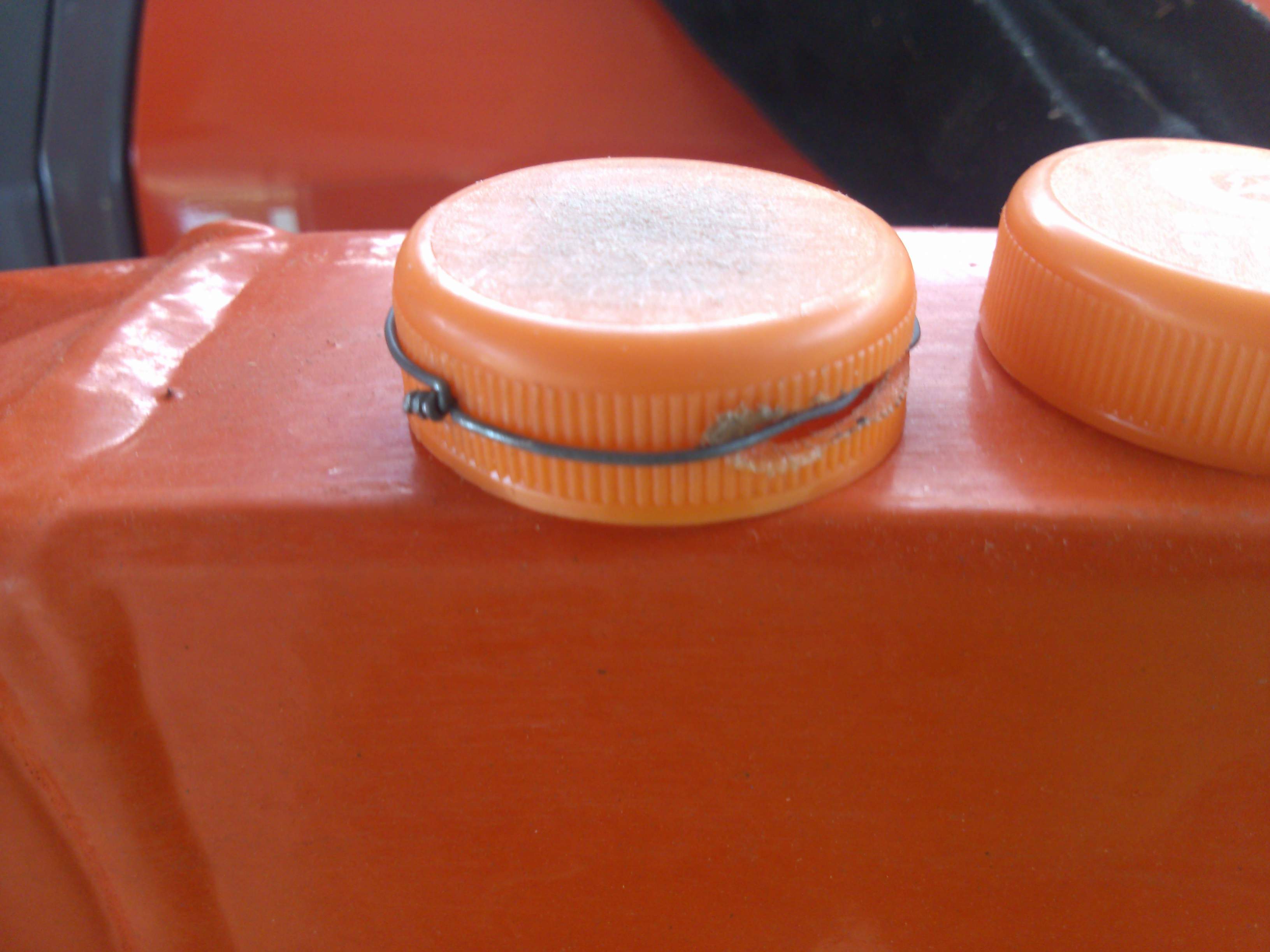

Here is another idea, using a Gatorade lid, one from the small size bottle, fits almost perfect and is orange too.
The Gatorade lids are flexible plastic and I made a way of making it snug fit, just cut a slot on either side and used some wire to act as a tension for a snug fit.
