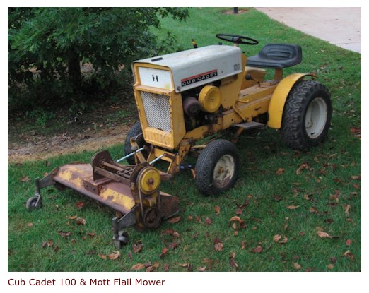

Something like this old thing? :)
High Ridge Tractor Parts
More photos here:
What is a flail mower best used for? - General IH - Red Power Magazine Community
I doubt a flail mower would replace a center deck on a riding mower due to low clearance issues. Out front was once more common than now, as the photos show.

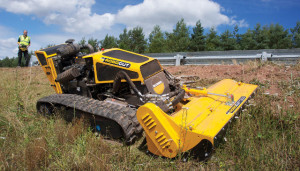

I would if I knew I wouldn't kill myself or had access to some solidworks to know how think to make things to prevent death and my limbs being cut off.

google keywords...
RC fail mower
or
remote control fail mower
you will come up with at least 20 different machines mostly manufactured. then knock off's of DIY'ers. errr maybe other way around to!
