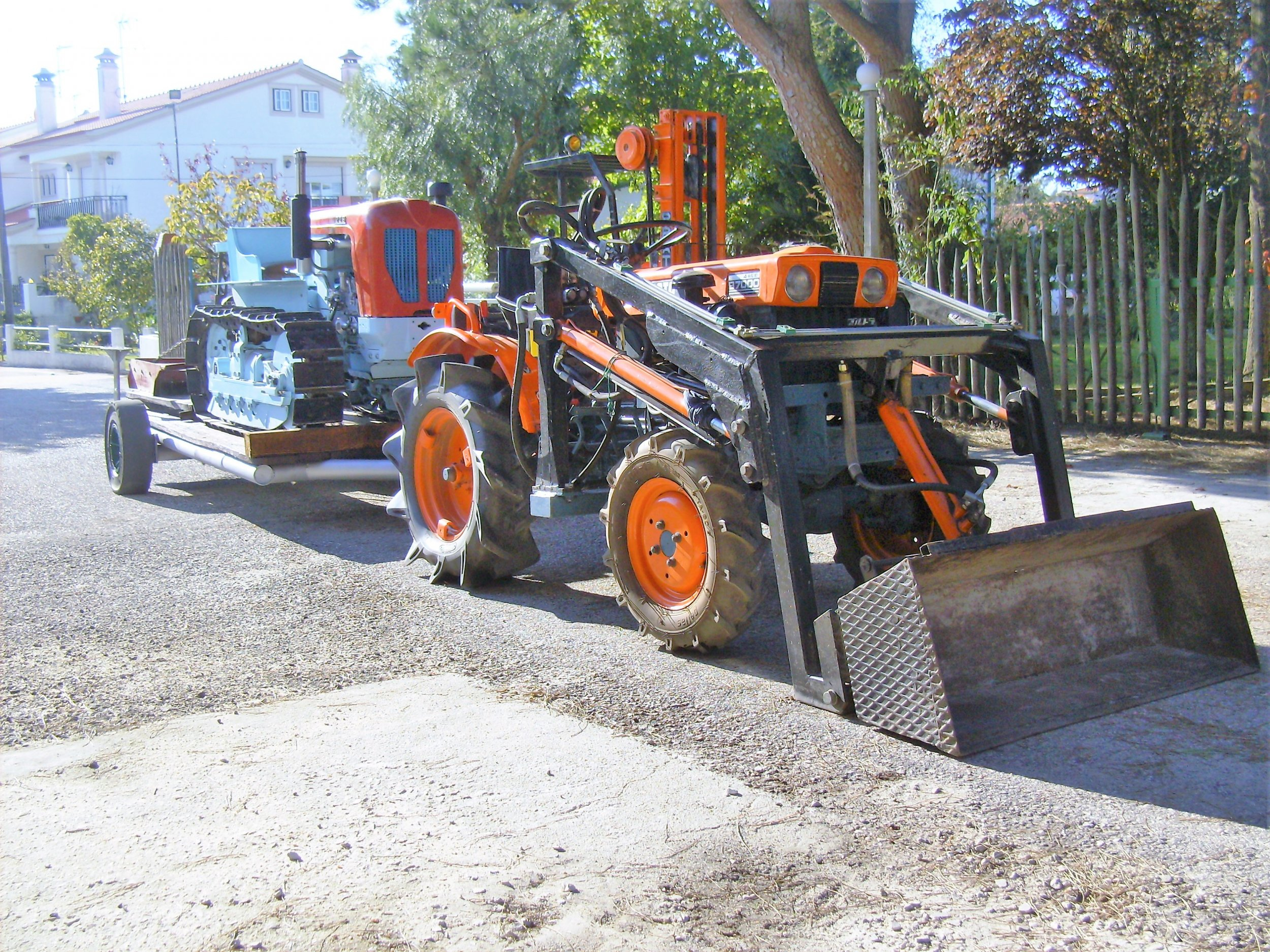

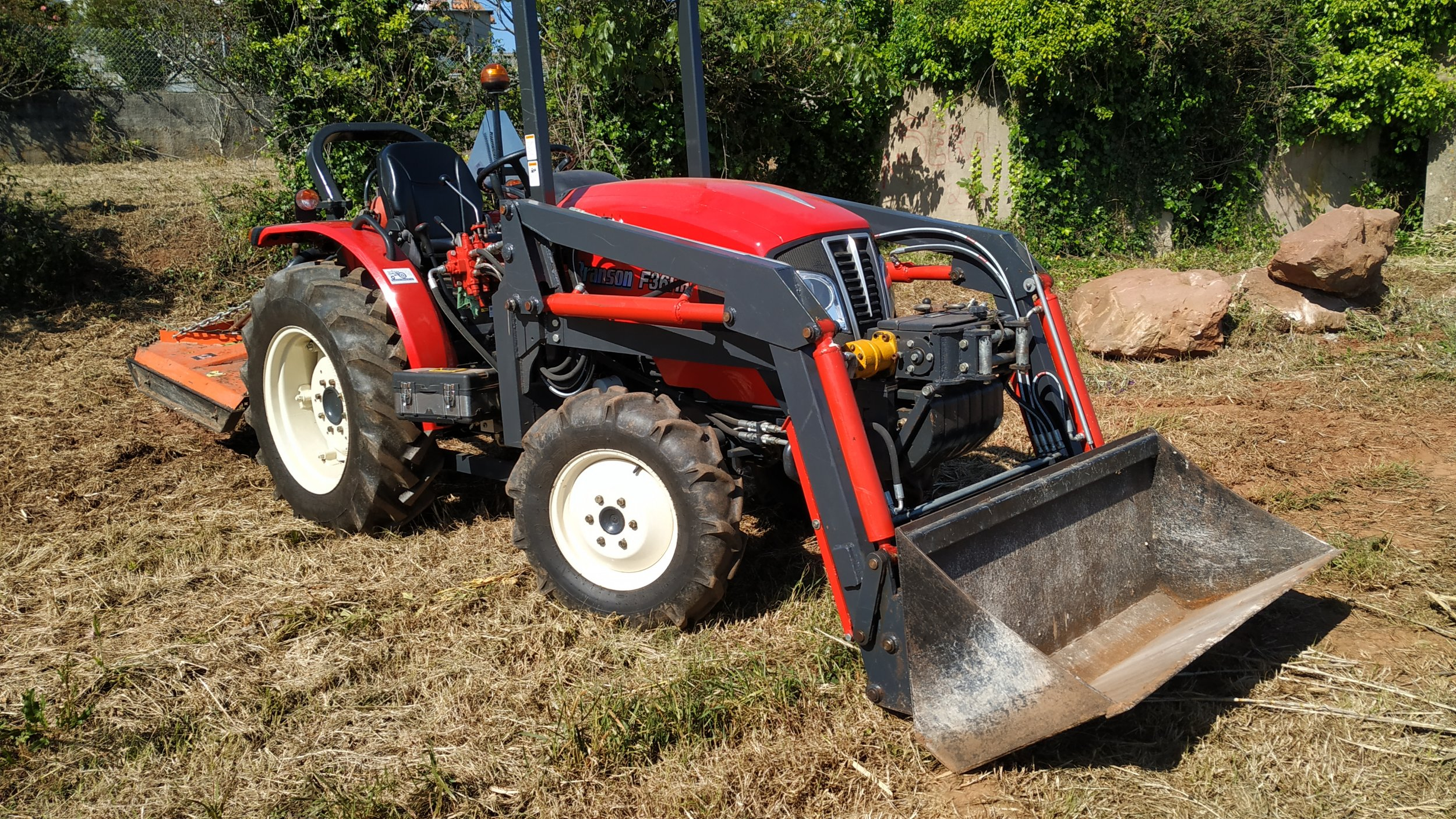

I've made two loaders so far. One for a Kubota B7000 and another for the Branson I currently have.
The one for the Kubota, was made maybe 15 years ago? It was very basic, with no quick attach for either the attachments or the loader itself. That was kind of a mistake as there are instances that the loader is just better off the tractor. This one, I bought some used cylinders from the scrapyard, along with some of the steel. I had very limited tooling and experience, so it didn't came out very pretty but worked very well.
The one for the Branson, has Euro quick attach for the attachments, quick attach for the loader it self (takes less than 5 minutes to take off or put on). On this, I also built the cylinders myself, which only added to the fun of making it. I had most of the steel needed but ended up buying some more metal for the bucket and other random stuff. I have a thread about it here: Homemade loader for Branson tractor

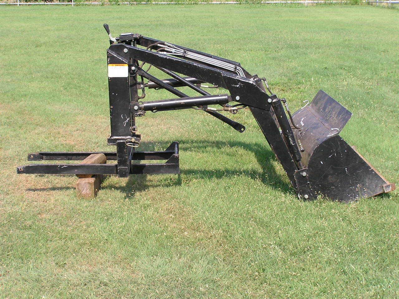

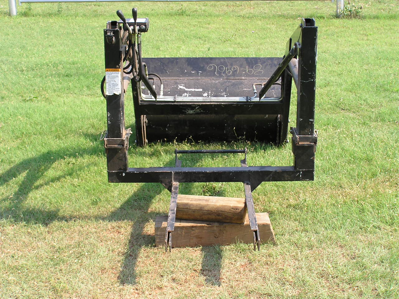

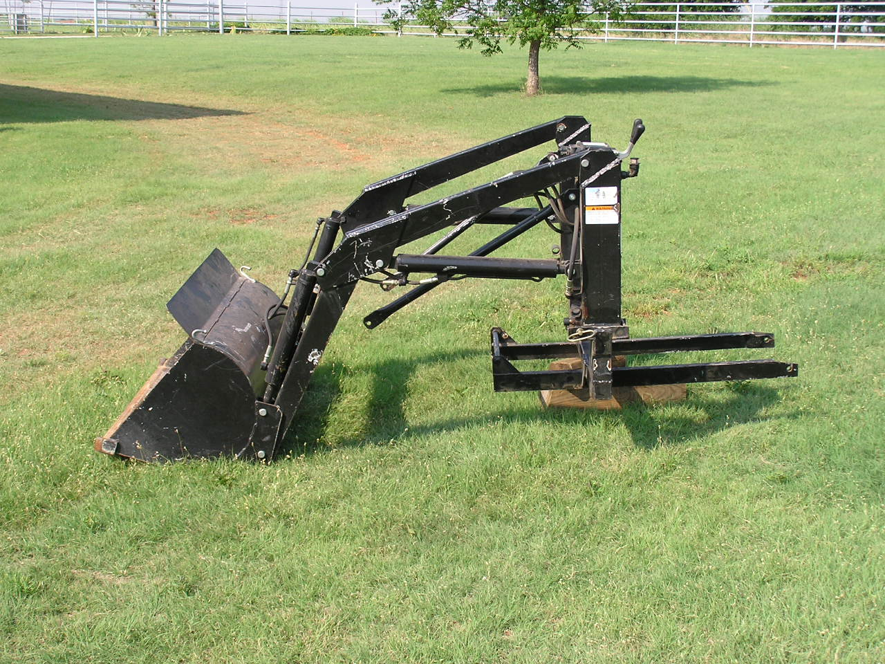

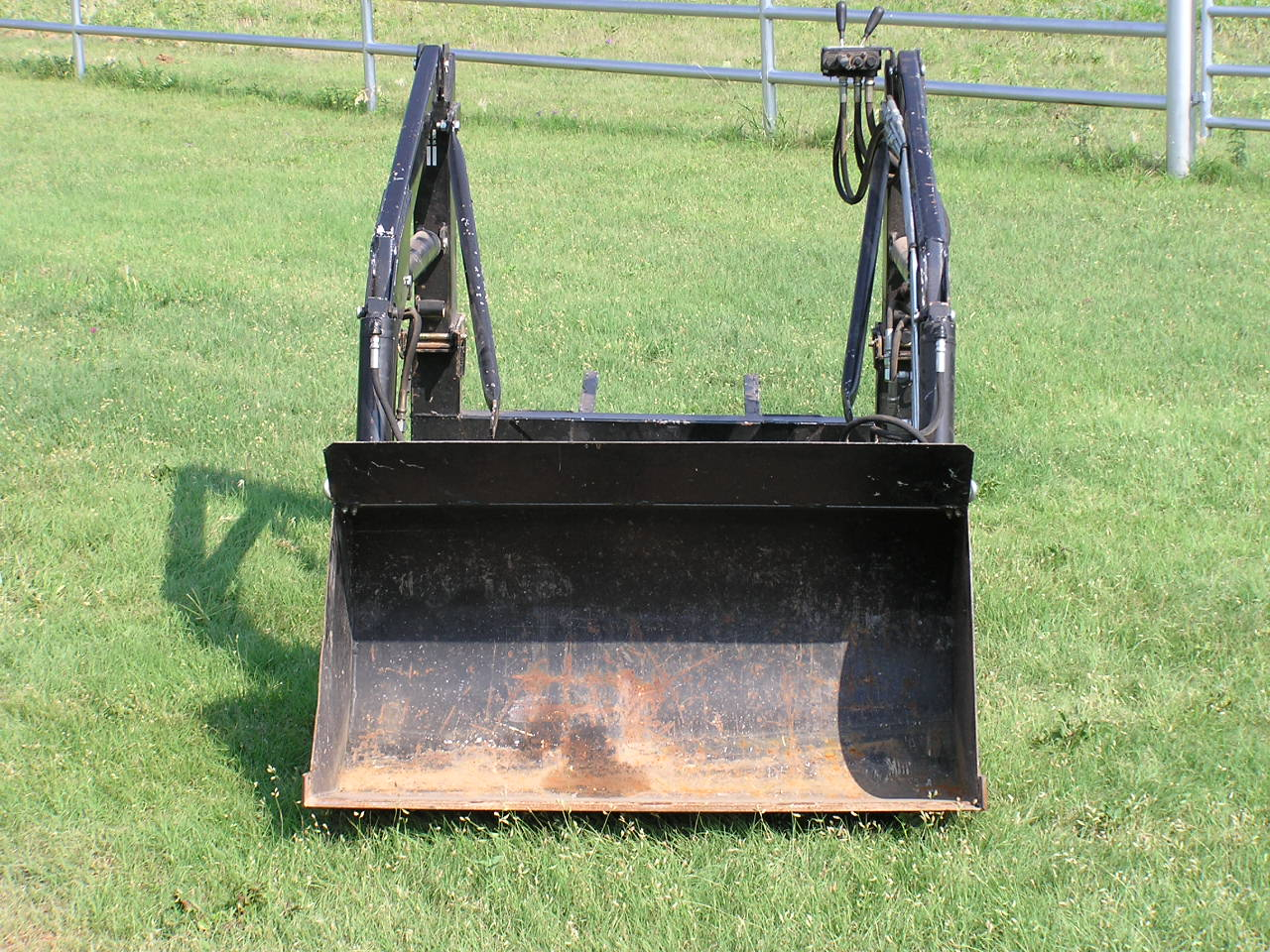

   / DIY FEL #9
Got mine at an auction in 2005 for $650:
Bucket is 42 inches wide:
