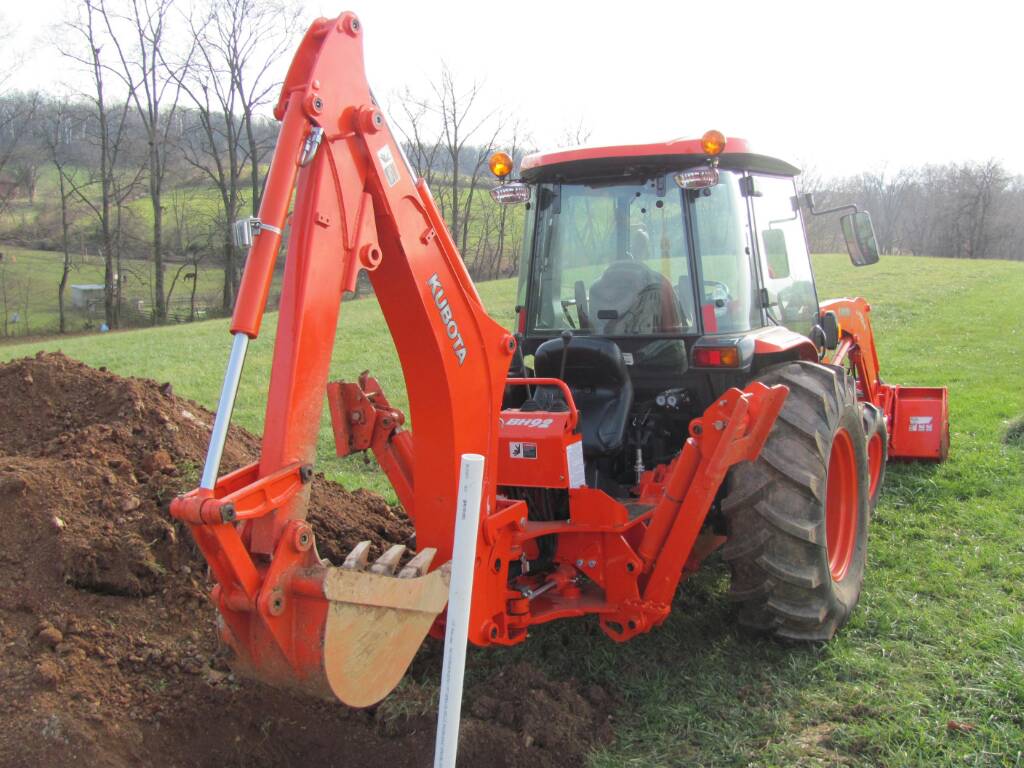

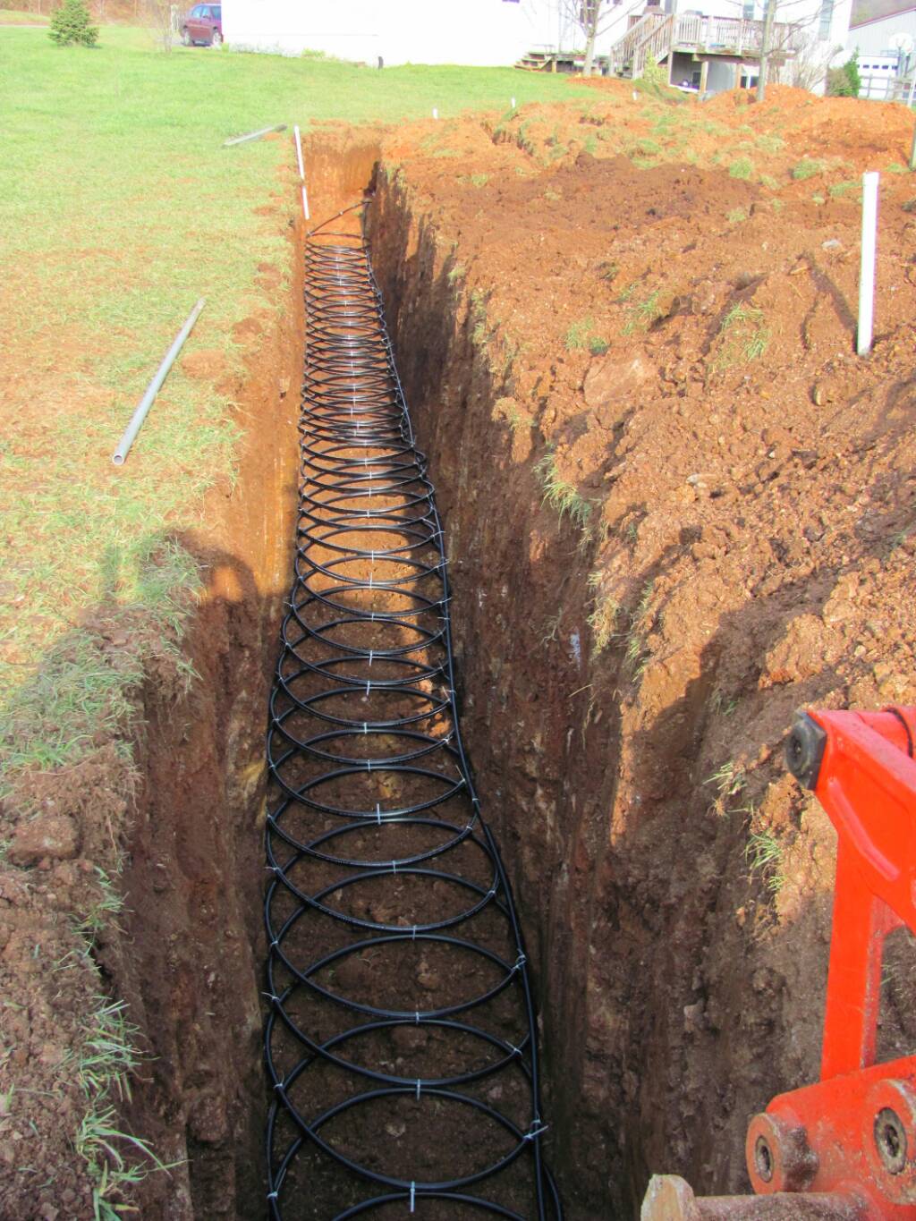

I bought my BH92 for that very reason. I dug 5 trenches 70'x3' wide for slinkies. 18" bucket. Do not remove soil first, it will make it worse. Did not take too long. Doing the geo install myself instead of "farming it out" paid for the tractor and backhoe.
   / DIY Digging trenches for Geothermal
Looks great how many ton unit did you put in? what MFG did you go with on the Geo unit?
How deep did you dig?
