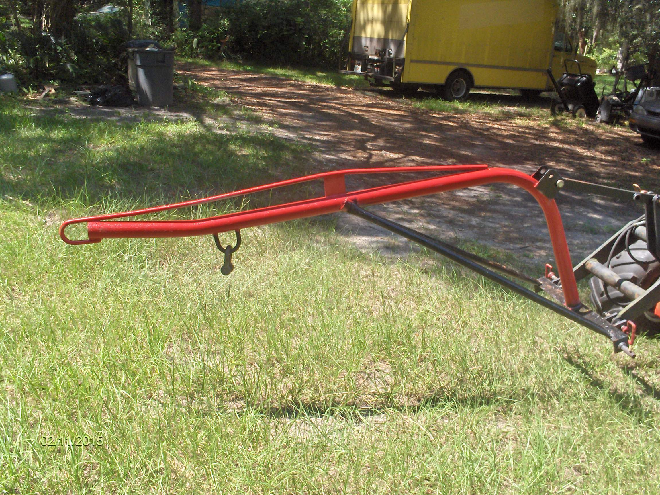

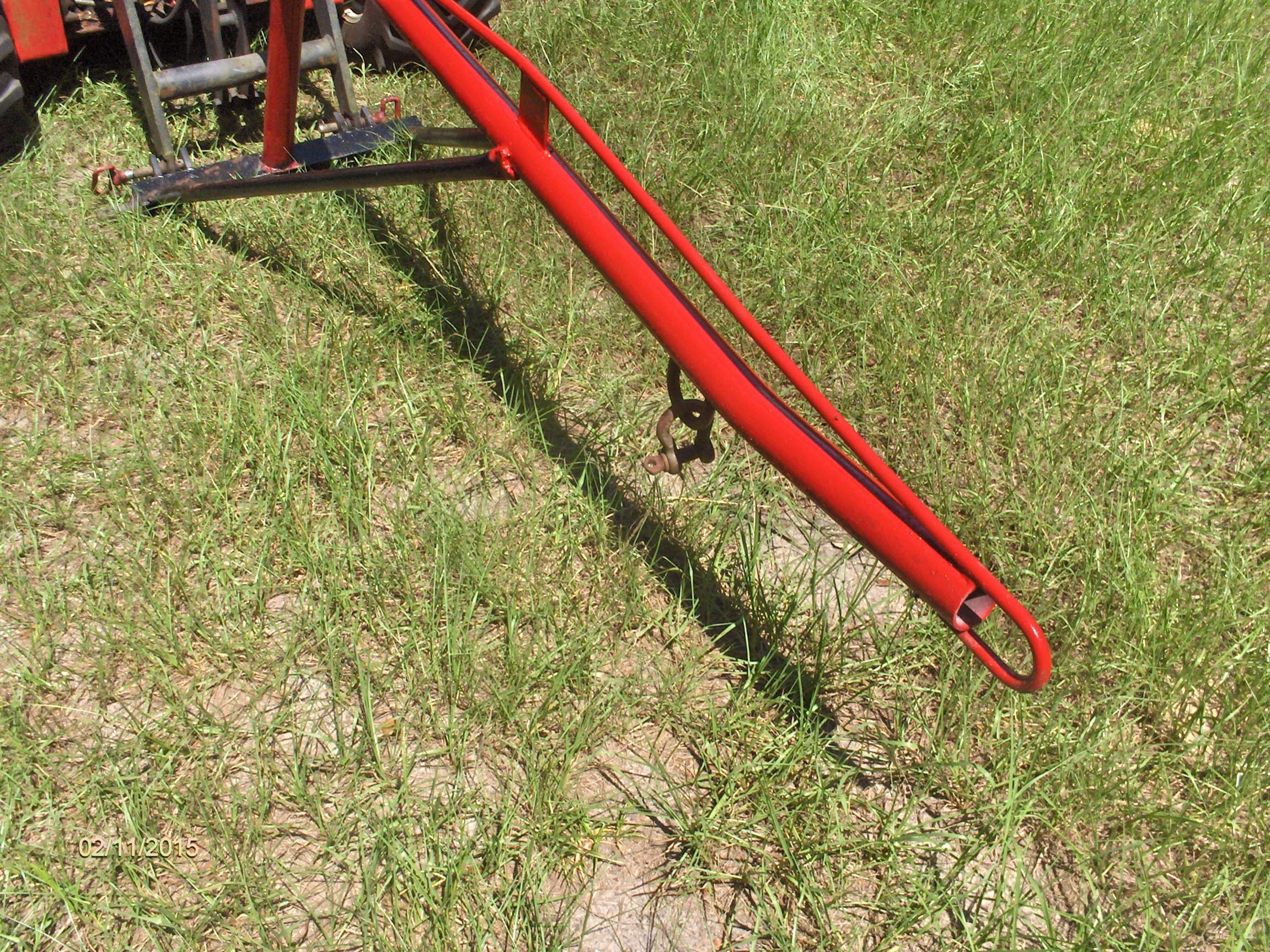

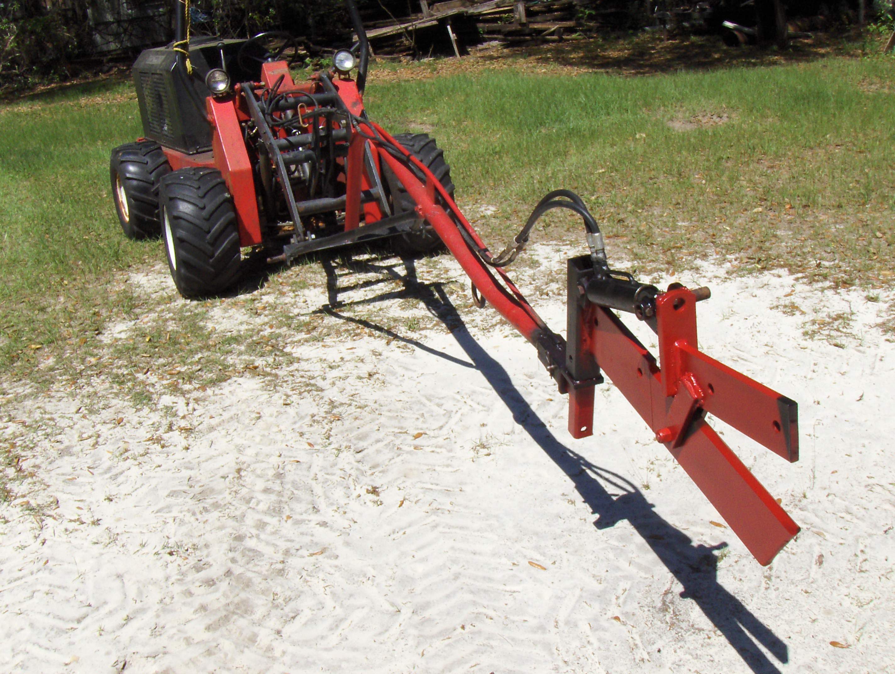

I modified the end for a small receiver tube for attachments like in the third pic.
Ha! That last one looks like a piece of equipment for the Bomb Defusing Squad! :thumbsup: :thumbsup: :thumbsup: :laughing::laughing::laughing:
Can you tell us what that is used for?!? (Besides looking like a lot of fun :) ).

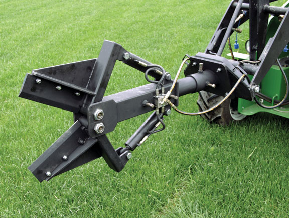

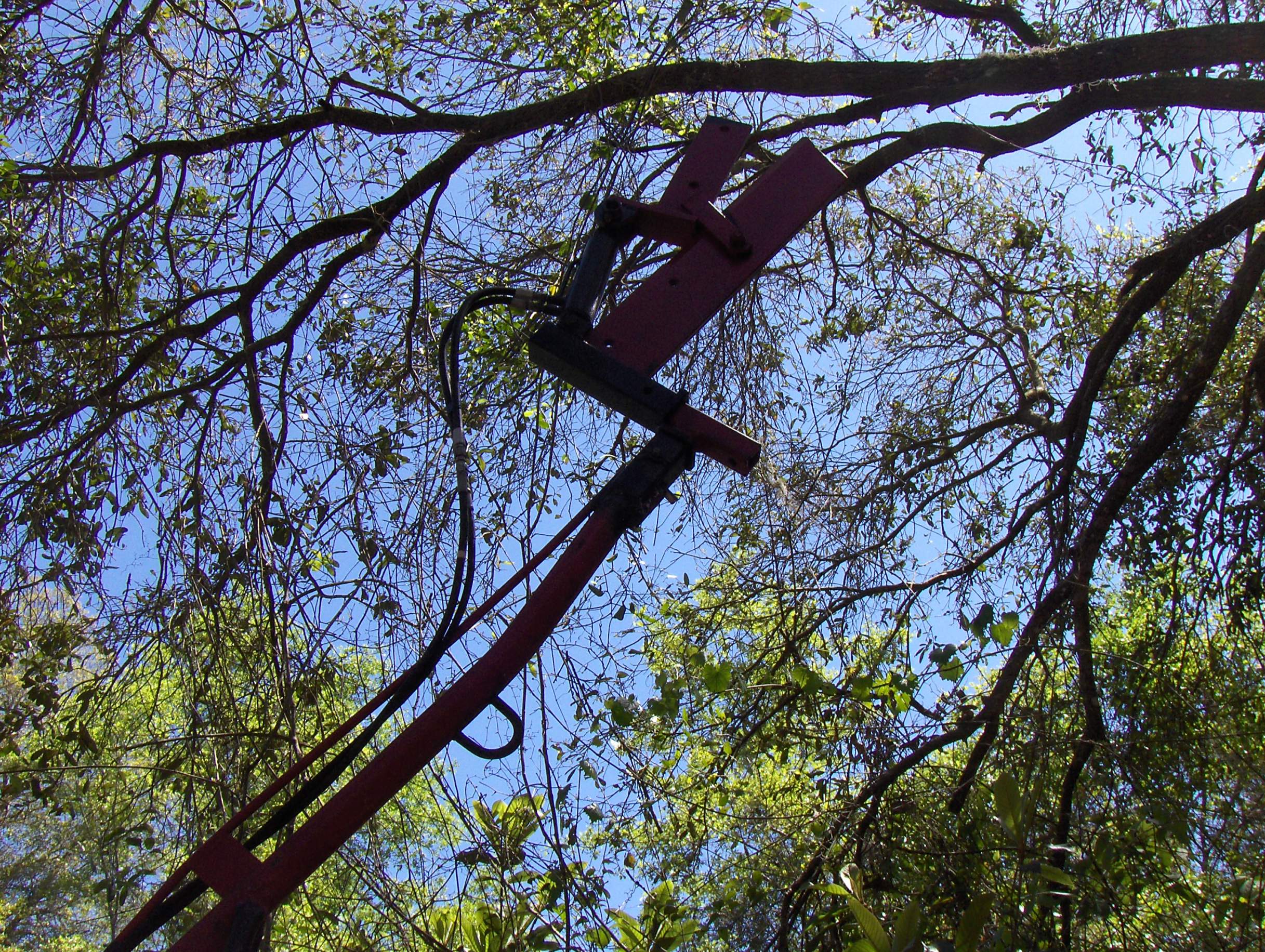

Well, the last picture above, or third pic is a tree limb cutter, or root cutter, or whatever you want to cut.
It can turn side ways, upside down. vertical, etc.
It could pinch the head off a gator or snake.
Second picture is a limb cutter made by Power-Trac

I have a suggestion for you, and this is similar to rear tractor boom poles.
Weld a 6 in extension on top of the connection point. and weld some rebar from the start of the boom, across the extension, to the end of the boom.
No holes in boom unless at the end, to late.
Weakest point is at the holes in boom.
Connecting points for the boom can be anywhere along the boom, the closer you have the lifted object the more weight you can lift.
Similar to this.
