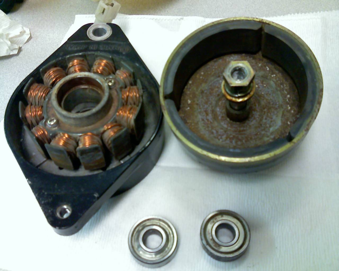

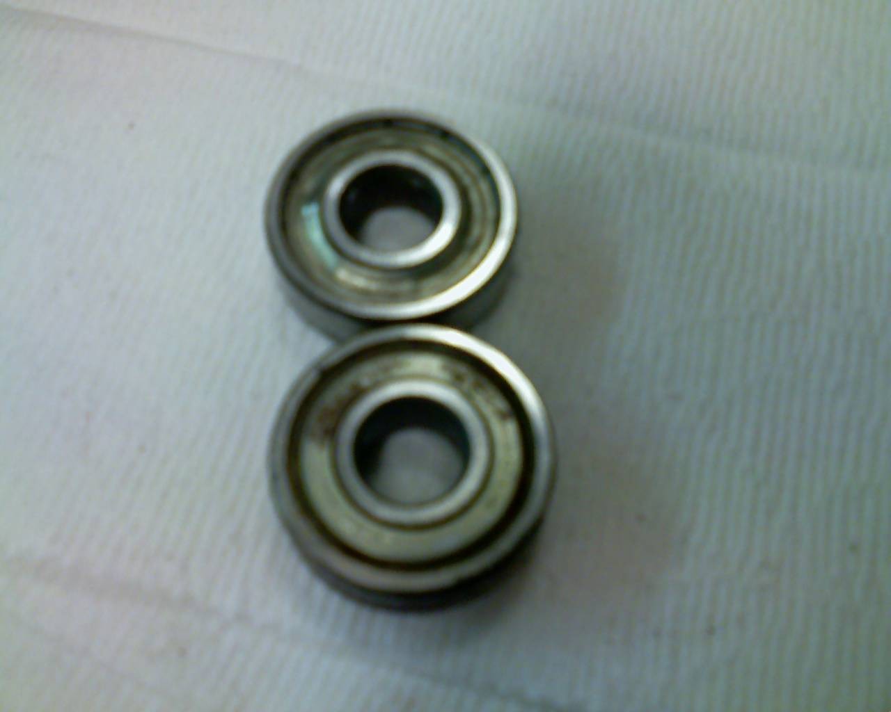

As per my previous post "Noisy Dynamo" I found out that the bearings were Loose/Dry on my F22D's dynamo causing the magnetic cap to vibrate and touch the Coil side of the dynamo making a chattering noise and eventually cause it to fail. The coil looks pretty stout so I doubt it would ever break unless it was completely rusted through. The wearable parts are the bearings themselves and thats what causes most of the Dynamo failiures. I believe in most cases just opening the case cleaning it out and replacing the bearings should take care of the issue.
1. Remove Dynamo and split case apart by removing the bolt from the rear of case and pounding out the shaft carefulley so you dont damage the threads on the screw. You wont believe how much dirt/grime/dust is in there :eek:
2. Remove bearings by pounding them out carefully.
3. Part number for the bearings is NSK 6201Z, about $2.50 each on the web. I ordered mine from VBX and got the 6201ZZ which superceeds the 6201z and is rated for 10000RPM's.
4. Replace bearings, put dynamo back together and install in tractor. Smile and be thankfull you didnt have to pay $300.00 for a new one :D
-Joe

I guess I was fortunate:D I used a 1/2" socket extension placed over the inner part of the bearing and just banged on it with a hunk of brass I had laying around:D . I was at work and those were the only tools we had in our cubicle:D . The top bearing thats on the coil assy came out really easy, its the one thats in the bottom on the case that is a pain and took some persuasion.;) I guess mine was not as rusty. Ernie, I also found out that Napa can send out the Dynamo for rebuild locally in portland to a place called Faulkners. I never got a chance to ask how much the cost would be. Just an FYI.
